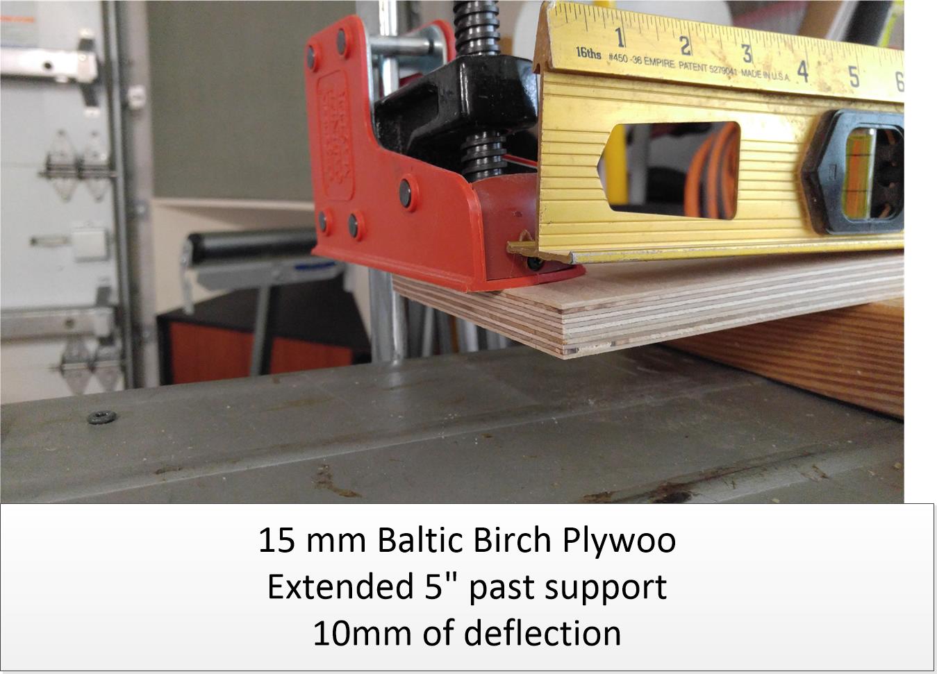

bendability of BB
A quick experiment:
I don't have a curved form so I measured deflection. I clamped down one end of 15 mm scrap of baltic birch on top of a 2x4 and pulled the other end down with another clamp.
I could have gone further, the wood wasn't showing signs of stress but this is as far as I would need to go in my wildest imaginings and probably twice as far as needed for a 2.5" driver. My only concern was how much force was required; I could not have bent it that far by hand.

Oh my, I buy BB because it won't bed Lol

Yay! 5'x5' is always available, but 4'x8' can be tough to find...
I was worried because plywood is said to be harder to bend than MDF but apparently its bendable enough.
As long as you have enough foam behind each driver to not bend the frames to conform with the bent baffle (and still have a good air seal), you won't have dragging voice coils...I bought a sheet of 1/4" furniture grade birch face plywood today.

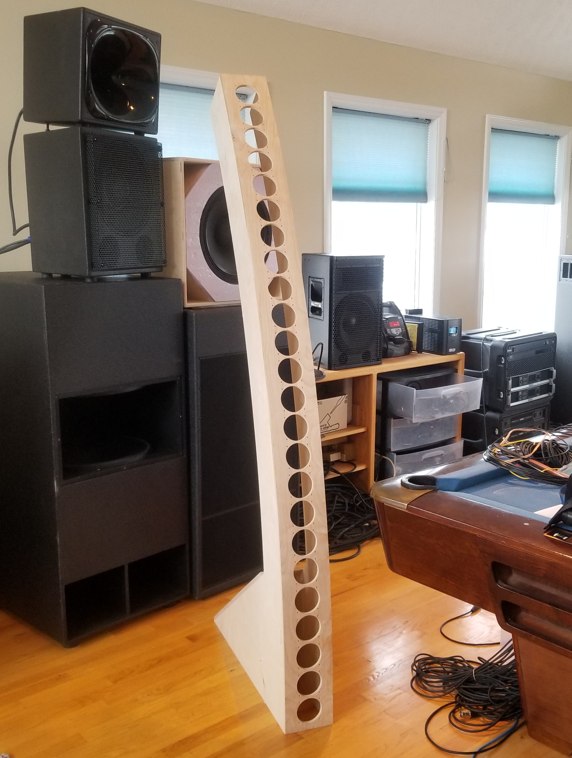

Art, the small arc per driver isn't intuitive I think....
the CBT's 36 degree arc leans back a full 2 feet at the top with a 7ft tall array.
But the arc height spanned by each of the small drivers is next to nothing.
The biggest reason for this project is to play with what's in this paper..

Ok, a dual CBT / straight-line 'Murphy corner' project is underway.
CBT boxes are about ready to assemble; the straight-lines aren't far behind.
Both use the same removable driver baffles with 24 TC9's.
So I can only run one setup at a time (in stereo that is)
Finally settled in on wiring 6 groups of 4 drivers.
Hopefully, that should accommodate shading for the CBT, and delay/shading for straight-line steering experiments.
It will also allow all drivers to be run off 1 channel for 5+ohm load in "corner mode" 😉
