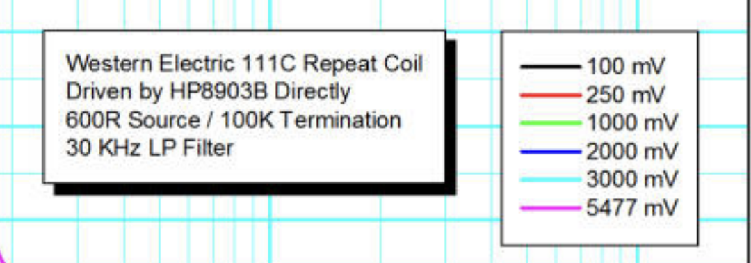

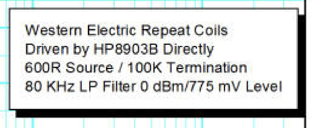

That is the same document I linked in the previous page. I do see where they say the 200V P-P thing but I was under the impression that they used much less power in the actual tests. Here is the legend for each graph. Do those values correspond with what you're saying?
Looks like the first test was across the entire frequency spectrum and the second was only looking at 30hz (says there was a low pass filter applied). Makes sense since that's the frequency for which the max rating is specified.

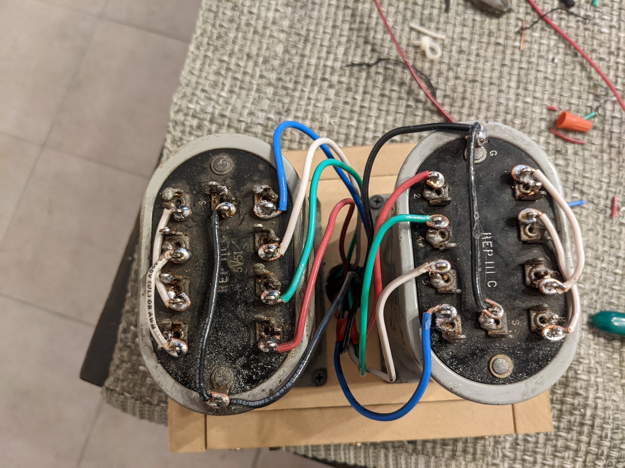

When I say cold I mean pin 3, not ground. I already have all the XLR grounds tied to the 111C ground. I'm talking about pin 3. Pin 3 of the Xlr going into the 111C wont be connected, but the one going out of the 111c into the pad/interface will be. Hope I'm making sense

An XLR input to a device needs to have a signal between Pin 2 and Pin 3. The secondary of your 111C should be connected between Pin2 and Pin 3. Ground should be connected to the ground lug. If you use a pad, the pad should be a balanced configuration, and its outputs connected to Pin 2 and Pin 3. If you omit, or ground Pin 3 you have eliminated any and all advantages of a balanced input. If you are driving that input from a transformer, and you don't connect Pin 3, but instead, ground one side of the output winding, it will work but you've now created an unbalanced circuit. No idea why you'd do that when a transformer is by nature a balance source.
Note that IF the input to your device is a transformer input, you must either connect the signal between Pin 2 and Pin 3, or from Pin 2 to Ground AND ground Pin 3. It won't work otherwise.
The output of your amp should be connected, through the resistor, to the primary of the transformer. The output appears between the red and black terminals, or if you use the amp in bridged mode, between the two red terminals.

Currently everything is wired in the proper balanced configuration. The pads as well. My question was where does the negative from the amp go - to terminal 7 of the transformer (where pin 3 of the XLR input is connected), or to the ground of the transformer. Both pin 2 and 3 carry an audio signal from the interface, only one is inverted, but the negative output of the amp is just a ground, no? If it is a ground, then shouldnt that go to the ground of the transformer?
This whole time I have had no idea what terminals on the 111C are the primary and which are the secondary. All I can see on the document is "line" and "drop." That has really been making things confusing to me. I'm gonna try and figure it out.
I wired this thing based on a configuration I got from the headspace forum.
**Ok I think I just learned something. A transformer can create a balanced signal from an unbalanced signal? That explains my confusion. I was looking over Marcels schematic and was wondering why the negative of the amp would where the "cold" wire of the XLR input went.

So should I rewire the transformers like Marcel has them? Id still be using just the 560ohm resistors for now..
Yes, use his schematic.
Primary and secondary are somewhat arbitrary. Usually the "primary" is the winding to which you apply signal. The "secondary" is the winding from which you extract the signal. But they are reversible. Transformers are all completely bi-directional, and the 1:1 units like the 111C are fully reversible with no change in performance at all.
