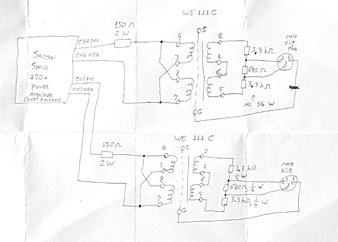

You could have googled 111C and found the actual connection data.This whole time I have had no idea what terminals on the 111C are the primary and which are the secondary. All I can see on the document is "line" and "drop." That has really been making things confusing to me. I'm gonna try and figure it out.
I wired this thing based on a configuration I got from the headspace forum.
Correct.Currently everything is wired in the proper balanced configuration. The pads as well. My question was where does the negative from the amp go - to terminal 7 of the transformer (where pin 3 of the XLR input is connected), or to the ground of the transformer. Both pin 2 and 3 carry an audio signal from the interface, only one is inverted,
No. Ignore the fact that the amp uses one termal as "ground". Connect the red to one input terminal and the black to the other.but the negative output of the amp is just a ground, no? If it is a ground, then shouldnt that go to the ground of the transformer?

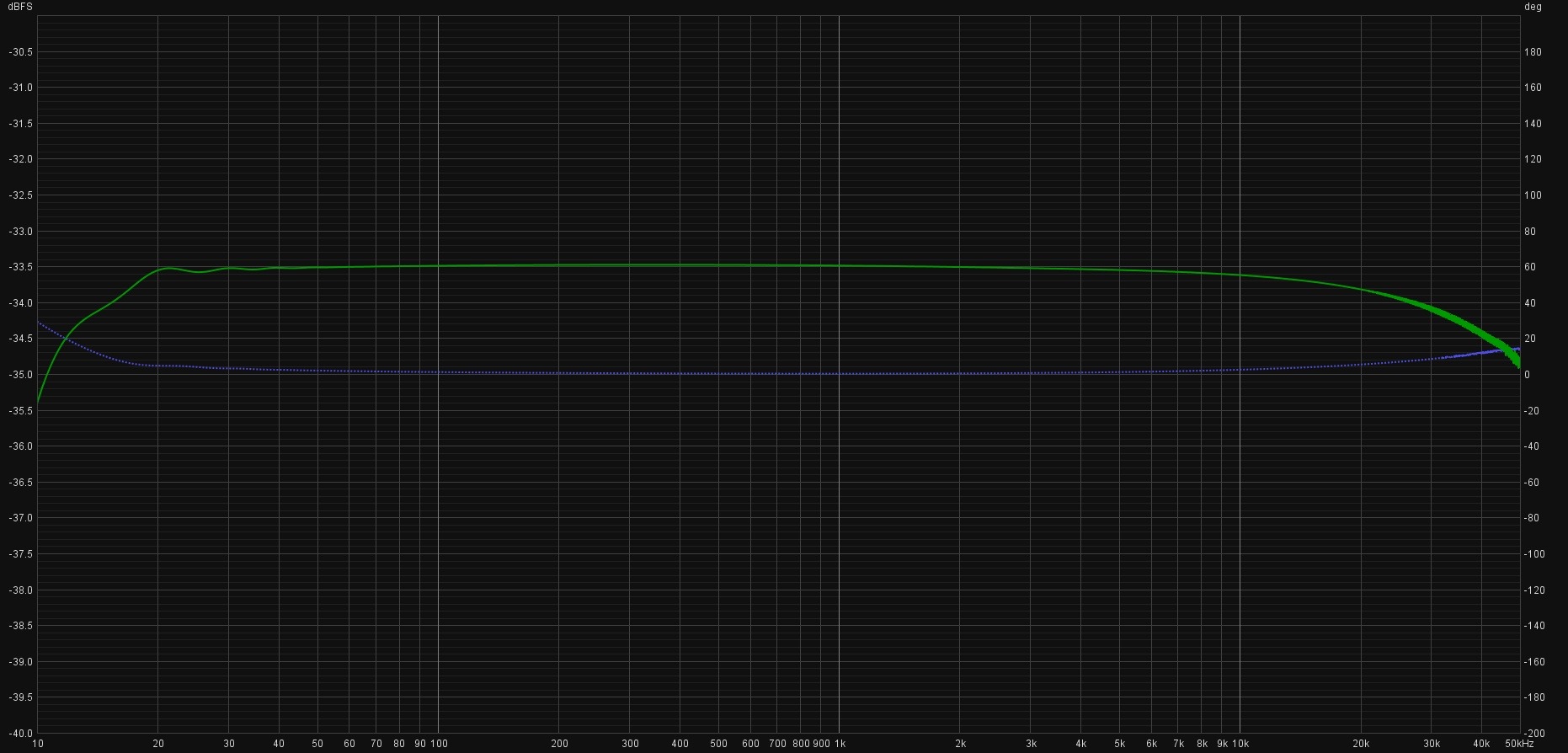

Here's a few measurements of a 111C. It was driven from a power amp capable of 48Vrms/+35.8dBu, through a 600 ohm build-out resistor, and the secondary was terminated by a 600 ohm resistor.
First, frequency response measured to 50KHz (phase shown in blue):
As you can see, it's down .3dB at 20KHz, .6dB at 30KHz. In other words, no audible "rounding" off of high frequency response.

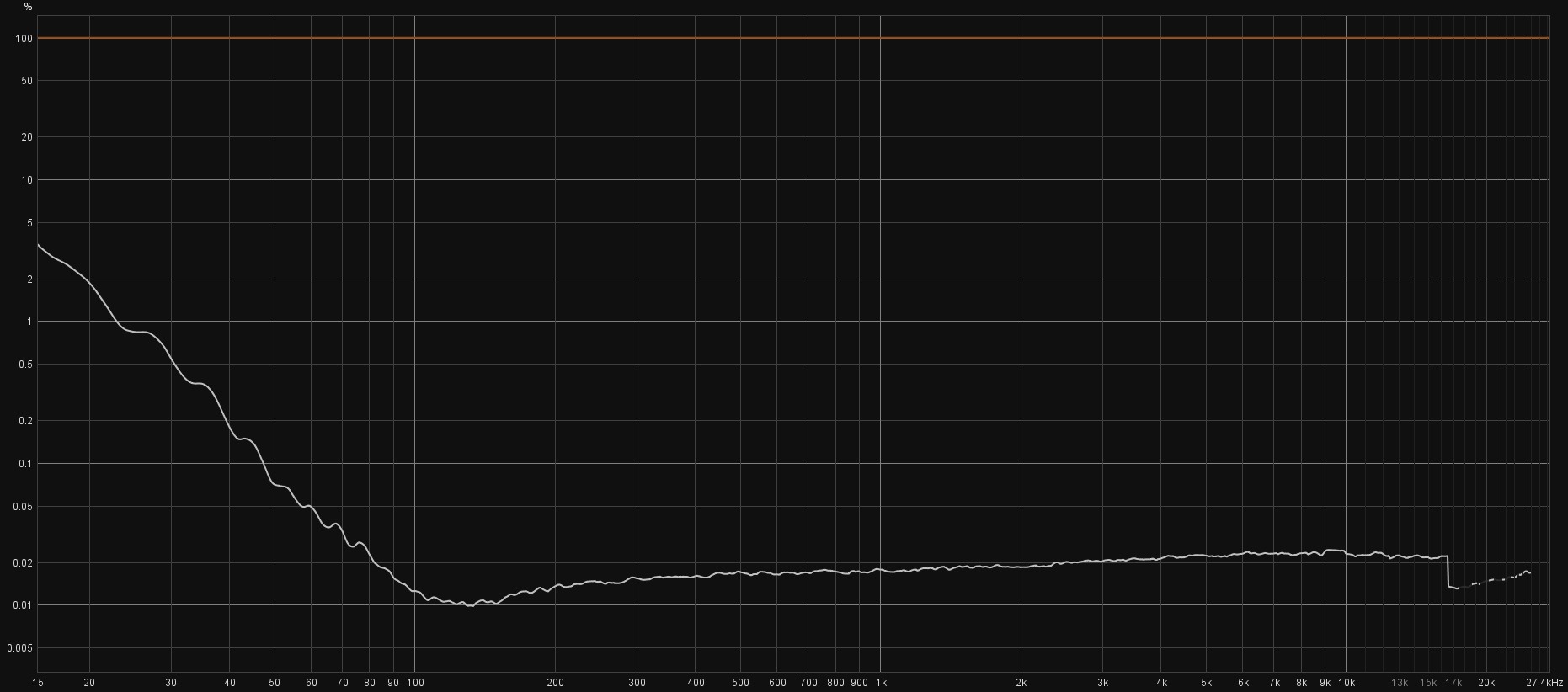

Now for some distortion. This plot was made at just a tad under +36 (as applied to the total system including resistors):
The only audible "color" (distortion) occurs below 40Hz at this rather high level, and frankly, it remains in the questionably audible level until around 20Hz. The rest of the spectrum is remarkably clean.

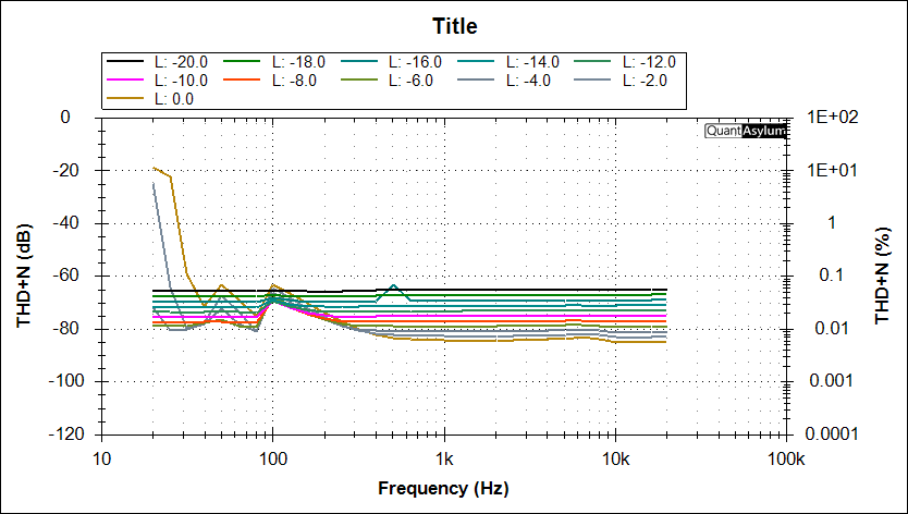

Lastly, stepped distortion vs frequency. Each run was made by increasing the drive 2dB. Overall distortion seems to go down with increasing level because this system looks at THD+N (noise), so actual THD doesn't change much, but the signal to noise ratio increases as the drive signal goes up. Also, the "0.0" plot in this set is at +35.8dBu, so the distortion max loosk a little higher at 20Hz. However, it remains in the inaudible range for the rest of the spectrum. Also, the distortion vs frequency curves are somewhat different in this measurement system due mostly do different FFT parameters. I didn't take the time to match the systems to each other this time, sorry.
While it is possible to measure different source Z and load Z combinations, given these results it didn't seem worth the effort. I did try one distortion set with no build-out resistor (driving from very low Z) and a bridging load. Distortion at 20Hz went down slightly, not remarkably. Unfortunately I mistakenly failed to save the data.
For reference, the graphs with the black background were made with REW using the QA401 interface. The white background distortion series is the QA401 system and software. In this graph the QA401 output is shown directly in dBV, but there is a large 1000W power amp between it and the 111C, along with the built-in pad, plus an additional 10dB pad to protect the interface from damage from over-voltage (probably unnecessary but I hate blowing stuff up accidentally). In the full test system, QA401 0dBV = +35.8dBu/48Vrms.

Very cool and impressive. Although you did show in one of the graphs that there is a high frequency rolloff of the 111C that appears to begin at 5k. However it doesn't sound like that is a function of level but rather the natural frequency response of the unit. It's down 10db by the time it gets to 20k. That would no doubt sound like you put a high shelf filter on the signal, no? Which also could provide a "rounding" affect in my opinion. I wonder if that's what people hear.Here's a few measurements of a 111C. It was driven from a power amp capable of 48Vrms/+35.8dBu, through a 600 ohm build-out resistor, and the secondary was terminated by a 600 ohm resistor.

Hey. So I have to rewire my 111C to match the first schematic you drew, but so far I only got the 560ohm resistors that jaddie originally suggested, that will go between the amp and the 111C. Do you know how much max level that will end up putting into the 111C? I tried to do the calculations myself and got something like 26dbu, but that is not considering whatever happens between the 111c and the interface it goes back into. I.e. what the effect of the -30db pad and the 10k ohm input resistance value will do. I'm talking about without any of the resistors on the back half of the circuit. Just the 560s on the front.With the same voltage level at the amplifier output or the same voltage level at the transformer input?

Regarding post #166: about 22 dBu on the secondary side, neglecting transformer losses and the fact that the amplifier will produce a bit more voltage at light load.
With the primaries in parallel and the secondaries in series, you have a 1:2 transformer. The impedance goes with the square of the turns ratio (because when you transform the voltage up, you transform the current down and the other way around). Hence, the 1010 ohm of the loaded attenuator ideally becomes 252.5 ohm on the primary side.
The RMS voltage at the primary is then the RMS voltage coming out of the amplifier, sqrt(4 ohm*60 W), times 252.5 ohm/(252.5 ohm + 560 ohm); that is the standard voltage divider equation. It's 4.8144 V.
You get twice that at the secondary, so 9.6288 V.
Expressed in dBu, that becomes +21.89 dBu.
So wired exactly as you have it, I will only get +21.89?? Lol. That's less than what I am currently sending to it with the SSL! Sigh. I thought the power amp solution was gonna be easy. Guess not. This is tempting me to just go out and find a more powerful amp and resell the Samson when it gets here.Regarding post #166: about 22 dBu on the secondary side, neglecting transformer losses and the fact that the amplifier will produce a bit more voltage at light load.
Yes, with a too high resistance on the primary side and a too low resistance attenuator on the secondary side.

No I didn’t. Look again.Very cool and impressive. Although you did show in one of the graphs that there is a high frequency rolloff of the 111C that appears to begin at 5k.
Not at all. I posted the value for 20KHz. Did you read what I wrote even if you can’t read the graph?However it doesn't sound like that is a function of level but rather the natural frequency response of the unit. It's down 10db by the time it gets to 20k.
It’s nothing like a shelf response. It’s a roll off response, just no in the audio band. I shelf is an initial rolloff then a flattening. Wow we have some work to do here.That would no doubt sound like you put a high shelf filter on the signal, no?
Argh. There’s nothing in the graph that is audible to anyone.Which also could provide a "rounding" affect in my opinion. I wonder if that's what people hear.
No, LUFS won’t show you any difference at all, and would be completely dependent on settings elsewhere in the system, including power amp input gain.I want to run some LUFS numbers with music when I get my unit set back up. Most interested in peak to loudness and range measurements.
Dynamics cannot be changed by a linear device.I do know that in the original files I null tested, the dynamics of the 111C version were slightly lower, which would indicate that there is some truncation of peaks.
Response scale is on the left, phase scale is at the right. I’m so sorry I posted the phase plot, it confused you.@jaddie wait I didn't see that the frequency response graph had different values on each side of the Y axis. I was looking at the right side not the left.

How does this part list look?Assuming you don't need an RC network, the schematic would be like this. I included attenuators to get the output level back to something reasonable.
