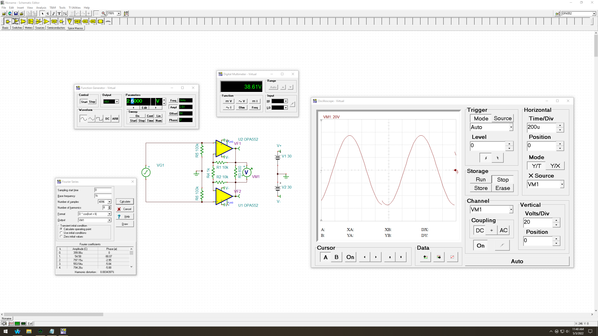

@MarcelvdG If I got an amp that was say 300w per channel at 8 ohms (max), would turning the input sensitivity down suffice to ensure that too much voltage wasnt sent to the transformer? Or does it not work like that?
I think the first things you are likely to damage are the ceramic composition resistor and the primary winding of the transformer. Both should be pretty good at handling temporary overload, so as long as you don't play continuous very-low-frequency sine waves at maximum volume, they may survive.

I might have to call it. I just got a used behringer amp that puts out 150w per channel at 8ohms and the signal craps out still before the SSL. In this case though I didn't do enough research on the amp and it has a DSP onboard, and the limiter defaults to 0db threshold. I don't think the DSP is letting the signal go past whatever it has set as 0dbfs. I can't imagine this amp isnt powerful enough to put the 111c into distortion, especially with Marcels schematic applied.

Nvm all good. Kept the transformer at same schematic but removed the resistors on all the wires.
