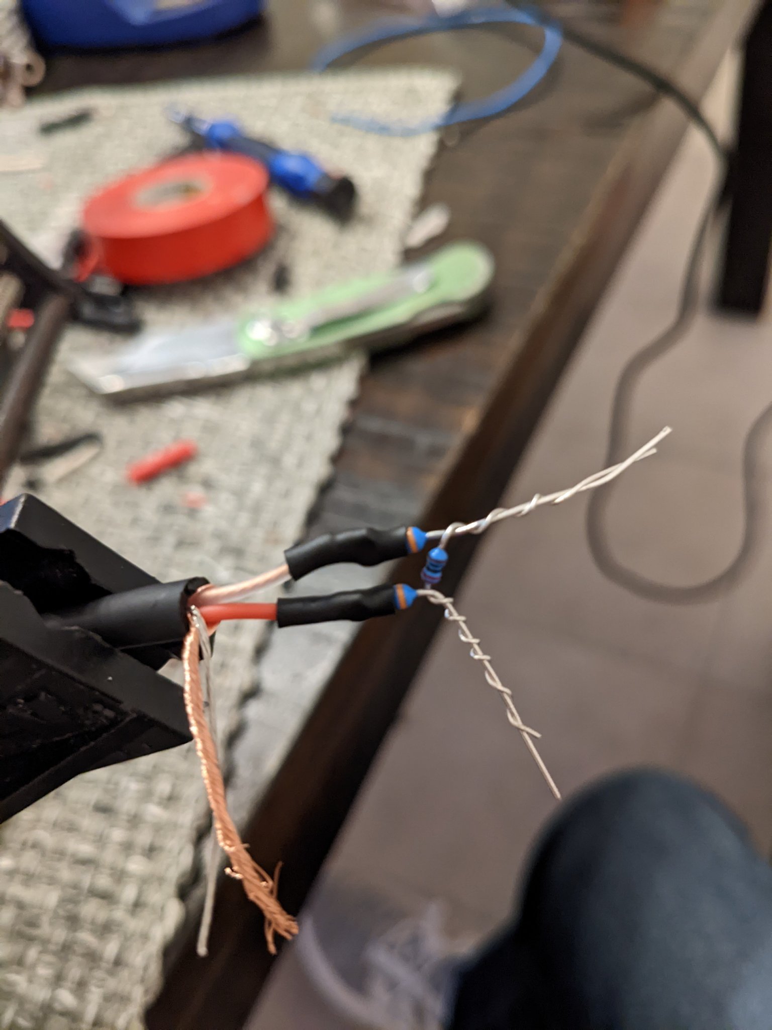

I rewired the 111C using your schematic. When the amp comes in on Tuesday I'll throw in the 560ohm resistors Jasddie originally mentioned and see what happens. If I want more, I'll order the rest of the resistors from your schematic and try that.

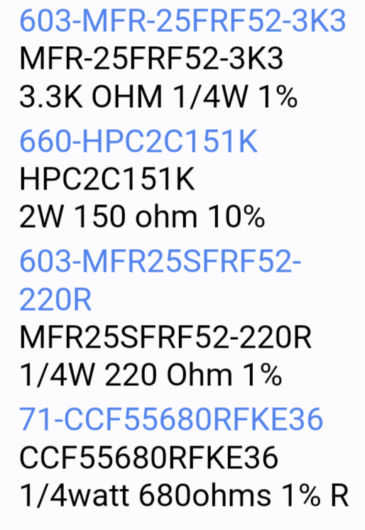

Or use 220 ohm instead of 680 ohm, then you get about 30 dB attenuation from the resistor network.

I already ordered the parts from Marcels schematic and they will be here tomorrow. I'll start by changing the 560ohm resistor that goes before the 111C to the 150ohm one.
In terms of the resistance on the backend before it goes back into the interface... I'm currently using those -30db pads that have 1000k ohm on input and 150ohm on output. If I get rid of those and put the resistor network from your schematic in there, will that change the max output of the samson? Or is it all up to the resistors on the front end?

Ok cool. I got the 220 and the 680 ohms as well in case I need more/less pad before the interface. I'll start with just swapping the front end resistors out and see what happens.It will increase the level the transformer operates at.
@MarcelvdG btw I got ceramic resistors for the front end and metal film for the back end. I hope that's correct..
I think those will work fine. You may get some extra distortion from the ceramic composition resistor, as its voltage and its temperature coefficients are relatively high.
I threw on the 150 ohm resistors only (still have the current -30db pads) but I don't think I got much more gain out of it. I should have saved the file from yesterday. I got it to about -9.1 LUFS before distortion.
Later tonight I'll solder in the pad network you drew up and see what happens.
I put the 3300ohm resistors on and it didn't allow more gain into the 111c. I think I need a more powerful amp. I'll sell the current Samson 120a and get another that can deliver more power info the 11c.
