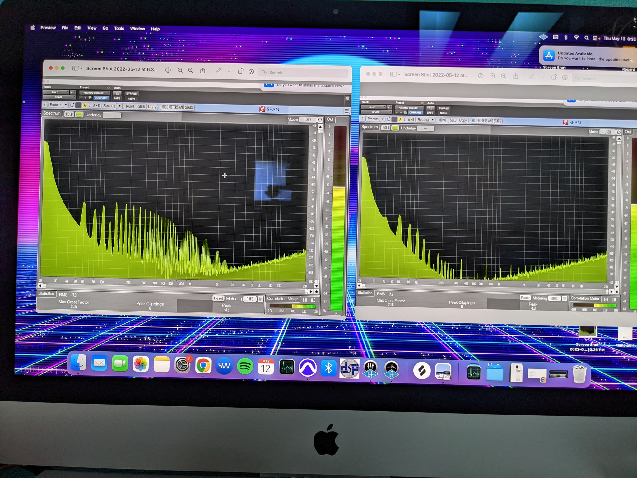

Can you hear or measure any third harmonic distortion when playing a 20 Hz sine wave at full volume? The transformer should distort to some extent now at low frequencies.
In order for me to really hear any change I have to drive the amp well past the redline, and at that point I'm pretty sure what im hearing is the amp. Hard to say.Can you hear or measure any third harmonic distortion when playing a 20 Hz sine wave at full volume? The transformer should distort to some extent now at low frequencies.
There is always some harmonics in the signal whether I drive the amp at normal levels or smash it, it's just the level of those harmonics that change with more volume. I guess those would have to be from the transformer? I would have assumed the amp would be a cleaner signal. I don't know. I need to just run the amp signal without the transformer and see what happens.

I might have to call it. I just got a used behringer amp that puts out 150w per channel at 8ohms and the signal craps out still before the SSL. In this case though I didn't do enough research on the amp and it has a DSP onboard, and the limiter defaults to 0db threshold. I don't think the DSP is letting the signal go past whatever it has set as 0dbfs. I can't imagine this amp isnt powerful enough to put the 111c into distortion, especially with Marcels schematic applied.
