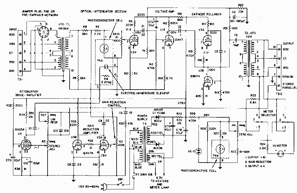

georgehifi said:
I've already sent a while back the US/European Patent offices proof that I started it (MkI) over 30 years ago
I'm pretty sure I've got references of cadumim sulphide cells used for audio amplitude control dating back to the 50's.
The earliest I can find at the moment is the Teletronix LA-2A compressor amplifier of 1965:
