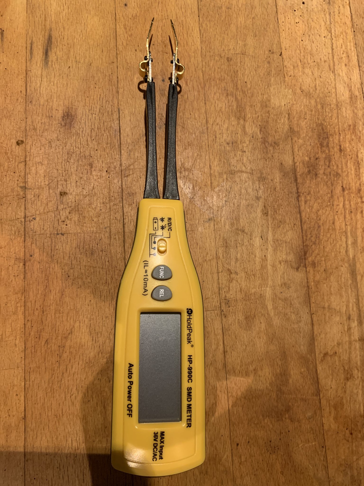

Got myself a batch of 10 non-s silonex LDR’s. I have the LED tester on the picture, but not entirely sure what it’s measuring on LED testing mode. Values for the LDR’s are around 24-25V…. Is this an appropriate unit of measurement to match LDR’s?
Edit: it’s 24-25v, not 2.5v which would be Vf

I set up a little rig to do the matching, and ordered 10 LDR's from Mouser.
Results (calculated as the % difference in R between the highest and the lowest in the quad. Some non-linearity there.
Which set to pick, or order a couple more to get a closer match?
I'm guessing A as it can be compensated better with a variable resistor.
Quad set AQuad set B
1.3mA8%5%
6.5mA6%13%
20.6mA8%8%
so when turning the volume up/down the left/right balance will shift
That's why the trimpot is there, to get a far finer/better matching of the NSL32SR2S on the scope, and if they track each other on it you'd be hard pressed to hear it.
(A cheap dual gang volume pot or phono cartridge has far worse channel ballance)
If you "think" you can hear a dB or 2, then you can build the dual mono Lightspeed Attenuator.

Did some scoping last night, indeed I do see them tracking when changing the volume.
If I calibrate the level to be equal left/right at a low volume (say 1/4 of the volume pot), when turning the volume pot to 1/2 the channel equalization goes approx 7-8% out of whack. Interestingly the channels equalize again when turning up the volume further to 3/4 and max.
7% seems significant, but not sure I would hear it (havent tested yet). My normal volumes on this preamp are between 1/4 to 1/2.
That confirms to me that you did get NSL32SR2 and not NSL32SR2S (sorted ones).
Also you'll find the "S" sorted ones give far less volume at abosulte min volume than the non "S" do as they have also a lower in impedance on average than the non "S" have for the same given mA.
BTW never leave them at full or min volume when not listening leave them at 1/2 volume or de-power them.
Cheers George

WRT Lightspeed channel balancing -> It is possible to achieve 3% or better across the entire range, I was able to get about 2%. The trick is a different and more complex trim pot arrangement, I can't say more than that.
Cheers
Terry
