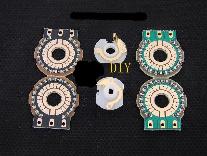

They don't make any mono stepped pots, but at those prices, just buy two and only use one section of each.
I’ve been reading info about TDK 2CP-2511/4CP-2511, there they states “Please take care not to use for setting resistance value, as, if so, we are afraid that a trouble may happen.” Therefore the question. Otherwise no problem, got it!

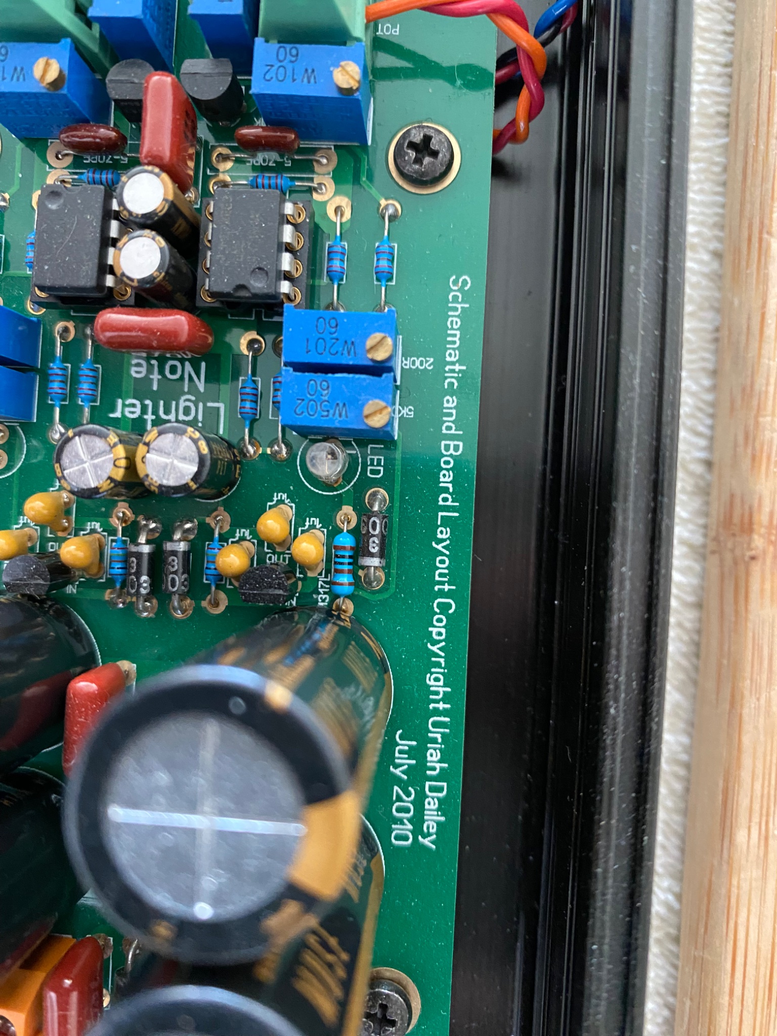

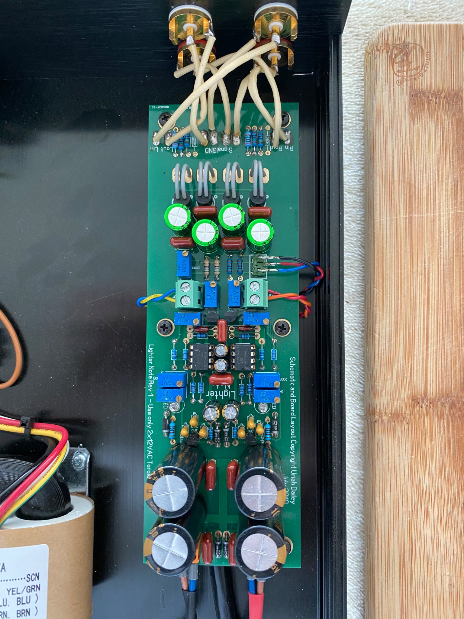

Same here… bought a set of matched LDR’s in 2011 or so. In 2012 I discovered the LDR’s weren’t matched… not sure if this was out of the box or happened later. By the way I completely forgot that I had already discovered this problem in 2012 already, even emailed Uriah about back then (no response).Hello everyone!
I bought 2 kits from Uriah 10 yers ago! First one no problem, the latter began to fail at the end of 2021, being in use from 2016. 250k dual pot to have an average of 20k input impedance, schematics as George suggests. Sometimes a channel goes full loud, i thought it was the pot so i changed but no solution and it does strange things. Maybe one or more ldrs are gone...

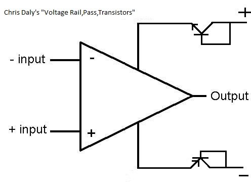

Another one was this BS opamp he sold with this transistor (what is basically now a diode) in the voltage rails
