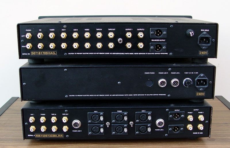

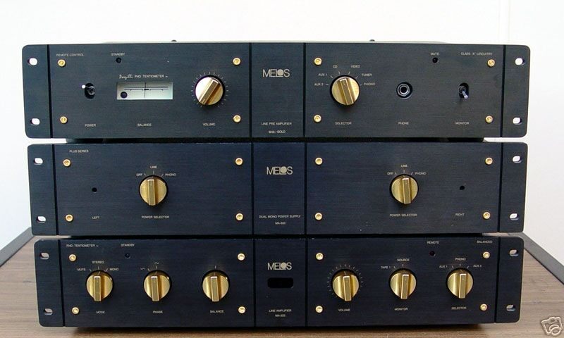

theophile said:George,
Have you seen the Melos Gold "Photentiomenter' preamp for sale at Aussie eBay?
http://cgi.ebay.com.au/MELOS-SHA-GO...yZ109837QQssPageNameZWDVWQQrdZ1QQcmdZViewItem
Yeah got my eye on it, prime candidate for a Lightspeed transplant, if you want an active "tube buffer" Lightspeed Attenuator. I even have the circuit diagram for it "what a mess." In A/B comparisons I've done, the standard Lightspeed Attenuator I make sounds more open, just doesn't look as good or has the big $ tag.
The original "Photopotentiomer" they used was a nightmare, nearly all failed and lost channel balance.
The "SHA Gold Reference" is even better as it was a multi box unit, very expensive 20k odd, but it had the same problems with the LDR's in the "Photopotentiomer".
Cheers George

George,
I had recalled your previously posted concerns about the Melos(plural).
I have no intention of purchasing the thing.
I've got something better.
Thanks to yourself. 😀
