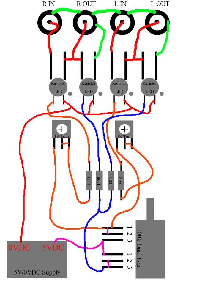

Lightspeed Drawing
Lots of wiring questions so hope this helps a little.
You dont need a board for the basic lightspeed. It just makes it bigger and gets in the way. If you really want a board use what George uses and get some perfboard.
BOM
4x100ohm resistors
4 LDRS
2 1k trimpots. You could use just one. 2 is easier.
1 100k dual log pot. Any pot. Junk is fine.
5v/0VDC power supply of about 100ma or more.
Uriah

Hi guys,
Got a question here regarding mounting the LDR.....
Which one the best way to attach the LDR....
1 - Is it solder the LDR input lead section directly to input of the RCA and use a shielded wire between the input at the amp pcb and output of the LDR.....or
2 - Solder the LDR output lead section to the amp pcb and run a shielded wire between input of the RCA and input of the LDR.....
Which one is the best........
Suggestion and comments is much appreciated here....Thanks

With a difference of 5 inches I bet it doesnt matter, but I like that you are trying it inside the case. I think this is best as it not only doesnt add extra connections it actually ends up eliminating some connections. NICE 🙂
I think I would put the resistor side directly on the board.
Be very careful soldering the LED side. Quick and precise. You dont want to burn anything and those leads are kind of on the fragile side and I bet they conduct heat really fast to the LED. The leads on the resistors are long. Leave yourself some decent length on the resistor leads. What if you decide to change amps some day but want the LDRs back off of this amp? You will want some length on those resistor leads so you can easily remove them and reinstall on another board.
Uriah

Uriah won't it be too difficult since output from resistor side got 2 leads....how about taking the first choice, solder LDR input (one lead) to RCA and connect 2 output of the LDR using hookup wire to input on the board....I think that way would be much tidy...
Hope the LDR lead is bendable....
Thankfully the resistor leads are just like any other resistor lead. They are bendable. I think your idea is even an improvement on having it inside the box! Remember, one lead from resistor A goes to RCA center pin and the twisted leads from A and B go to the amp. The last lead goes to ground which could be signal ground at your amp or signal ground at your RCA but either way the amp signal ground and the RCA signal ground must be connected as well. So maybe your resistor lead goes to the amp and a wire goes from the amp to the RCA GND.
The LED leads are like a flat piece of foil. The will bend but not twist and they are very thin and not very wide.
Uriah
Uriah
Re: Lightspeed Drawing
Uriah -- we gotta get you a better schematic drawing program 🙂 Jack
udailey said:Lots of wiring questions so hope this helps a little.
BOM
4x100ohm resistors
4 LDRS
Uriah
