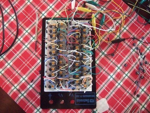

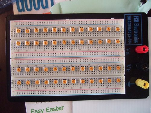

Gonna go take a pic of the mess I am using to test. Its working but its hell. I have new jumpers on the way from Allied and hope that helps keep the 'height' of my test fixture to a minimum and out of the way of my LDRs resistor leads. Just a sec and I will show you guys
Uriah

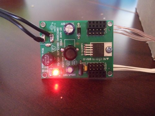

Little 5V 1A regulator run off of a 12VDC wallwart.
That'll do it. I can test 48 at a time, but its very time consuming still and when you screw up a wire... none none of them work so cant wait for the jumpers. Searching for a wire thats got itself uninserted, ugh.
