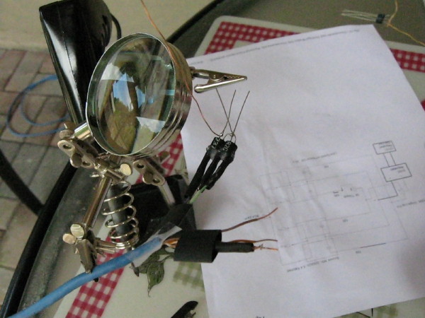

Got a question here regarding mounting the LDR.....
Which one the best way to attach the LDR....
1 - Is it solder the LDR input lead section directly to input of the RCA and use a shielded wire between the input at the amp pcb and output of the LDR.....or
I took this approach and have been very happy with the performance. I left the LDRs about 1/2 inch up from the board leaving room to attach signal input wires that were hard wired to a DAC. I used CAT5 to wire the LDR attenuator back to a control PCB that had the power supply, pots etc. The LDRs are glued together with silicon seal and encased in shrink wrap. That way there is no external light pollution, and they are heat insulated. I get great performance with no drift.
2 - Solder the LDR output lead section to the amp pcb and run a shielded wire between input of the RCA and input of the LDR.....
I suggest that the LDR is as close to the amp input as is possible because the output from the LDR is high impedance and low level - so more prone to pick up, interference etc.
The input to the LDR is higher level and driven from a low impedance - so less prone to interference
mike
If this is a problem, bypass the hot side of the LDR with 100p or 200p
