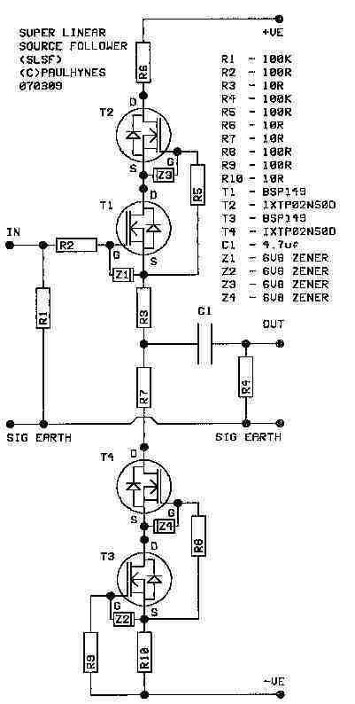

For those who want a high performance buffer for their Lightspeed volume control but would prefer not to work with the dangerous high voltages used in the Super Linear Cathode Follower (SLCF) I have a depletion mosfet circuit version for you based on the SLCF topology.
I have been using this circuit in various designs since IXYS launched their depletion mosfets and can vouch for it’s excellent audio performance. Sorry the BSP149 is surface mount but Infineon seem to think that the world no longer needs the leaded version. It is possible to hard wire the BSP149 into the circuit without too much hassle. Just make each supply rail about 10 volts higher than the maximum peak voltage swing you require to allow some headroom for the cascode. Quiescent current is around 50ma and this can be increased if desired by reducing the value of R3 and R10 (keep them the same value). The IXYS mosfets may need a heatsink depending on the voltage rails and quiescent current settings.
