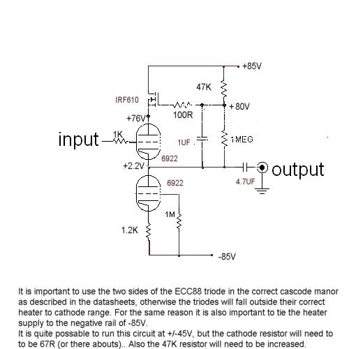

would I be wrong in speculating that the super linear cathode follower circuit,is also incorporated into Allen Wright's Vacuum State Electronics components?
I'm certain that he borrowed the same circuit from the same implementation......
