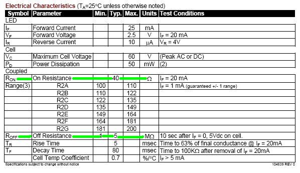

Matching LDRs
Perhaps could someone clear up, what I don't understand (Georges basic-circuit): The Amp is always "looking" at the resistive side of the LDRs. So every channel has the same resistance, if the both serials and the both shunts have the same resistance. So why matching so much, if it is only necessary to bring every of this two pairs to the same value: Adjusting the 4 (actually 3) 100 Ohm resistors (or i.e. using a trimpot at the serials and at the shunts). 😕
Serials and shunts should have constant resistance-overall-values at all volume-steps...
But they dont have a constant value cuz the manufacturing of the LDRs is a bunch of junk. They sound great but they could be cut with lasers rather then the apparent hack saws. You might read 2k ohms with a 40k resistor in series with a LDR or with another LDR you might read 7k so you have to keep working till you get two with the same reading over many resistances in series with it and then you can start to build. The trimpots will take care of small differences but not 1k differences or even close to that.

TJF said:Do you mean they are differing so much? Several kOhms at resistive side?
Yes they do. I have looked for other sources and pretty much its Silonex or Perkins Elmer who sells an LDR they call a Vactrol. They have one that has apparently 2 resistors in it. WOW this must be the holy grail, right? Nope, the single package has two resistors and they are guaranteed to be within 20 percent of each other.... Who wants that?
TJF, I know I am talking negative but in all truth this is by far the best pot I have ever heard. It never fails to impress and OMG when you listen to really well recorded music through it its mind blowing. Build one and keep it forever.
Uriah
That's a word Uriah! Thank you. Couldn't get a feeling for the dimensions until the right parts arrive 🙂Yes they do.
Nevertheless: There are Trimmpotis from 100Ohm to 1MOhm... so it should be possible to regulate the circuit (only with 3 Trimmpotis instead of hundred of measured LDRs).
I don't want to displease anybody, I only want to understand, why it is necessary to order hundred or thousands of LDRs to get the things work in one or two houses ... Perhaps I don't understand anything at all up to now - I am shure I will do ...

No no. I was selling them. Thats why so many for me. Pretty cleaned out at the moment but when I get to Texas in a month or so I might buy a few hundred more.
You dont need that many. Buy 25 and you will for sure get a good match. Dont buy the sorted ones. There is no advantage. Get them as cheap as possible and put a call in to Allied and ask for a discount off of the regular price.
