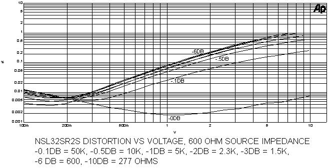

One thing that continually gets raised in criticism of this LDR approach is the high distortion of the LDRs. Here's a quote from Greg Ball (a former member here & developer of the SKA amp)
I think we should not concern with the low order distortion type but more with the fact that it is very low if used in the range of 100 - 200mV, as shown in the graph you posted(again below). This is a typical operating level when feeding a preamp with 12-14 dB gain, then into a typical 26 - 28 dB power amplifier
While these 3HD distortions emerge at high levels, they are insignificant at around 200mV🙂
What do people make of this in answer to the criticism, it sounds correct to me but I haven't seen this counter-argument before ?
These are rms distortions which are still far lower than some tube amps and much lower than probably all speakers, music isn't rms.
Peak measured distortions (and they are low order) would be far lower than these figures, if it were a problem why does everyone love the sound so much?
Also the way Greg Ball uses them they are in "shunt" only arrangement with series resistor same as (my MkI) version, which is higher in distortion, maybe that's why he said what he said.
The series/shunt (my MkII) is not, this was why I recalled all my MKI version years ago and upgraded them to MkII. They sound far better than the MkI. And have a much lower attenuation level. And also have much better constant impedances.
The only down side, as now your all aware of, is the dreaded matching of the LDR's.
Cheers George

Marc the audio signal passes through the resistor element of the LDR which is varied by the light falling on it from the LED buried in the LDR. It's the resistive element distortion that the graph from Silonex shows.
George I agree with you, I was simply pointing out the counter argument to those that accuse LDRs of high distortion.
