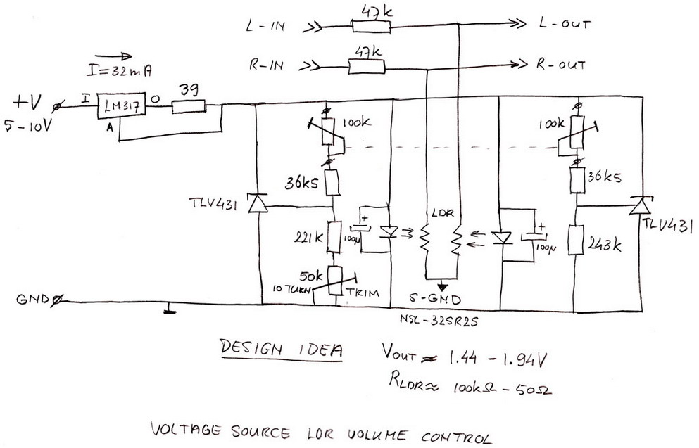

Patrick, Mike, Panelhead,
Two days ago I promised to share a drawing of a real voltage source version of the Lightspeed volume control. This is a design idea that I never built because I am afraid that the temperature dependency of the LED’s could be an issue. But perhaps it is not a problem at all, who knows? See the attached file for details.
It’s shunt regulator fed by a constant current source. The resistance values are calculated to be able to use a 100k potentiometer because that is what almost everyone is using now. But it’s perhaps better to divide all resistor and potentiometer values by 10, so the circuit would be less highohmic. A trim potentiometer is added to be able to match the optocouplers. I think that there is no need for heavily selected optpcouples to get everything perfectly matched. Likely it can be powered from a 5V source but that will be on the tight side because of an almost 3V voltage dropout of the current source.
When someone is going to try it, please check the output for stability. TLV431’s can oscillate under certain circumstances (but are usually dead quit).
Peter
