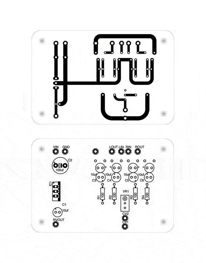

Peter,
thanks for the CCS circuit - I tried it and although I need to make a few changes ( i.e. better quality series resistors ) I quite like the sound. I think I am hearing the lower distortion that someone posted a picture of.
Do you think putting a few bypass caps across the pot will overcome the problem of DC flowing through the contact ? - It will be a while before I get a stepped attenuator

Mike,
Great that you took the plunge! Off course the quality of series resistors is quite important. But everything should sound a lot cleaner and more natural right away.
If you have no problems with crackling pots then you are lucky. Caps across the pots could help but I didn’t try it because I had the DACT available.

Tom, do me a favor and add your resistor configuration to the layout George has posted. Thanks
