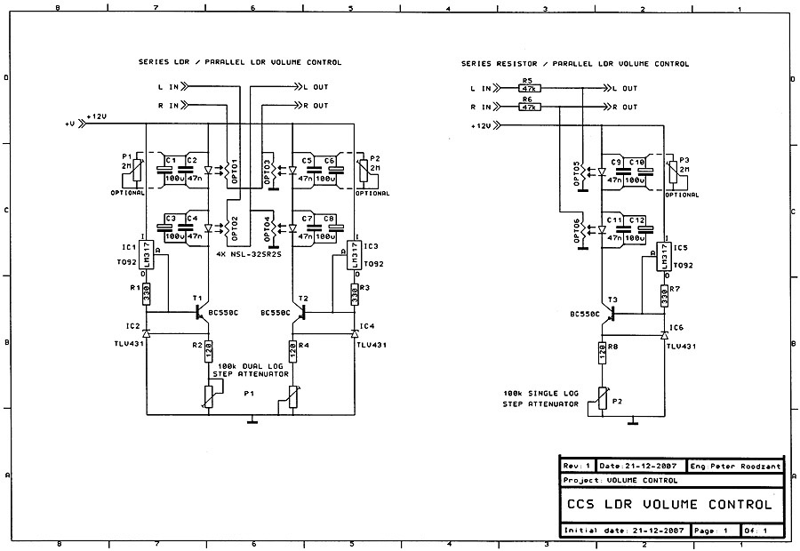

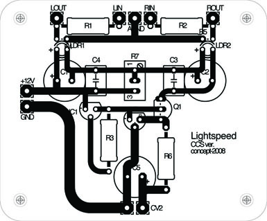

I will be trying this model as well (or at least the first series resistor CCS schematic posted). I've got a PCB layout ready to go for it and will also be picking up some Shinkoh tantalums. I might also recommend Rikens and Kiwames. should be a bit less detailed then the Shinkohs, but warmer than the vishay and caddock offerings.
This is not a dodge to the original Lightspeed as I love it to death... just want to hear the difference myself.

Peter: I'm going to use your schematic (see below) with the addition of an optional cap to buffer the pot.
I've already got the 12V PSU and the perfect pot so I'll literally just be switching out the PCBs for my tests.

I used 2 IN4002's for my ref ( powered by LM317.) They may not have absolute Vref performance compared with yours but all I am worried about is low noise in audio band - and on this I thought they would be at least as good - do you agree ?
I disagree on the caps because I tried it with CCS with and without caps and could hear little difference where as with V drive I heard a BIG difference. so my guess is that CCS controls LED noise very well.
Mike,
Of course you constructed a (well known) current source, but two diodes in series have nothing to do with a voltage reference! Even when fed by a CCS. The LM317 is used to push the performance of the reference even further. Put at least some electrolytics (100uF) and a film cap (100n) in parallel with the diodes to get a more stable situation. I am sure that you will hear the difference. But I recommend a real voltage reference.
See post #1001 for details
Peter
Peter,
I will check it out but I think you will find you have two forward biased diodes in your darlington BJT .. so if forward biased diodes are noisy surely you have a noise problem as well.
I am sure that the IN4002 diodes move around with temperature but are you saying that the diodes are actually noisy in the audio band compared to the the device you used ?
perhaps you are right - I do not know
I will try a cap across the diodes .. :)
mike

CCS-version
Sorry for my dumb question. What is the CCS version again. I lost a little bit the overview.
I have built the LS MK2 version 6 month ago. One problem is the high min level and the little flatness at high attenuation. Rest is good!
What version sounds best?
What are input and output impedance?
Tolu:
This is the CCS version I designed. See post #1001 for details. I use it as a volume control of a tube amplifier (so not as a passive pre-amp). The attenuation range of the version with the fixed resistor is about 60dB. But as you can read in post #1001 the design leaves much room to suit your specific needs.
Peter
