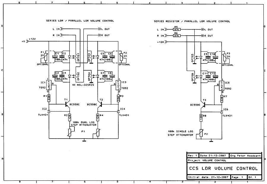

I made a test setup in which I was able to switch between your original design and the constant current source version in just seconds. I can assure you that the sonic differences are not small!
In my opinion the performance of a circuit is more important than simplicity. And who is afraid of just a hand full of components? I think my current source circuit is still quite simple.

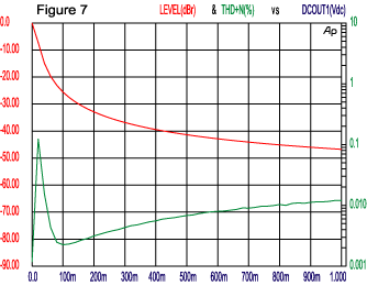

These are the Silonex measurements, green is the THD measurements red is the db level
As you can see the Series LDR with Shunt LDR has the best THD% at the medium to louder levels and the Series Resistor with Shunt LDR is better at lower levels, most of the listening with my Lightspeed is done in the top 1/3 of the setting after 12o'clock with cd as source.

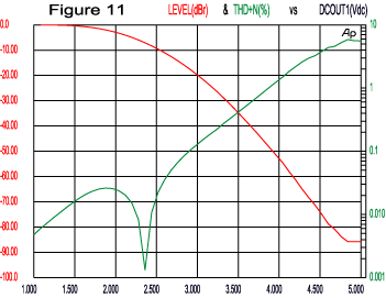

Here is the Series LDR & Shunt LDR
But all this is academic as the distortion that's present is H2 and low and is not unpleasant to the ear.

Hi Goerge,
thanks. I know the measurement from Silonex before. The Silonex measurements shows us:
The series+shunt configuration has low THD+N at levels from 0-10 db.
The series resistor / shunt LDR configuration has better specs at attenuation level - 10 db to ~.
Depending on the gain factor of your system, the one or the other configuration is best choice. Normally I do not listen at -10 to 0 dB attenuation levels, because of do not want to anger my neighbors.
With my measurements I do not see any improvement in THD+Noise when using Series LDR / Shunt LDR at low attenuation.
With my last post I wanted to show that the shunt LDR configuration could have be an THD+N Level as good as a passive stepped attenuator. And using only 1 LDR per channel making it easier to add µC and remote functionality for the couch potatoes.

The general opinion seems to be that the LED’s in the original design are driven by a voltage source. A good voltage source has an output impedance of say less than 1 Ohm, and a good current source is well above let’s say 1 MOhm. Let’s take a closer look at what the LED’s are seeing. They are driven by a voltage source with a resistor in series that varies dependant on the volume setting, between 100 Ohm and 100 kOhm. That is, seen from the LED, neither a good voltage source, nor a good current source. It is something in-between. On one side (potentiometer 0 Ohm) it behaves more like a voltage source, on the other side (potentiometer 100 kOhm) it’s getting current source specs.
The amount of light a LED emits is primary dependant of the current flowing trough it. If you want to keep the amount of light stable, keep the current stable. That is why semiconductor companies have so many devices that drive LED’s by constant current. And that is why the CCS approach yields better results.

Peter, how closely do the components in you CCS need to be matched? I am referring to the series/shunt layout.
Mike:
As you can see in the attached circuit diagram I used the capacitors across the LED’s. I remember your posts from some time ago about the positive results with these caps. And I think it’s a good idea to add these. I did no additional listening tests to verify this.

Matching is quite simple. I ordered 10 pieces from Allied. Selected the 4 best of them for a future project and used the 4 next best for this project. You can add an optional potentiometer as shown across one of the LED’s to get them perfectly matched. I measured errors of less than 0.2 dB over the whole range. No conventional potentiometer (except stepped attenuators) can do that.

Badge said:Peter, how closely do the components in you CCS need to be matched? I am referring to the series/shunt layout.
Badge, the matching of the LDR's (NSL-32SR2S) will be the same chore, regardless of what system is used to power the led section.
