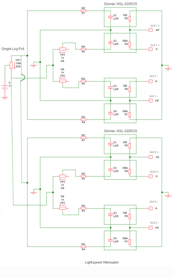

lightspeed configuration for balanced audio
Hi George and the rest of you,
I would like to make a Lightspeed for use with balanced audio and I'm looking for a description/schematics of how to wire this. I have been searching and reading this thread for several hours and I know the information is here but I still cannot find it...... I'm hoping that it can be done by wiring together two single ended modules.
Could somebody please point me to a post number or in any way help me.

There you go good luck on the matching of all the ldr's, and use a dual pot instead of this single as in the standard single ended version, as there will be too much current flowing through it for a single pot.
Cheers George

A fixed series/variable shunt style balanced attenuator can be done with one optocoupler per channel to minimize the required matching.
