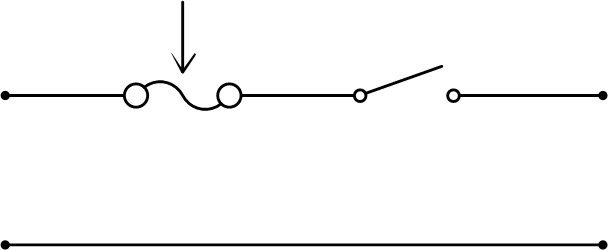

If that is a switch on top of the input DC jack then it is certainly wired incorrectly and THAT is what is killing the Wall warts.
EDIT: Skip the fuse, wire the switch in series like this:

That is exactly what i was looking for but i was to buys and doing some coding stuff, so i didn't look to far, right now the idea is to remove the switch and that input jack.

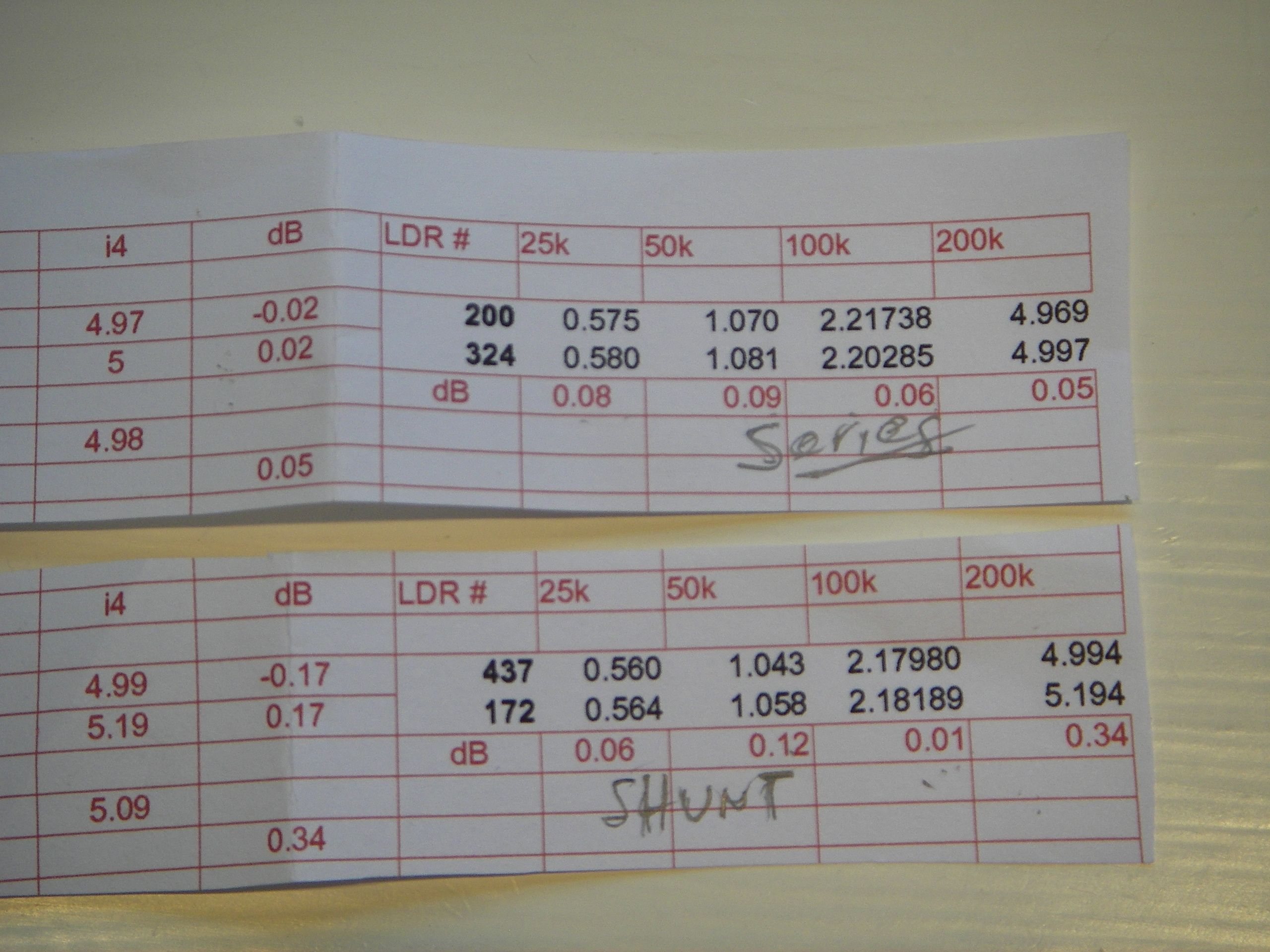

I have populated and tested the pcb provided by dbv-projekt. I also used the Bom listed by Orpheus in the "pcb" thread. LDRs from Uriah. The pcb has trimmer pots in both legs of the series ldr's. I am using a 100k log Alps pot.
I've tested the circuit with a 9V battery and using ipod as input with volume on ipod max. Output to headphones. I can hear very low volume from 7 o'clock to 1 o'clock and then slow increase and then very narrow range to full volume 2 o'clock to 5 o'clock. Voltage from lm7805 is 5V. I've tried the trimmers down to min resistance and then to max but still there is very little change in range of attenuation.
Measured resistance from input to output at various spots on the rotation of the pot dial are 7 o'clock =5.5k, 9 o'clock=5.5k, 12 o'clock=4.85k, 1 o'clock=4.0k, 3 o'clock=1.8k, 5 o'clock=40 ohm. For Left channel. Right tracks similarly.
These are the values used for shunt and series.
So, How do I get a more useful -full range of attenuation throughout the turn of my pot?
Do I need a different value of Pot given the values of the matched ldr's?
Any Ideas?
Is this just a limitation of using ldr's as atttenuator?
Also for those using Orpheus BOM, the trimmers listed have the screw on the side. At least that is what Digikey sent me. The Alps pot doesn't fit readily in the holes and needed some bending and coaxing of leads to fit. Not a big deal.
Thanks.
JC
Any Ideas?
Thanks.
JC
Yep, thats a problem with the LDR based pot. It ramps up real fast once it starts getting toward loud then it gets loud FAST. The trimmer wont change this at all, it will increase the impedance max. Different impedance sounds different and sometimes the wrong value will give your amp/cdp trouble.
Your 2-5Oclock is actually nice. Most people dont get LOUD that far in the turn. It usually is before that.
See the log pot has a taper to it and the LDRs have a taper to them and when things get loud both tapers are increasing quickly in value so the interaction of the tapers happens real fast.

jcon2, other limitation is they don't go absolutely quiet. Just testing my attenuator, finished this morning, listening to What's Going On by Marvin Gaye. Amp volume turned up to max (amp is Peter Daniel's gainclone), attenuator at minimum volume, still audible, level a bit lower to what I normally listen to. No opinion yet on LDR v Alps blue velvet pot! Thanks again to Uriah and Oliver for LDRs and PCB! Mark

In the production Lightspeed Attenuator that I make, it behaves much like a normal pre with a log pot, that is from zero to about 2 o'clock it is very gradual (12 o'clock being good loud level) then starts to come on strong after 2 o'clock to the end, that is is with 87-92db speakers and with amps of 1-2 volts input to clip.
You must remember this is with 4 x matched NSL32RS2S's, not two matched pairs (which will give different ramping), also a dual log 100k pot for the voltage feed. And the power supply as I've done, not some of the others around in some of these threads.
