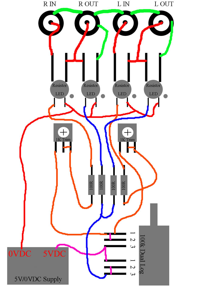

Wish i had a kit! WINK WINK!!
Well to my knowledge there is no such thing as a Kit to the Lightspeed and I will not be the first guy to offer them.
What I am attempting to do here is keep this thread alive and keep people interested in DIYing their own Lightspeed.
I think any more talk in the negative tones we have experienced in the past few pages is counterproductive and I am trying to steer this thread back toward a more positive attitude where people feel free to ask questions about building their own Lightspeed in their own basement for their own use.
If I have any place to say so on this thread I would hope that we can turn the boat around and talk exclusively about George's Lightspeed circuit without mention of kits, etc which can do nothing but upset him further.
SO, again if you are new to this thread or have read it several times but have not built this circuit... DO you have any idea how easy this is to build!!?? It has got to be the simplest circuit for a new DIYer to dive into and will absolutely build a hunger for more DIYing as the results prove beyond a shadow of a doubt in any system that DIYing your own audio can provide incredible results.
To illustrate how easy this is to build I am going to look for a little pic I posted a year or so ago that has helped a lot of schematically challenged folks built the Lightspeed.
Lets keep it positive and on track 🙂 Pic coming up, have to search hard drive..
Uriah
Uriah

I'll chime in.... 🙂
I used Uriah's diagram to build my LS onto perfboard, but my very first experiment was hard-wired. Uriah supplied the matched LDRs and I supplied the other 10 or so bits! George's circuit is a great performer, and we're lucky he has shared it with us. I matched my LDR channels by looking at the outputs on the 'scope, at my listening volume position.
I built my effort into an old Trends TA-10 box (I murdered the original innards 😀 ), and squeezed in a super-regulated power supply as well (ALWSR - google for info). The lot is fed by a 12V linear wall-wart. Simples!
So, in summary:
No kit (or pcb) needed.
Definitely an easy first project.
Results far exceed effort or expense.
Use a clean power supply.
Cheers
Jon
