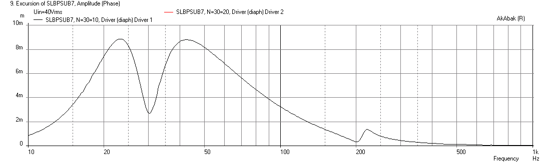

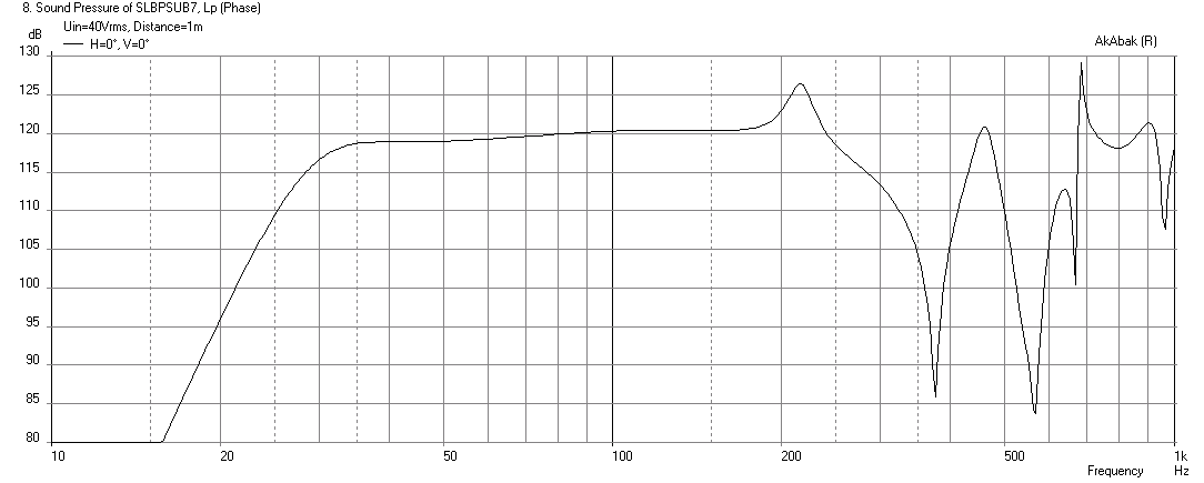

Here is a sim of the box that Tb46 drew up. It appears that the design can use the Dayton DCS220-4 as a drop in replacement. You just have to back off on the drive voltage a tad. But the predicted performance is very nice. Subs don't get much flatter with as wide of a bandwidth as this. 119 dB SPL at 1m (with corner placement) and -3dB is at 29Hz. To be clear, since Tb46 is so prolific with his drawings, this sim is based on this design:
http://www.diyaudio.com/forums/attachments/subwoofers/428991d1405626797-light-air-slot-loaded-band-pass-sub-xrk971_55-2421_ppsl.pdf
Corner loaded placement SPL at xmax of 8.8mm and 40 volts drive (with -24dB/oct BW high pass at 25Hz):
Cone excursion at 40 volts:
