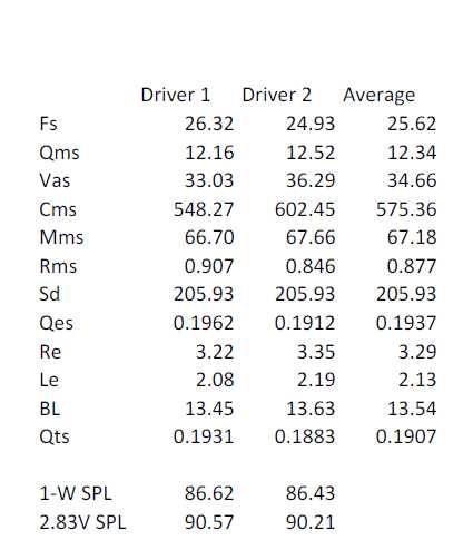

I like your result for the MCM 55-2421 PPSL in Post #40. That would be quite the test for the foam board method. Did you use the MCM T/S parameters or measured T/S? Littlemike (and others) measured these. I'll attach littlemike's values:
sreten posted these as measured by Zaph:
Fs = 30.95
Qms = 12.2863
Qes = 0.2365
Qts = 0.2320
Vas = 23.88
SPL = 86.59
Le = 2.42
B = 13.15
Xmax= 8mm (16mm P-P)

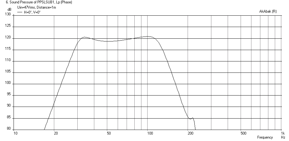

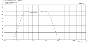

With Xaph's measured T/S params, I get a similar result, now with HPF set at 27.25Hz and xmax occurring at 47 volts to produce this result.
Keep in mind that these are corner-loaded predictions so max SPL will be less if used away from a corner - but should still be well above 110 dB.

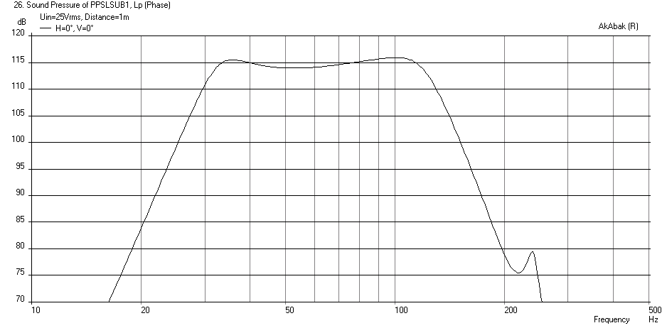

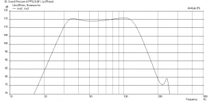

Design for Single MCM55-2421 driver in SL bandpass
I redid the sim using 9.5 in wide boards and a single driver. The design is still same volume of 18.5 liters for the rear chamber, 0.75 in deep x 9.5 in tall x 23 in long vents, 4.75 in wide x 9.5 in tall x 10 in long slot vent where driver is mounted in a push-only config. The max drive voltage to hit xmax is now 25 volts (which is easy to do in most sub amps) and gets you 115 dB in corner loaded config under your desk with 31 Hz (-3dB) bass extension. Not too shabby for some leftover wood boards and a $30 driver. 😀
