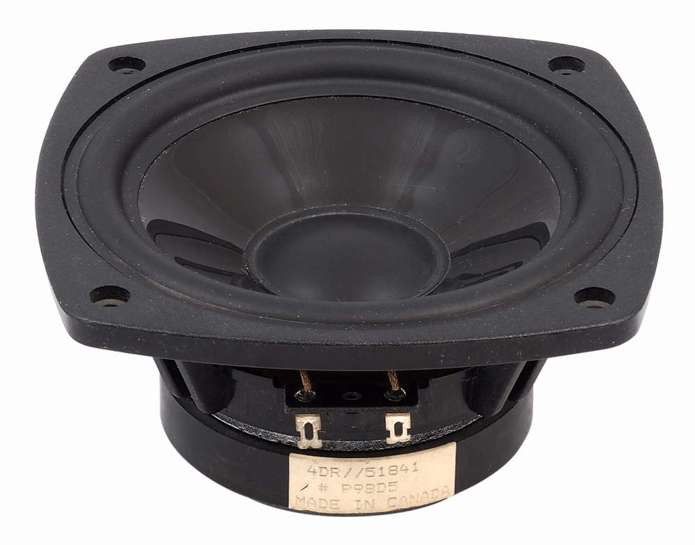

This slot loaded band pass sub looks very good! And I would like to give it a try as it offers smooth response up to 200 Hz, unlike tapped horns I tried to experiment with. Unfortunately, the mcm 55-2421 is not available in Europe and it would be a bit too much anyway. I would like to keep a lower form factor. Atm. I have the Tang Band W6-1139 and W5-1138 in my disposal and I would like to test if they could work in this sub. I also have set of 4 6.5” Poly Woofers for the 6 USD, but they are not suitable for this design.

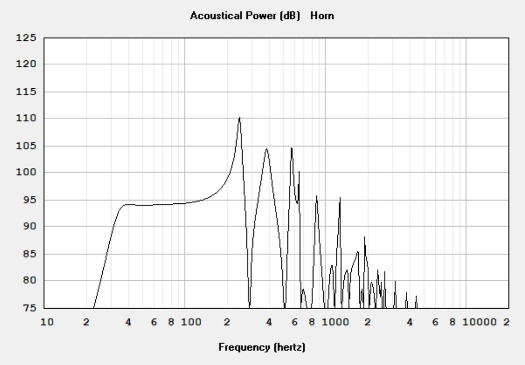

On the other hand, I managed to simulate the TB W5-1138 in Hornresp using the tapped horn model with a vented front chamber. The first horn segment is set to 0.1 cm (min allowed) with the second and third set both to 10 cm. The chamber size is 7 l and the went is 16x1.5 cm2, 58 cm long (if I fit it to the box). My idea was to have the box as tall as possible with the smallest form factor.
The results look quite nice for such a small driver - corner loaded at 1W. However, there are some significant spikes higher up. Could these be a real problem or are these just features of Hornresp? There are no filters applied, but the sub certainly needs HP around 35 hz and LP around max 150 Hz.

Those peaks are part of the design optimization and you want to move them high so your low pass filter can catch them. That’s what the stub on the trans flex is for. It absorbs that peak somewhat. I have not built that - it’s MMJ’s design so you might ask him.

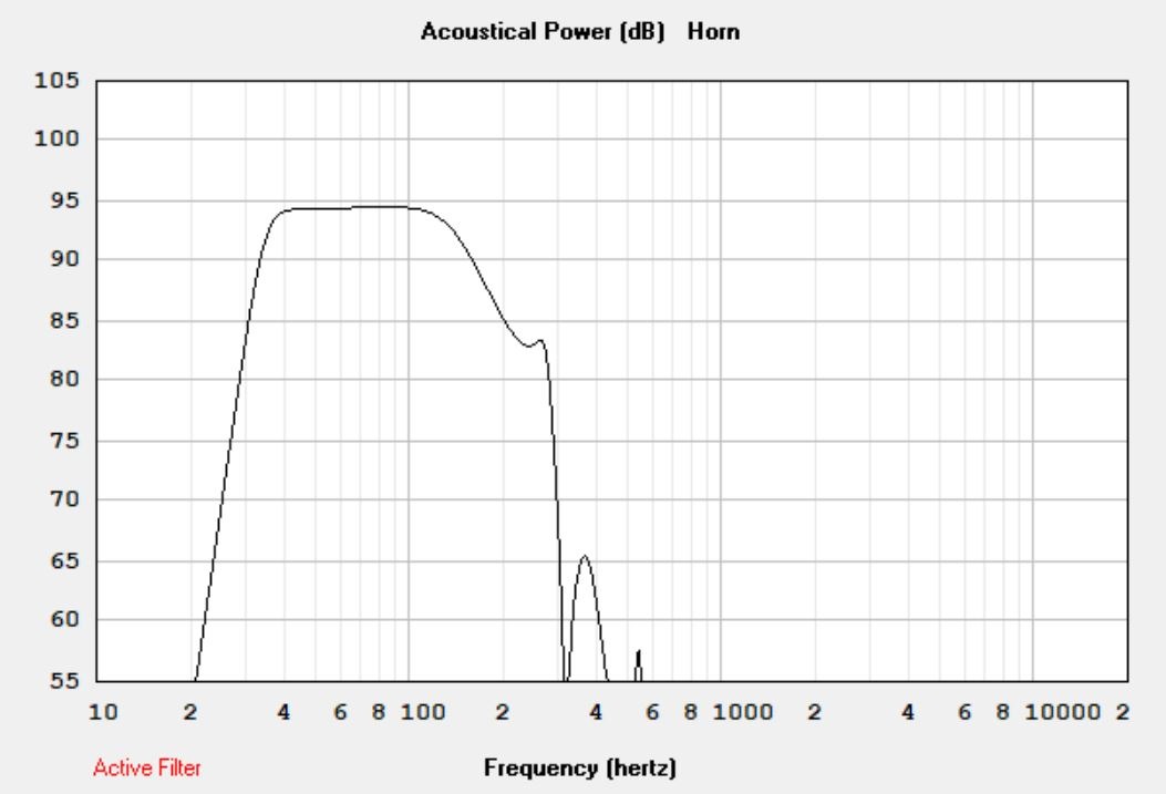

Thank you for the answer again. I just found out that the sharp peaks were port resonances so increasing the volume to 8l and shortening the port shifted the peaks higher up. Enlarging the slot then broadened the peaks so they are less prominent. Here is 4th order HP at 33 Hz and 4th order LP at 140 which should be OK with Nautaloss II.Those peaks are part of the design optimization and you want to move them high so your low pass filter can catch them. That’s what the stub on the trans flex is for. It absorbs that peak somewhat. I have not built that - it’s MMJ’s design so you might ask him.

Stub is a 1/4 wave snubber much like a 50ohm terminator on an electrical coax cable. If you have say a 300Hz peak, calculate the 1/4 wave length and make closed end channel of that length heavily stuffed with glass wool etc. it will absorb some of the peak. I am not sure what you are referring to as the brick in the diagram, sounds like the 1/4 wave stub above the vent. Your sim looks good - yes short ports are better than long ones. But short ones tend to be smaller so watch for max velocity in the port and keep below 15 m/sec.
Thank you for the clarification! I just found you mentioning it in another topic. I may try to incorporate the stub in the design. I am getting velocities at 22 m/s at full power, which is less than ideal. Increasing the port area moves the resonance even lower and so having the stub may be the way to go. If it does not work, making the full, double-speaker version and running each part with a lower power will solve the problem.
