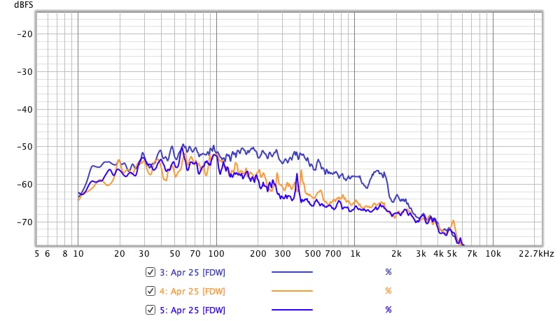

Attached are FR when I stood in three locations around my room. Quick and dirty. Just one of my subs playing. 130 Hz XO. If differences of this size showed up after adding bracing or other changes, I think they would merit our interest. 1/12 smoothing (wilder differences with 1/24).
FYI included is distortion. -50dB - quite nice for a cheap driver, eh. But played real quiet, late at night here.
...and how many times did you repeat the measurements to confirm their veracity?
In any case. the differences below 80 Hz, i.e. subwoofer territory are minimal to non-existent. If I ran my subwoofer up to 1kHz, I might be a little more concerned at how the position of my body in the room changed its response 😉

Frankly, I don't re-run FR curves, like you are suggesting, because you'd need a magnifying glass to see the difference..... unless you moved the mic a few inches. Or, when the levels are quite low (on the right tail end of my plots) or with THD where ambient noise intrudes....and how many times did you repeat the measurements to confirm their veracity?
Details of THD curves - which can be 50dB below the fundamental - do vary all the time depending on the A/C in your house, street traffic, railroad trains a mile away, etc.
In the case of sitting on the sub, the wall vibrations might be in that -50dB range and so body location can have an influence on results from cab in various ways.

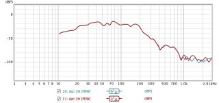

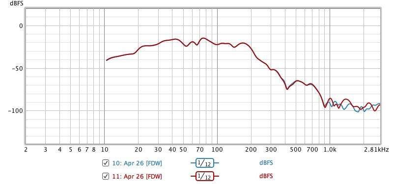

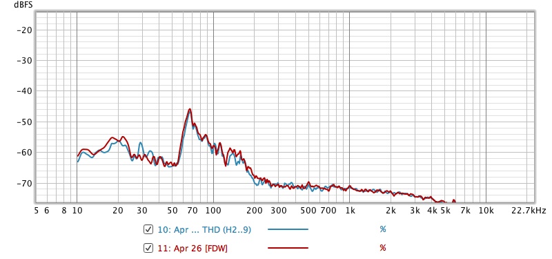

Attached are re-runs at about the same loudness as last night. Ooops, was that a garbage truck passing by?
Are you doing measurements of your subwoofer's response or the subwoofer plus the room's response?
For example, is that a close-miked measurement of your subwoofer's output?
Which is exactly why you repeat these measurements until you get a consistent enough result. Or just average them in REW.

Must be whole room - just used my laptop mic (elsewhere I've posted that is just dandy... as is the case here too).
But... Average THD? That's a new one for me, eh.

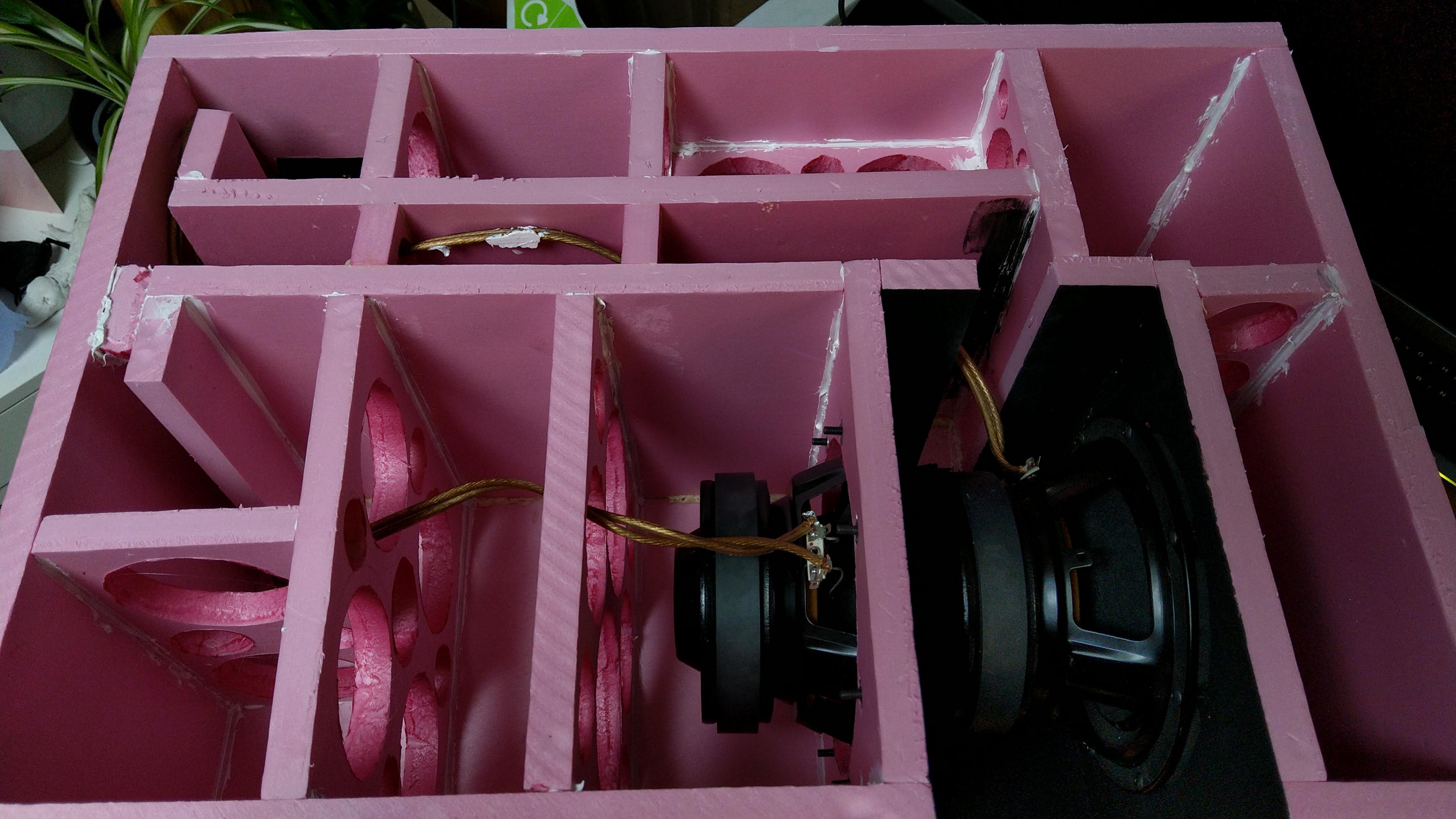

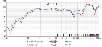

Right so I've rebuilt the sub and taken some measurements.
This is the old inadequate bracing. Yes I know it looks ridiculous. I built my first speakers 30 years ago but in my defense I am out of practice and had never built a sub before.

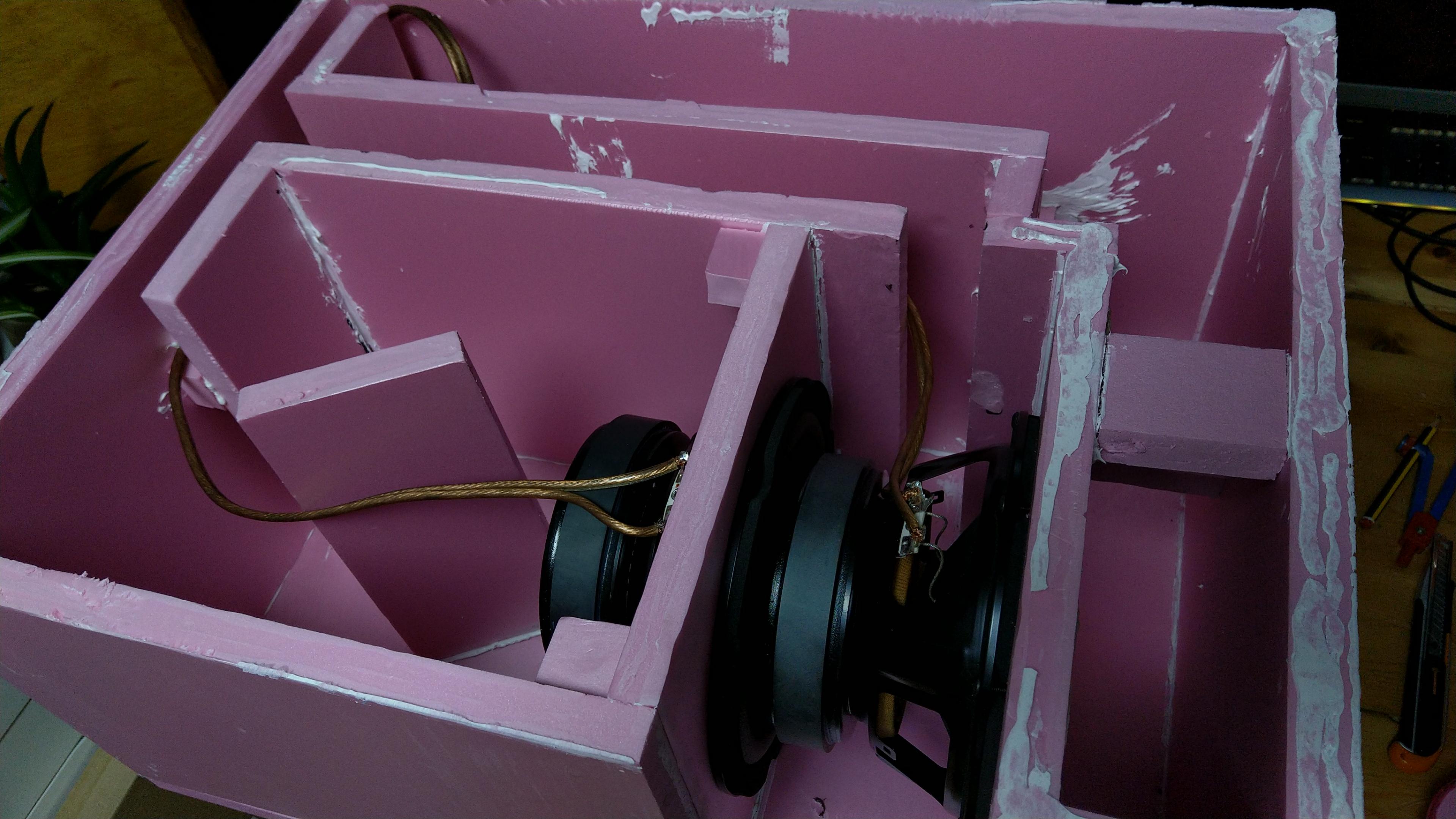

This is how I've rebuilt it. I've adjusted the internal dimensions to allow for the volume of the bracing, so it is 5cm taller than last time. I also made the slot deeper so the drivers can be removed without tearing the speaker apart. I made the braces by cutting the xps foam with a temp controlled soldering iron which worked very well.
I started off using Gorilla Glue, but went back to the trust Sticks Like Sh*t Turbo as I didn't need to clamp most of the joints and it also makes an airtight seal.

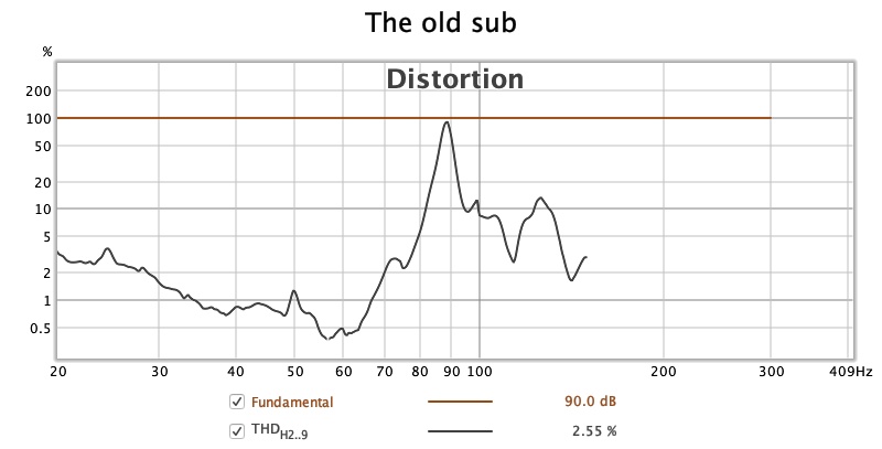

1. Did the bracing improve thd? yes.

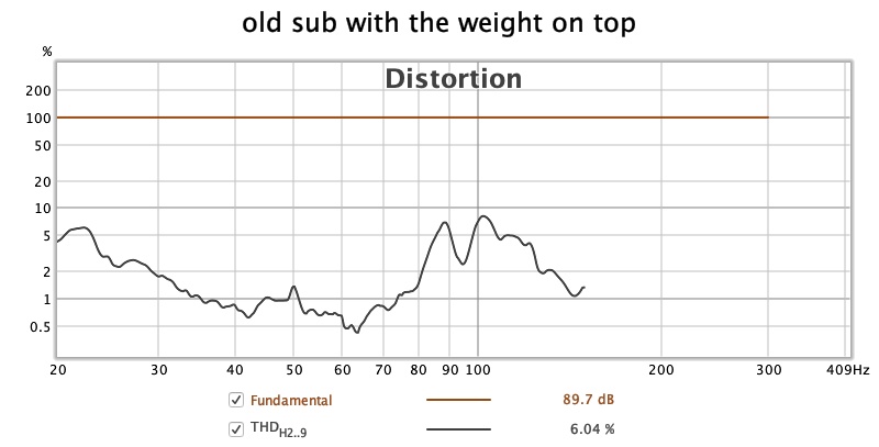

Here is THD for the old sub. That crazy resonance just under 90hz measures about 90% thd

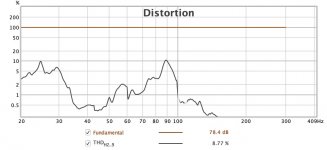

Putting the heavy weight on top definitely improved things, bringing that resonance down to about 7%

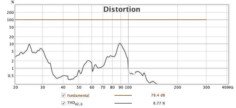

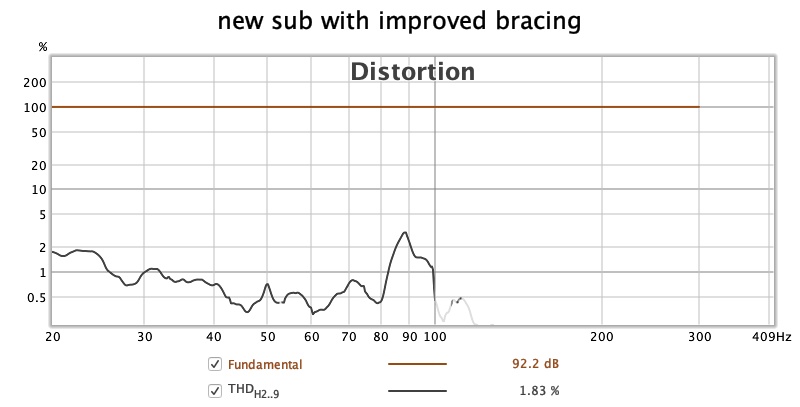

But proper bracing is a better solution. Even the crazy resonance is down to 3% without thd below 1% for most of the useful range

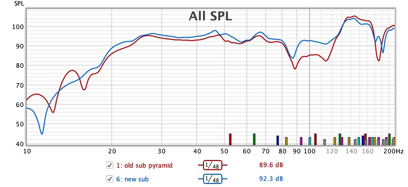

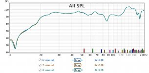

2. Did the bracing affect frequency response?
Some useful dbs around 100hz but most of the rest of the response is similar. The volume increase might be due to a change in the volume dial. I didn't match output voltages.

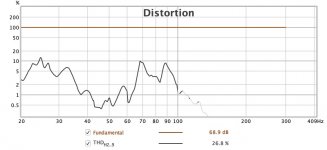

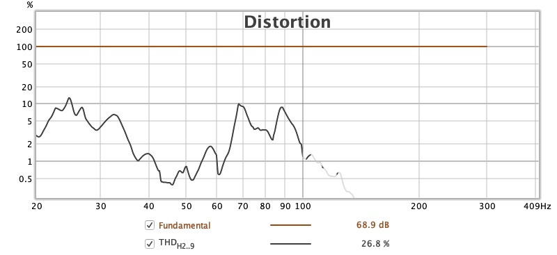

3. Do the two drivers actually cancel each other's distortion?
I was surprised how well they cancelled the distortion. PP gives a profound improvement in thd, from 2-5% through most of the range to <1%, and at that resonance peak from 10% thd with single drivers to 3% with boh. I ran the sweep on the push driver, then the pull driver, then both again to check consistency with the measurements above.

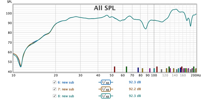

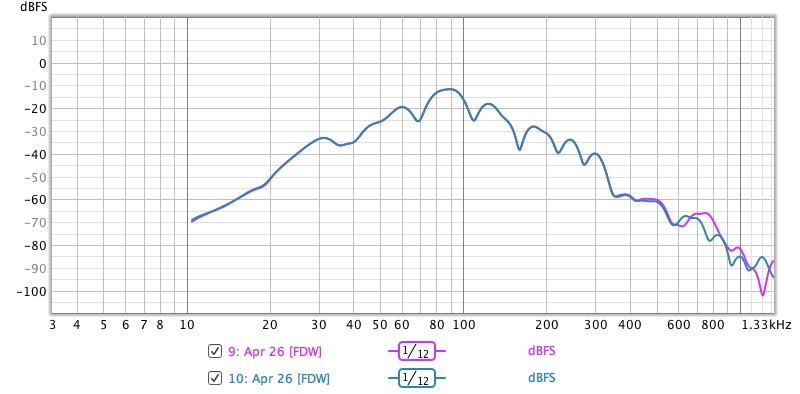

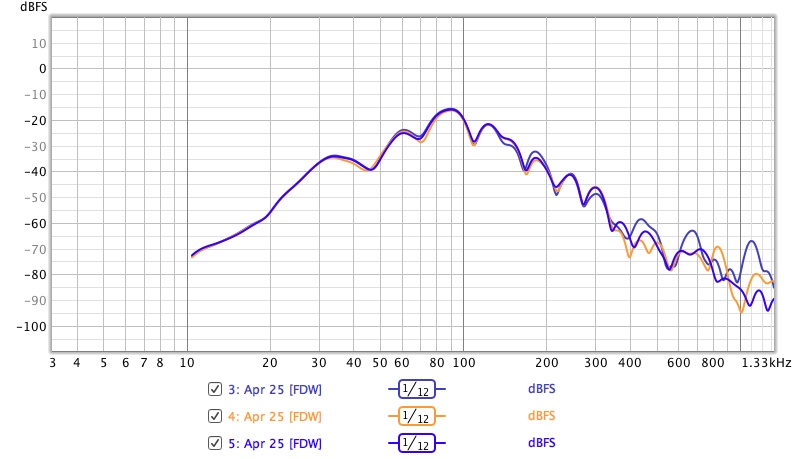

4. Is the frequency response consistent between measurements?
I wasn't excited about this but some other people were. It is consistent above 18hz - not sure what is happening below that but the sub output was very low in this region and could be affected by background noise
I also took the distortion measurements 3 times but didn't bother averaging as they looked very similar.

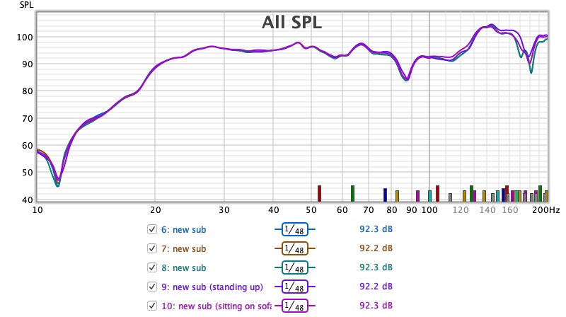

5. Does the person moving in the room affect frequency response?
I think we knew this one too. It does a bit. Room is 2.3mx2.2mx3.2m. I sat on the floor, stood up, then sat on the sofa. Close but not identical responses.
