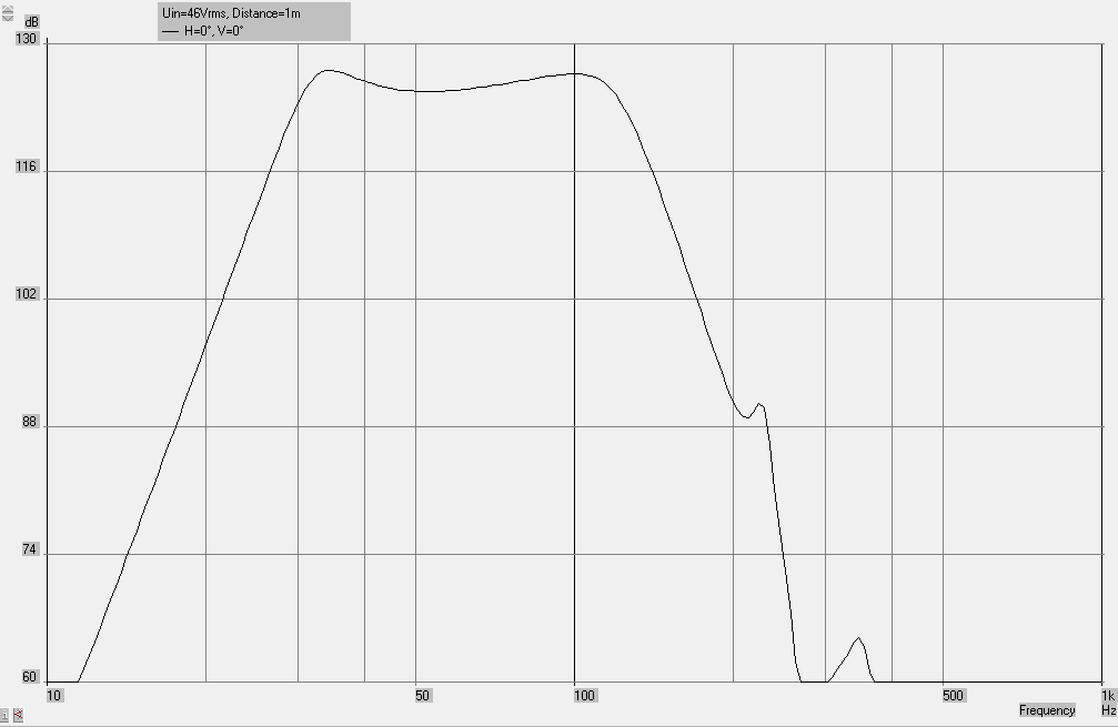

Here's that MCM (bold) in Bill's "T18". - the lighter trace is a Table Tuba

I've bought and measured about twelve of these over the last sixteen years, and they generally measure like this:
https://www.diyaudio.com/forums/subwoofers/37908-mcm-55-2421-parameters.html#post437592
The specs on the MCM website are totally wrong.
But they're a great little sub, arguably the best driver for horn loaded enclosures that costs less than $100. For $50 each they'd be a bargain, for $25 they're a steal. I don't understand how they can even ship them for $25 each.
your MCMs looked better than spec with regards to suitability for vented boxes. Many of the drivers I've bought measure with higher qts than factory spec - but not all. Audio Nirvana's AN8 pair Fs shifted a half octave up from when I first got them. Two sets of Peavey are abnormally stiff and a half octave high too.

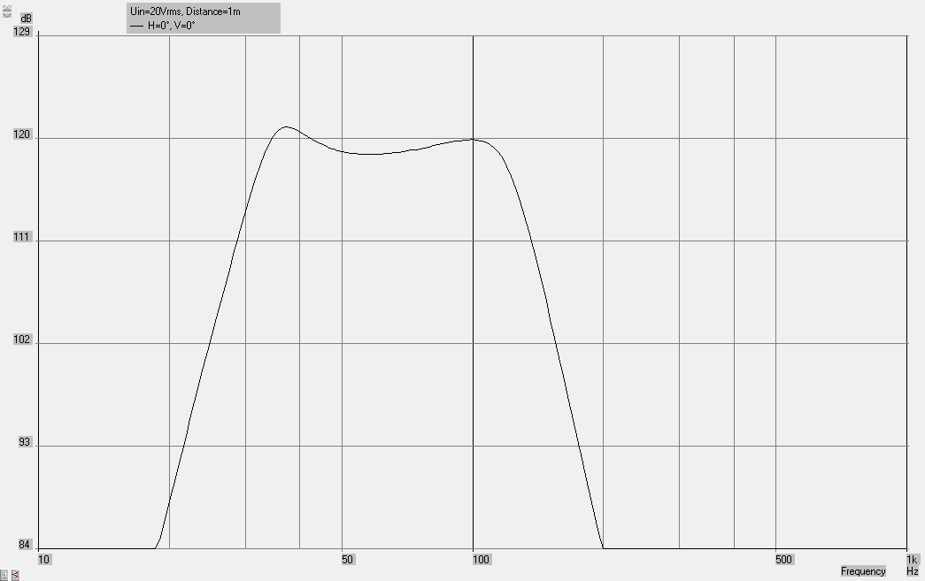

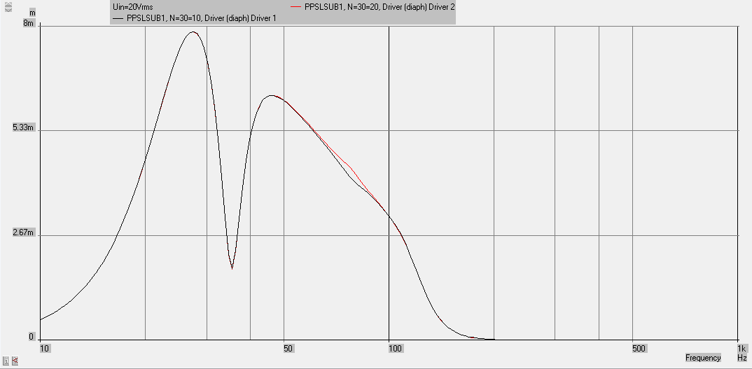

I've had a go at modelling MCM 55-2421in Akabak using Zaph's measured specs and tb46's short model dimensions - the short and long models looks identical in performance. 20-22v gets to xmax. First time using Akabak so not 100% confident in what I've done with xrk971's code.
The graph below models the original vent size - the short model smooths out the 200hz peak
Code:
System 'S1'
| Push Pull Slot Loaded Subwoofer
| PPSLSUB1
| July 16, 2014
| by xrk971 / modified bigbrowncow 2021 [but first time using Akabak!]
| with dual MCM 55-2421 8 in drivers
Def_Const
Q=0.707;
Speaker_pos=5.0*0.0254; | Height of centerline of exit port above floor
Width=41.75*0.0254; | Width of cabinet external
Height=63.9*0.0254; | Height of cabinet external, 24 in long chamber ea + slot
Depth=16.5*0.0254; | Depth of cabinet 14 in deep internal
Dist_wall=5000*0.0254; | Distance from wall
Backchamber_vol=37.0*0.001; | 37 L gives 12.5in L x 10in H x 9in deep
Slot_width=4.75*0.0254; | needs to wide enough to fit driver in push-pull
Slot_height=10.0*0.025; | height accounts for bracing reduction in CSA
Slot_length=10.0*0.0254; | lenght of two ducts that form slot deep enough to house 18 in driver
| *** dual rear resistance vents
Vent_width=0.75*0.0254;
Vent_height=10.0*0.0254;
Vent_length=23.0*0.0254; | Code bodged below to have two vents merging into one
System 'PPSLSUB1'
Def_Driver 'MCM55-2421' | Bateman/Zaph specs
SD=208.7cm2 |Piston
fs=30.95Hz
Mms=59.8g
Qms=12.2863
Qes=0.2365
Re=3.4ohm
Le=2.42mH
Vas=23.88L
| OFF
Filter 'High Pass' | 4th order Butterworth -24dB/oct
fo=27Hz vo=1.0
{b4=1;
a4=1; a3=2.613126; a2=3.414214; a1=2.613126; a0=1; }
|OFF
Filter 'LowPass' |Lowpass filter - 48dB Butterworth (change 'fo=***' and refresh for changes)
fo=120Hz vo=1
{b0=1;
a8=1; a7=5.125831; a6=13.137071; a5=21.846151; a4=25.688356; a3=21.846151; a2=13.137071; a1=5.125831; a0=1; }
|OFF
| Speaker placed in corner with driver at Driver_pos above floor in corner
Def_Reflector BottomCorner
Bottom={Speaker_pos} Left=17in Right=17in
HAngle=0 VAngle=0
OFF
| Speaker with driver at Driver_pos above floor Dist_wall away from wall
Def_Reflector HorizEdge
Bottom={Speaker_pos} Top={Depth + Dist_wall}
HAngle=0 VAngle=0
Enclosure 'Back chamber 1' Node=10
Vb={Backchamber_vol/2} Qb/fo={Q} Lb=10in
Enclosure 'Back chamber 2' Node=20
Driver Def='MCM55-2421' 'Driver 1'
Node=1=0=30=10
Driver Def='MCM55-2421' 'Driver 2' | driver 2 is reverse mounted with phase reversed
Node=1=0=30=20
Duct 'D3' Node=70=30 | rear half of output slot
WD={Slot_width} HD={Slot_height} Len={Slot_length/2}
Duct 'D4 Slot' Node=30=32 | front half of output slot
Duct 'D1 Vent' Node=10=31 | resistance vent 1 leading to mixed vent
WD={Vent_width} HD={Vent_height} Len={3.0*0.0254}
Duct 'D2 Vent' Node=20=31 | resistance vent 2 leading to mixed vent
Duct 'D7 Vent' Node=31=70 | mixed vent from vent 1 and vent 2 leading to slot
WD={2*Vent_width} HD={Vent_height} Len={Vent_length - 3.0*0.0254}
Radiator 'Vent_rad'
Def='D4 Slot'
Node=32
x=0 y=0 z=0
HAngle=0 VAngle=0
WEdge={Width/2} Hedge={Height/2}
Reflection

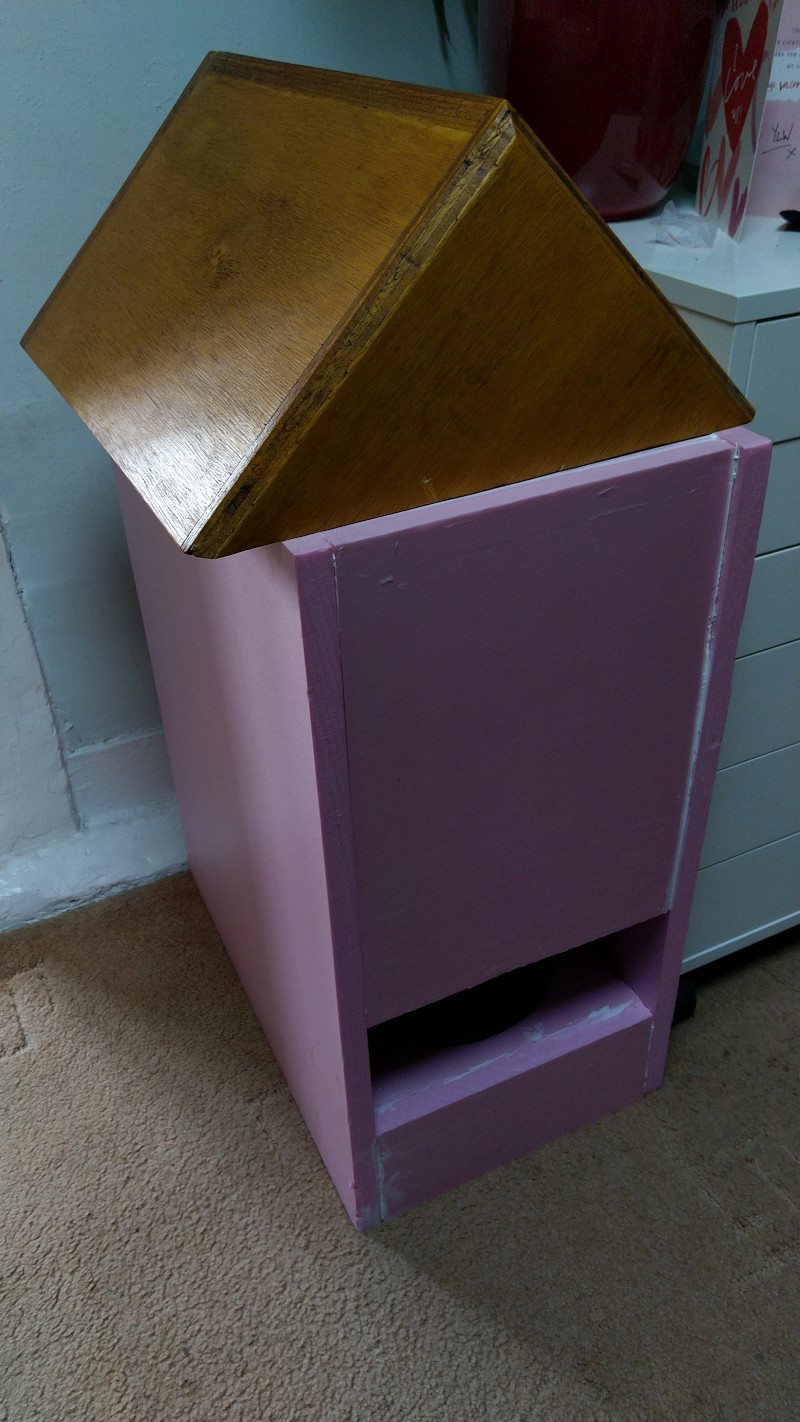

Well it's built and it sounds fantastic.😀
I've optimised the layout to use European 1000x600x20 xps sheets. Used Sticks Like Sh*t Turbo to glue it together and powering each speaker through a channel of a Nobsound NS-10G (TPA3116).
I'm pretty sure it won't take 120dB though without covering everything in pink foam snow.

Well it doesn't look like much.
That is a deflector from a Ron Clarke Austin on top to stop some of the panel vibrations
I've resolved to rebuild the sub. The way I did the bracing is completely inadequate - just a few random bits of foam here and there. I've seen many more pictures of sub bracing and will build it more robustly.

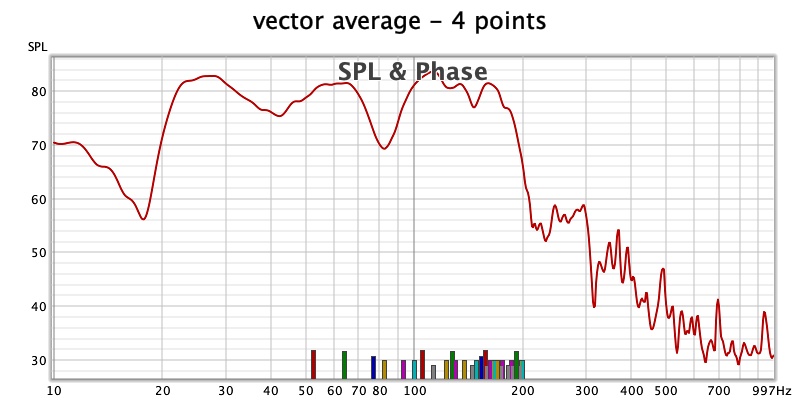

So onto the pics that matter.
Here is the the in-room response (room is 2.2mx2.3mx3.2m) unequalised.

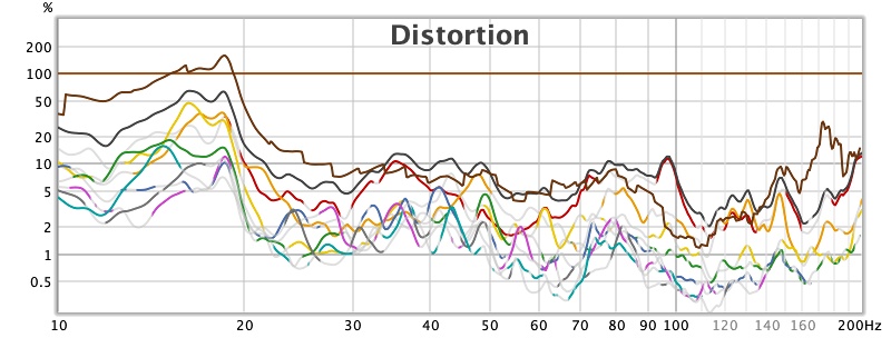

The distortion is pretty high which is unsurprising given the box is bouncing around and rattling a fair amount

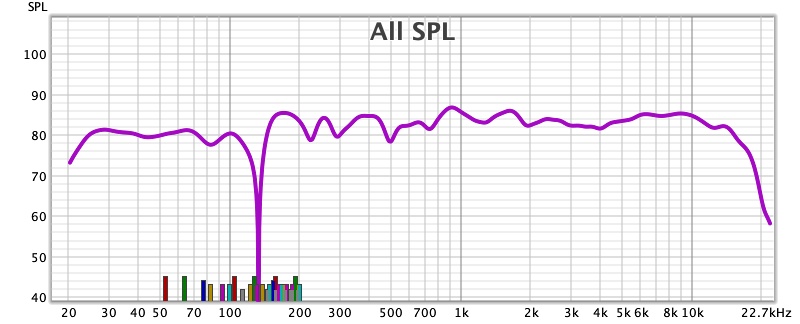

Here is there response in room response equalised with two tc9fd nautaloss speakers
Thanks for the data. Perhaps THD would be nicer if tested at lower loudness.
You say, "I've resolved to rebuild the sub. The way I did the bracing is completely inadequate - just a few random bits of foam here and there". With all the aggressive debates about (1) bracing and wall vibration and (2) stuffing, it would be truly helpful if you could do before-and-after tests as you modify the sub.
You'd have to establish exactly the drive signal, mark the floor with masking tape where the speaker and the mic were placed, etc.
A good way to find out if bracing is going to make any appreciable difference in before / after testing is to first measure the sub, then measure it again while you're sitting on it. Unless you're a very small person, your body weight should serve to damp vibrations quite a bit.
