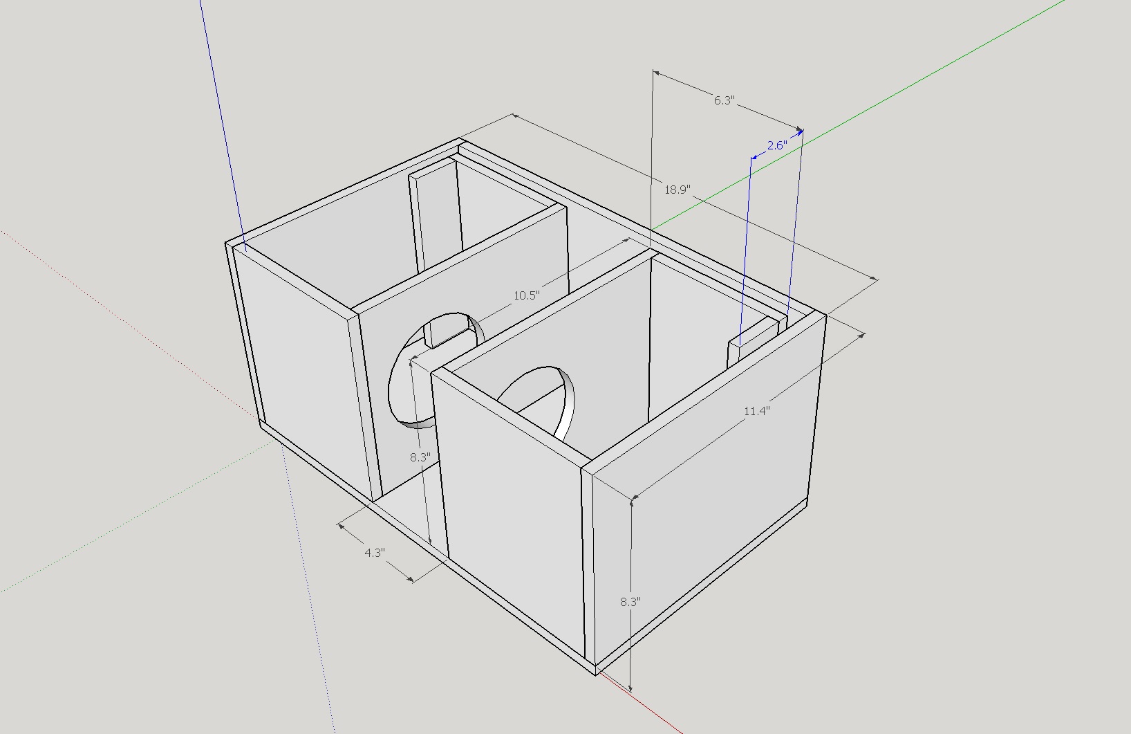

So, here is a first raw sketch according to XRK's dimensions, although in millimeters and "flattened":
That looks good. Maybe give the entrance to the wraparound vents a little more clearance at where they start inside the chambers.

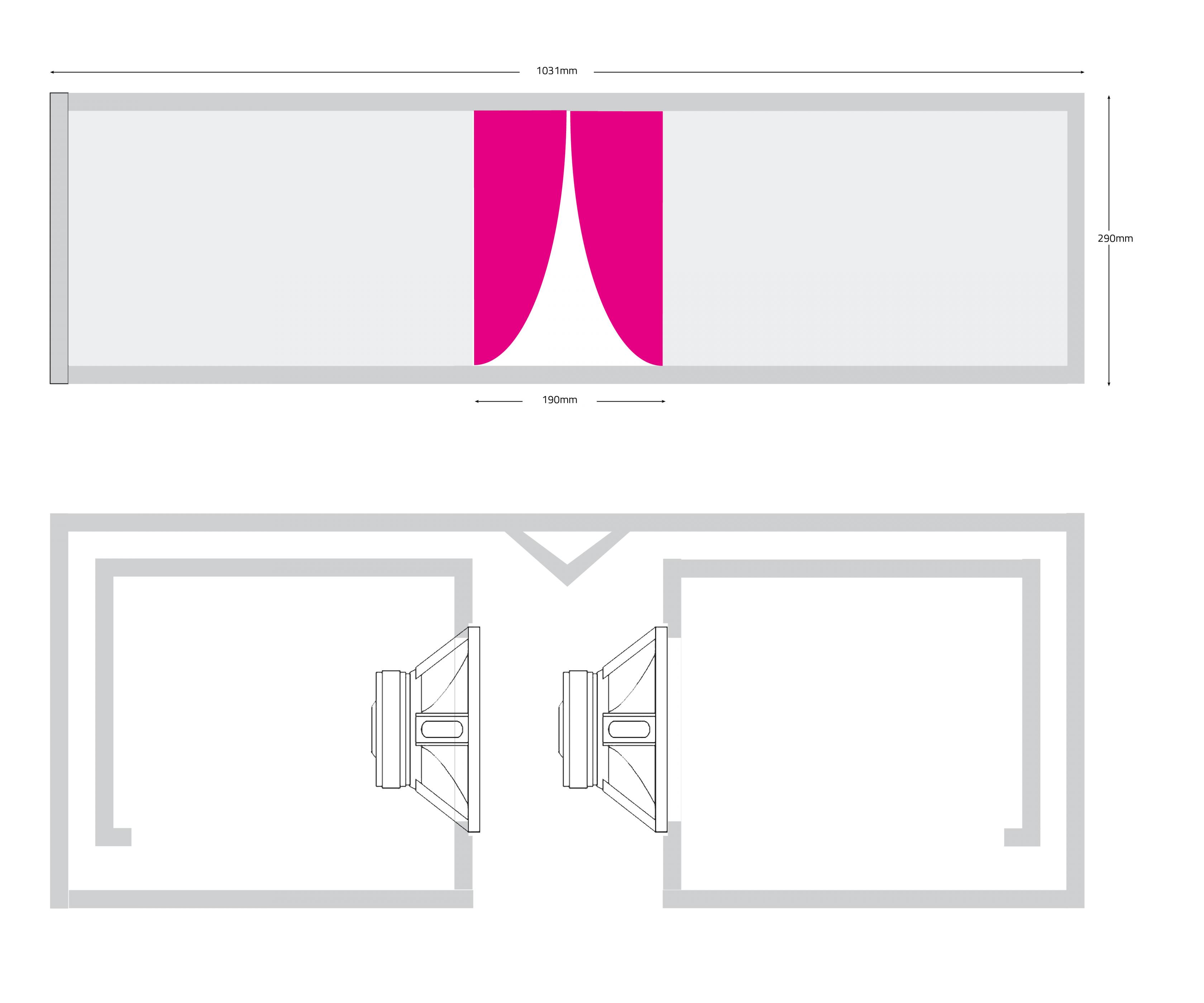

Like folding it once more?
Yes that looks good. I would make a triangle cross sectional shape bar (height of slot) maybe 2in deep at the apex and 5 in wide at base and place at the common duct joint. This will give smoother air flow out and reduce noise. Two pieces of thin angled ply works. Does not need to be solid.
Done 🙂

Would Karlson slots be of any benefit?Yes that looks good. I would make a triangle cross sectional shape bar (height of slot) maybe 2in deep at the apex and 5 in wide at base and place at the common duct joint. This will give smoother air flow out and reduce noise. Two pieces of thin angled ply works. Does not need to be solid.
Something like the attached? Just christened it KarlMivoc...
I really wonder what XRK and Freddi will have to say. 😛
The tuning would change. You need to calculate that slot area.
That's why I wonder 🙂
There is no benefit of a Karlson aperture in this case. It's needed to help disperse midrange to higher frequencies as an acoustic lens and to serve as a gradual impedance matched exit port on a transmission line. Neither of which you need here. It would just restrict your bass output.

Came across it while pondering what to do with 4 TB W5-876SD I have lying around. I've been wanting a nice portable system for outdoor use for a while, a pair of these should fit the bill. However for use outside I wanted to tune a bit higher, and maybe with a peak before roll-off.
I have never got to grips with Akabak and can't really figure out how the plenum dimensions affect the tuning of the box. BassBox and Hornresp don't seem to be able to sim it? Any chance of taking a look at these dimensions and checking they're not massively far out? Just over 8 litres in each chamber...Build will be 12mm ply...

What's the gap dimension on the wraparound vents?
