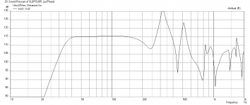

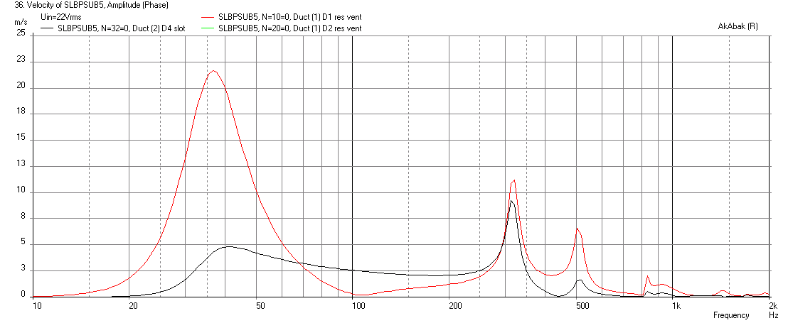

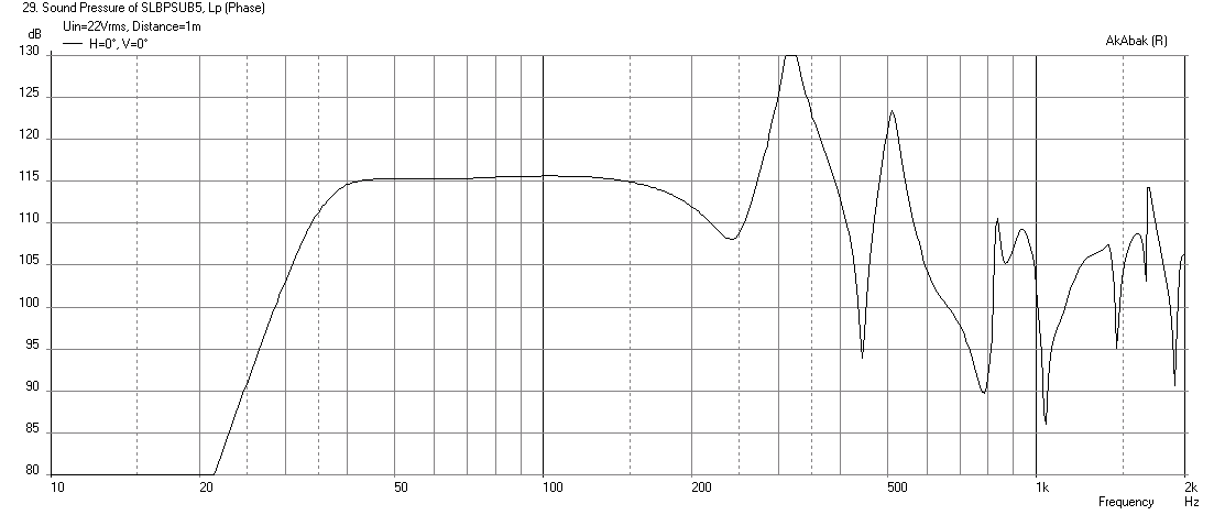

New design for murphmann drivers
I got a request from murphmann to design a slot loaded push pull band pass box with his drivers that have the following specs:
Sd=153cm2 | based on 5.5 in piston dia
Qms=3.1389
Qes=0.432
Mms=34g
fs=48.45Hz
Vas=10.48L
Le=0.286mH
Re=2.023ohm

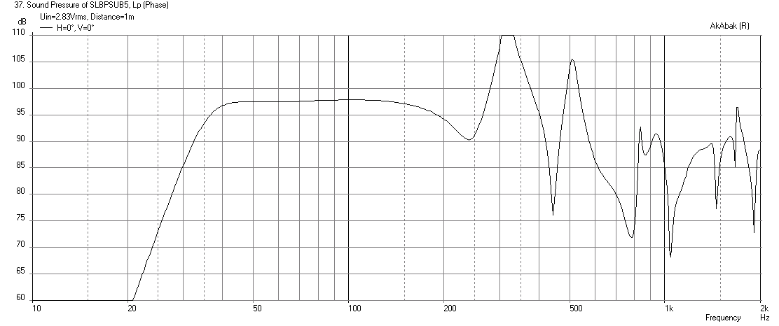

The design I came up with has -3dB point at 36Hz and good sensitivity in corner placement.
Deign is as follows:
Chamber volume for each driver is 12.5 liters
Main output slot with push-pull mounted drivers wired in series:
Slot_width=5.0 in
Slot_height=8.0 in
Slot_length=8.5 in
Dual resistance vents, dimensions for each:
Vent_width=0.5 in
Vent_height=8.0 in
Vent_length=14.0 in
Following sims assume corner placement for optimal loading and bass gain...
Sims also use 33Hz 24dB/oct HPF

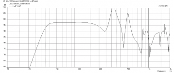

Here is the predicted SPL at 2.83v drive:
Here is the predicted SPL at assumed xmax of 5mm:

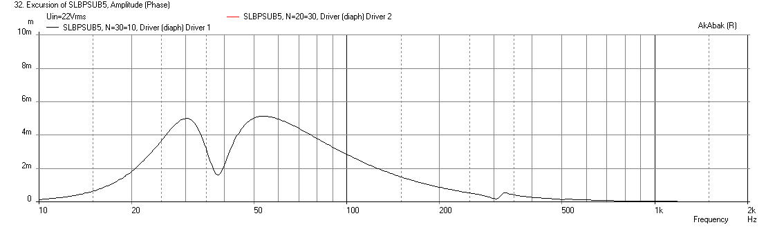

Here is the cone displacement at xmax (22 volts drive):
Here are the slot and vent max velocities at xmax:

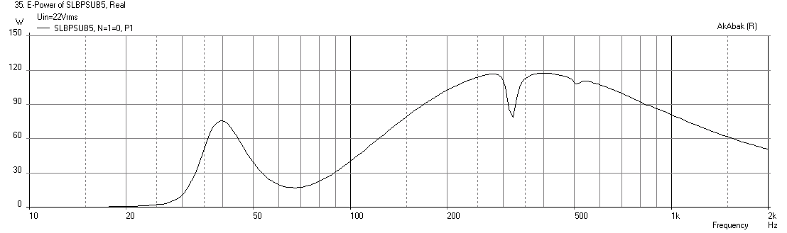

Here is the electrical power needed:

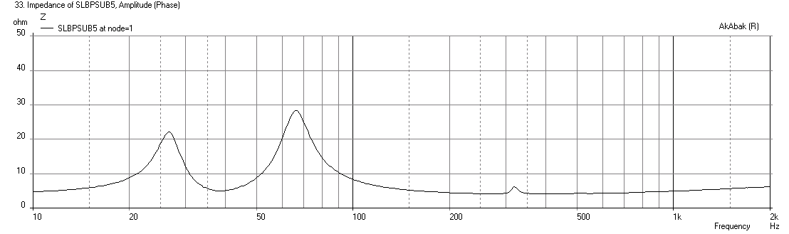

Here is the impedance that the amp will see:
