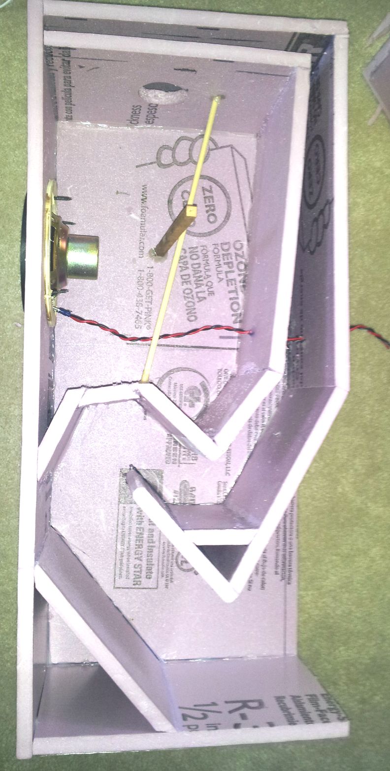

Great job on the foam enclosure. have you considered trying larger drivers?
Thanks! Yes, thinking of going as large as 8 or 10 inches. Of course those will probably require a thin plywood panel over the foam to support the weight of the drivers which will be pushing 6-8 lbs ea at that point.
What are the black rectangles in your box?
Those are actually grey colored open cell foam blocks. I initially put them in there to reduce the Q of the cabinet but found that I was losing too much bass due to the volume they take up so I ended up pulling them out. The sub achieved deeper bass (by about 5 Hz) and the flex on the foam enclosure provides adequate de-Q'ing damping I think. Currently they are running empty - no stuffing, no foam, no felt or fiberglass lining.

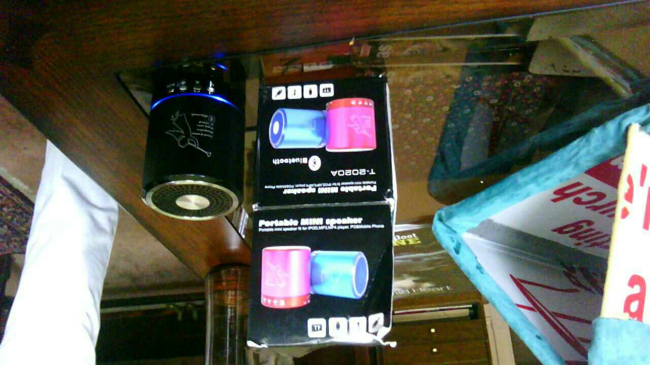

Impressive $25 speaker, can we build a DIY version that is not huge?[View attachment 428253
What is your question? Can we build a DIY version of the mp3 speaker in your photo? You can take the driver and amp out and put it into a larger enclosure and it will sound better. A Cornu would work. But that thing is already small. So don't understand your question of how to build it so it is not huge?
I heard this gizmo (belongs to a relative) and I'm impressed by the sound a tiny Bluetooth speaker can deliver. Rather than dissect the unit as some others have done in this thread I would like to build some thing for portable use that is a little more upscale. I am still working my way through the foam core thread (up to April 2013!) This would make a wonderful project for me. I probably won't do a spiral type. I don't have any precise design but I envision something that would fit under a standard laptop and/or giant Android pad (12.5 " screen). Portable is required, battery power is not. I think I'm drifting off topic of this thread; perhaps you can direct me to others? Thanks!

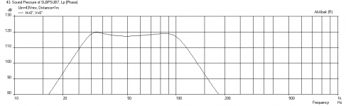

SLBP Sub with MCM 55-2924 drivers

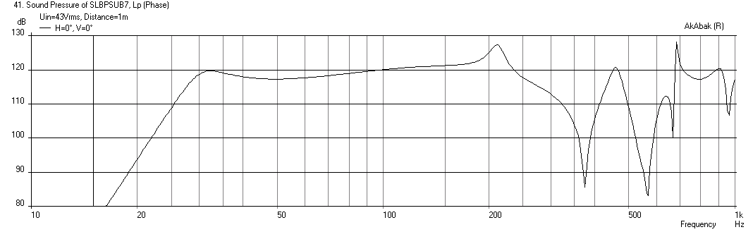

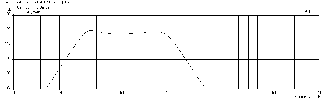

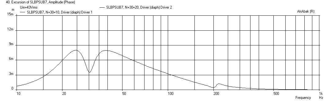

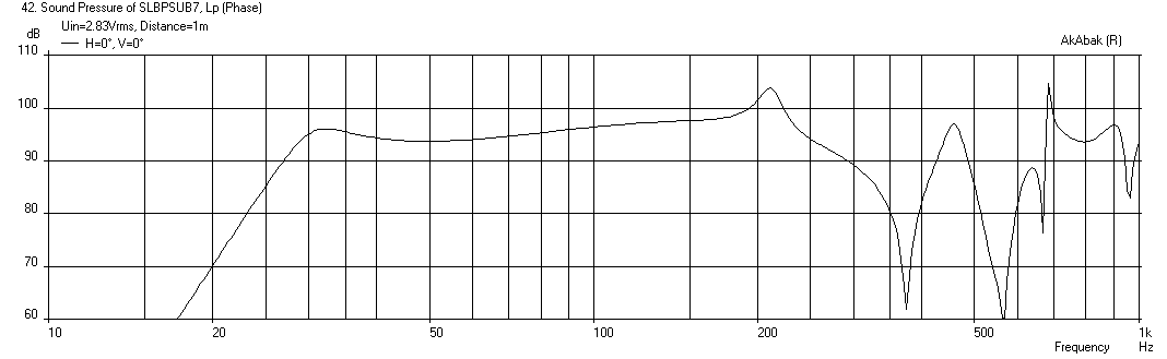

Design is with dual MCM 55-2924 drivers wired in series each driver has a 25 liter chamber behind it (approx 11 in long x 14 in deep x 10 in tall ea) with central 4.75 in wide slot x 10 in tall x 15 in deep slot fitted with push-pull drivers. Each chamber has a 0.5 in wide x 10 in tall x 15 in long slot vent feeding into the central slot port. Rough exterior dimensions of box is 25 in tall x 16.5 in deep x 11.5 in tall if using 0.75 in thick ply. If using 1 in XPS foam, size will be about +1 in all exterior dimensions. Use two layers of 1/8 in ply sandwiched (contact cement of liquid nails) with 1/2 in XPS for the driver cutout panels for wood screws to bite into. This sub has the ability to reach a true 30 Hz at almost 120 dB at 1m when drivern to xmax at 43 volts. I am using a 25.5 Hz -24dB/oct HPF to prevent cone over excursion. I know, it is not a perfectly flat response but this is preliminary and I can tweak some more. However, room gain and room modes will really mess with it and not care how flat it is now.
SPL vs Freq at 1 m in 2pi (no back wall):
Cone excursion at xmax:
SPL vs Freq at 1m in 2pi at xmax:
SPL vs Freq at 1m in 2pi at xmax with 100 Hz -48dB/oct LPF:

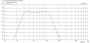

Tweaked MCM 55-2421 PPSL Sub

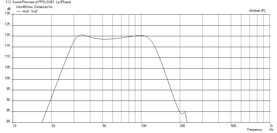

I tweaked the design some more to flatten it and to set the bass extension at 30 Hz (-3dB) while trying to minimize the volume to keep it small. To do this, I am using a corner room placement typical of how a sub like this will be used (in my experience) to give the added bass gain that enables a smaller box. The design ended up at 18.5 liters per chamber with 0.75 in deep x 10 in tall x 24 in long slot vents leading to a central push-pull slot-loaded vent that is 4.75 in wide (to fit drivers in push-pull) x 10 in tall x 10 in deep. A 27 Hz -24dB/oct HPF is used to prevent over-excursion and it has wide bandwidth up to nearly 200 Hz if you wanted to use it that far. I have opted for a 120 Hz -48dB/oct LPF that should let this integrate well with many systems (or set it lower if you want). Here is the predicted response at max drive voltage of 46 volts.
