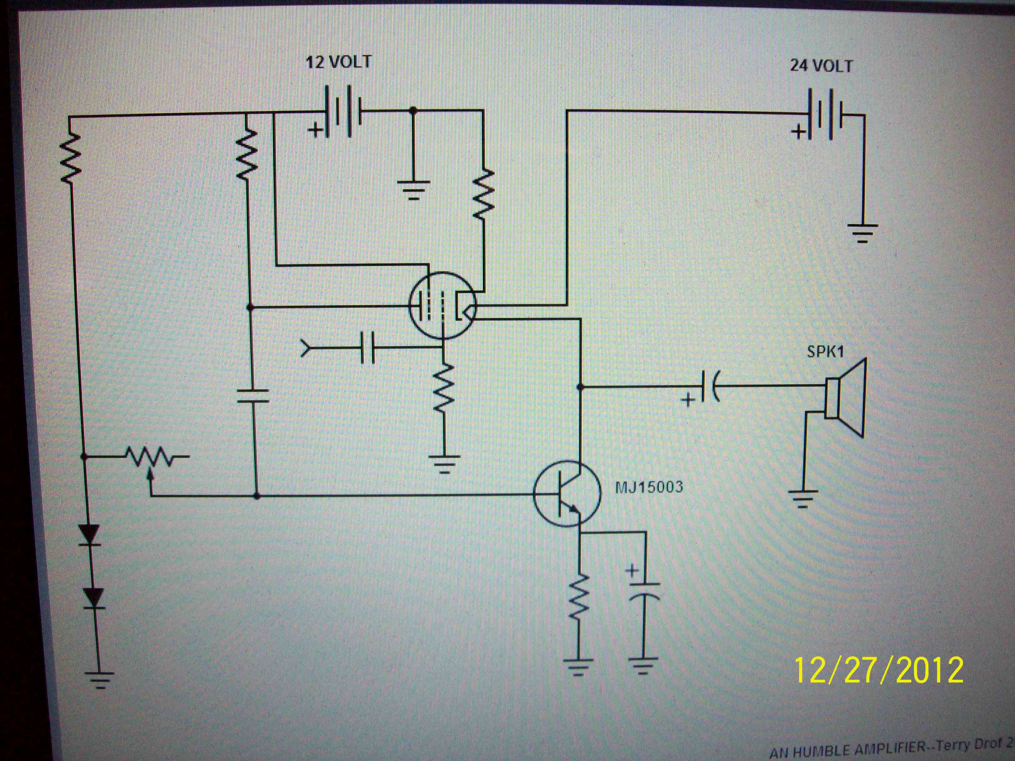

I have been working on this for a few weeks. The diagram isn't labeled for parts values but the tube is a 12K5 space charge tetrode and the setup is very straightforward. The sound was very good I thought, but this one was dismantled and another constructed in its place utilizing a 15CW5 and MJ15003 with a single 30 volt supply. When biased for 1/2 supply at midpoint you get the requisite 300 ma through the filament (heater). The sound is very good (to me). I worried about crazy feedback and/or regeneration effects possibly showing up but I can't recognize any sonic problems with this. Apologies to Pete Millett and his "Starving Student" headphone circuit. This was not intended to be a ripoff, I was just curious one night and it happened to work, before I stumbled on his circuit. I was looking for something "hybrid" for a table radio project that is ongoing. There is hardly anything new under the sun. Just posted this to confirm it does work. And works well IMHO.

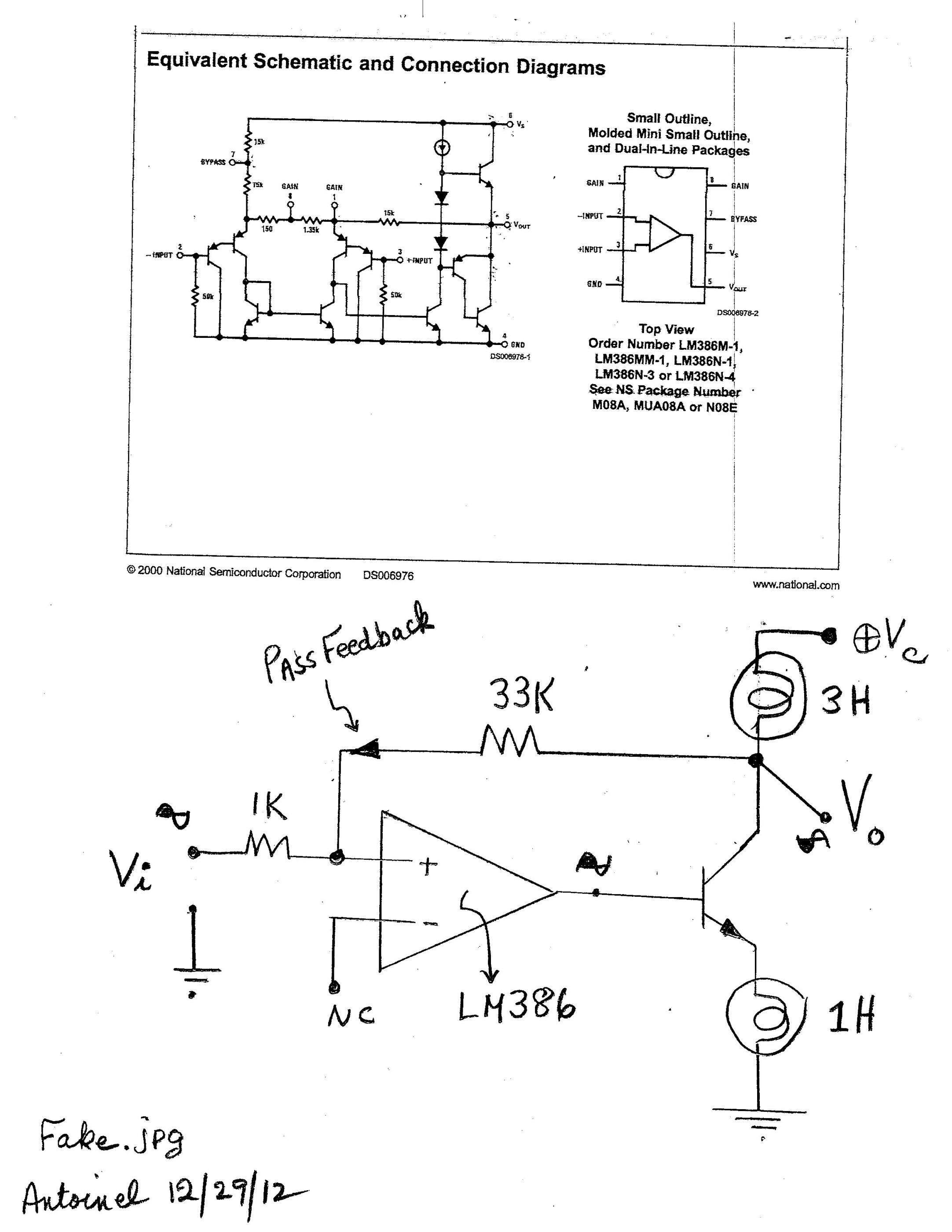

Hello wrenchone. L'Fake's Fake was put together with only bjts, operates in Class A and is low power; but has the key elements you taught in post #14, and more as bonus. The attached jpg shows its design components:
- The simplified schematic of the chip amp LM386 by Texas Instruments.
- The Fake's simplified schematic based on LM386, a power NPN, and incandescent bulbs using the heaters of the vacuum tube type 12AX7.
- Three 12AX7 heaters [3H] connected in series as collector load to the power NPN.
- One 12AX7 heater [1H] connected as emitter resistor
- Idle current through the power NPN is 0.3 Amperes; because the tube heaters are connected for 6.3 V service.
- Pass Feedback from the power output port [Vo] to the non-inverting input of LM386 which is a summing junction of two out of phase signals.

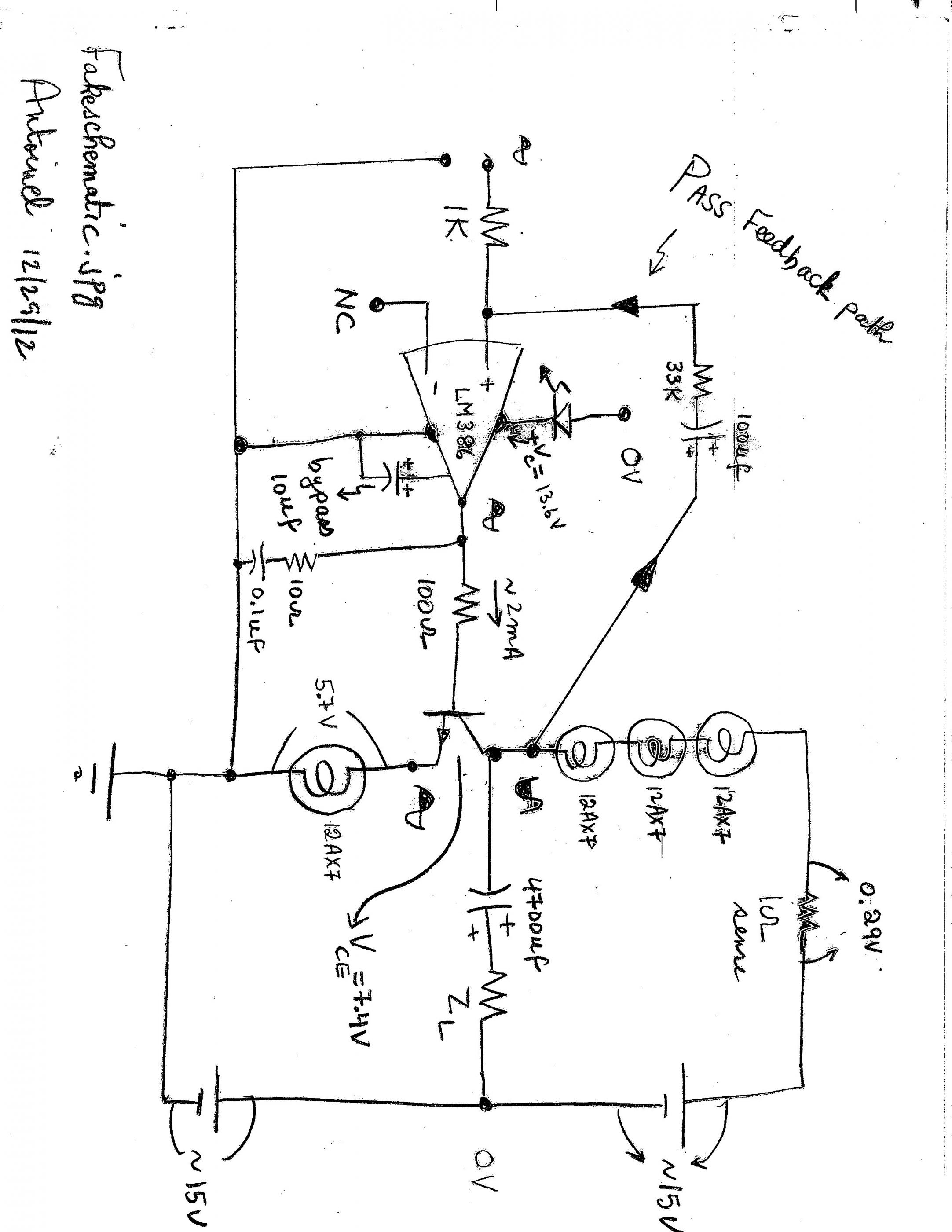

Here is a more detailed schematic of the subject in the attached jpg. Please note the following:

- A +/- 15 VDC dual power supply was used.
- The negative rail is signal ground; because the inputs of LM386 are referenced to it and not to the center tap [0 VDC; see its schematic by TI].
- The center tap of the power supply is 0VDC. It is the V+ power rail to LM386. I subtracted ~1.8 VDC from ~15 VDC by using the series connected LED as insurance so as not to exceed its rail rating of +15 VDC.
- LM386 is configured as recommended by TI [10 uF bypass cap, Zobel].
- Note the sense resistor [1 Ohm ] in series with the +15 VDC rail. The voltage drop across it is ~0.3 VDC or the idle current flowing through the output circuit is 0.3 A.
- Note the blocking electrolytic capacitors for the path of Pass Feedback, and power output

that Pass Feedback path is nothing else than overall feedback , common arrangement for inverting gain stage

I gave the nomenclature "Pass Feedback" to a specific type of overall feedback which emanates from a high impedance port [collector] to a summing junction which in this case is phase non-inverting. It is clearly different from that used in an inverting Op Amp; or a non-inverting power amp whereby the origin of the feedback [Black] is a voltage source or low impedance port. In semiconductor circuits, Pass Feedback [ also in L'Fake amp by wrenchone] is like that of Schade Feedback in vacuum tubes. Schade Feedback is not called Black Feedback!Antoinel
