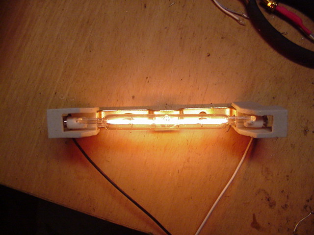

Ok, I grabbed a couple of pairs of the Feit Electric 500W normal duty linear quartz-halogen lamps. I saw no need to go for the extra duty "rough service" lamps (one lamp for the price of two), as this application isn't exercising the lamp anywhere near its design limit.
A bias voltage of 25V gets you 1.8A current through the lamp, and a cheerful orange glow, as compared to the dull red glow of the 300W bulb-type lamps with no iodine or other enhancements. Quartz-iodine lamps run hotter than normal incandescent lamps, as they're designed such that the iodine incorporated inside has a chance to do its thing and scavenge evaporated tungsten from the bulb inner surface. An added benefit is that the higher operating temperature shifts the output a little more towards the visible spectrum. Not a consideration for our application, but interesting nonetheless. If you want to eke out that extra bit of bias current, go for 2 X 300W lamps. If you want one lamp, 500W will work more or less, with a little bit less output power.

Here's what a 500W, 120V, quartz-halogen lamp looks like with 25V across it - the lamp is drawing 1.8A, and looks pretty bright. The lamp holder you see may be available in a well-stocked hardware store. I got mine off Ebay, as I've been busy/lazy lately(take your pick).
wrenchone, the yellow- orange glow is eye-pleasing. That is a hefty idle amperage flowing through it.Here's what a 500W, 120V, quartz-halogen lamp looks like with 25V across it - the lamp is drawing 1.8A, and looks pretty bright. The lamp holder you see may be available in a well-stocked hardware store. I got mine off Ebay, as I've been busy/lazy lately(take your pick).

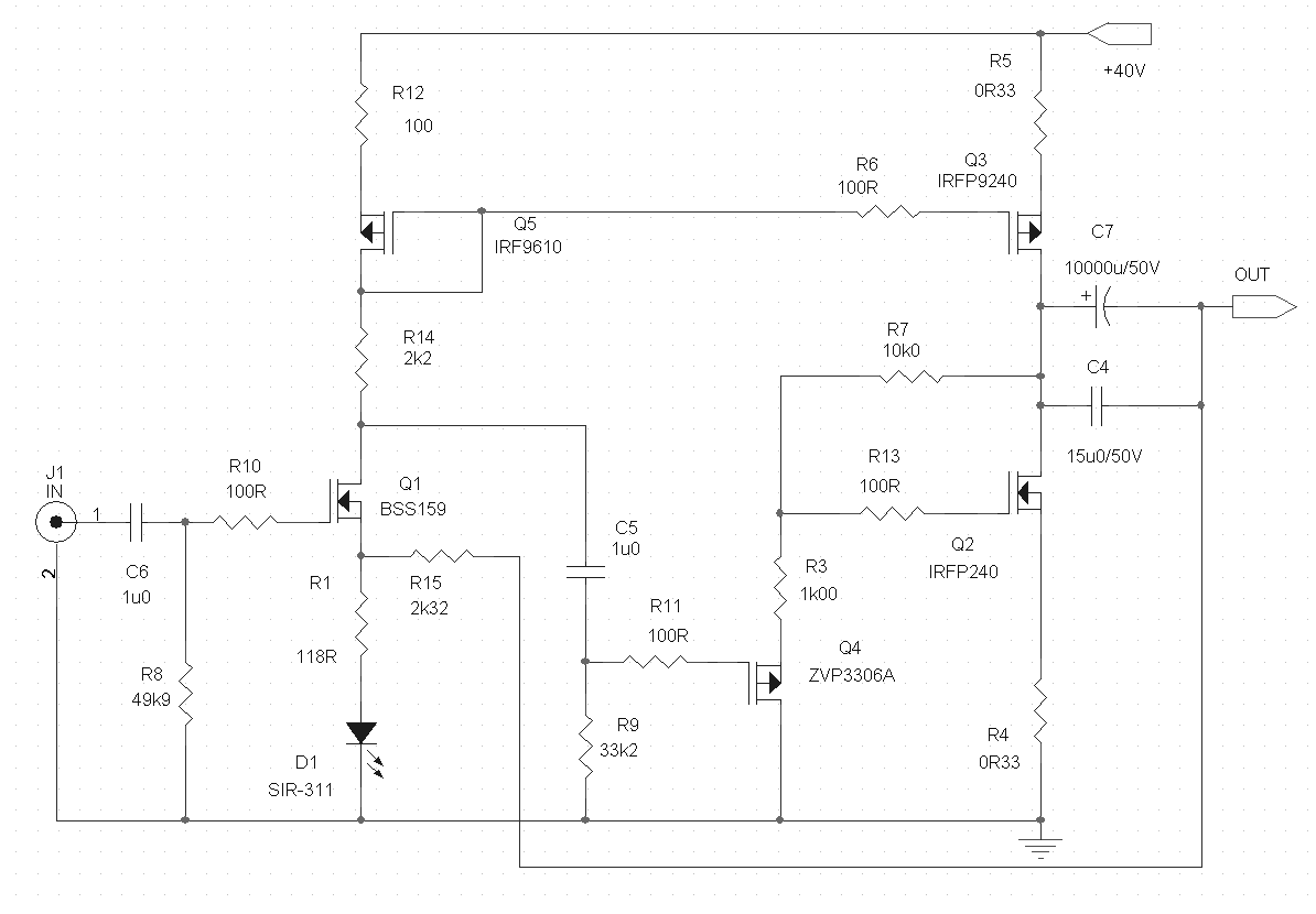

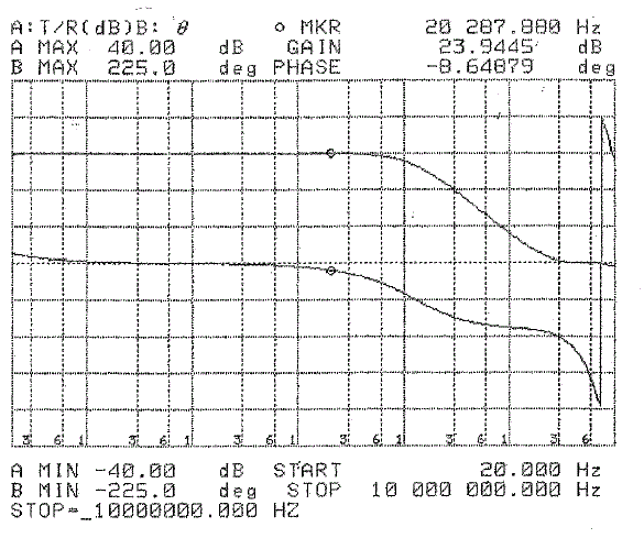

Here is the next incarnation of L'Fake, slightly rearranged and with fewer parts. It made encouraging noises when I fired it up in the basement and fed it with a CD player. I'm hauling the carcass in to work tomorrow to tweak the compensation and do a gain-phase plot. The compensation cap will go across C15 - there's none at present.

Is that a mosfet current mirror you are using as a load for the output? I am not sure this is the case due to the different devices, but do not understand the influence of Q5 on Q3.
THe ZVP33 is just a driver for the mosfet output(q2), correct?
It also looks like the output(q2) is schaded. Is bringing feedback from the output a way of schading input or is it just standard feedback. I hesitate to think it is CF, even though it is brought back to low Z source leg of input Jfet, but I am still a little fuzzy on that whole topic. Thanks. I enjoy your circuits because they make me think, as they are not often obvious for someone like me.

There's nothing wrong with an asymmetric current mirror. Both the ratio of the device sizes and the source resistors can be used to impart current gain. I use this concept a lot in my circuits. The input mosfet (depletion mode, BTW) drives both the current mirror and the output Schade pair, and in opposite directions. I originally used another ZVP3306A for the smaller half of the mirror, but changed it to a TO-220 device so I could easily couple it to the heat sink for bias stability. I may change it back if I can find a clever and easy way of coupling it to the output P-Channel. I could use the open loop gain.
The combination of Q2 and Q4 is an alternate way of doing a buffered Schade pair - the previous incarnation of L'Fake showed another. After this afternoon's experiments, I have a little more tinkering in line for the Schade pair, as I have realized that some more open loop gain can be wrung from it while still retaining output voltage centering.
This whole journey started back in 2007 with the "Half Nelson" amplifier, which utilized a Schade feedback mosfet before I knew Schade from a hole in the ground...
