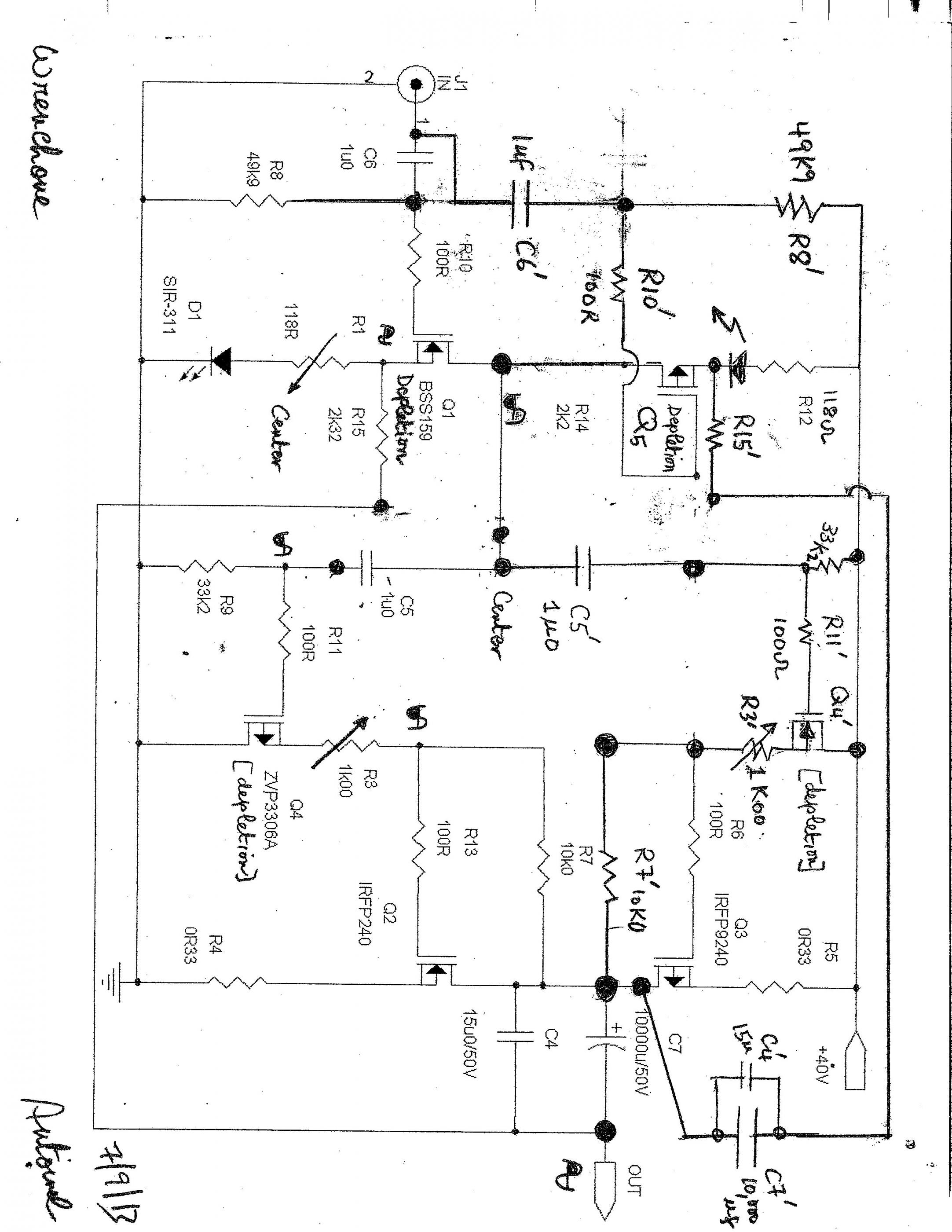

wrenchone, the attached picture was a paper exercise in which I converted your earlier schematic into a push-pull amp using complementary symmetry Mosfets throughout.
May I correct an error in the schematic above. I called Q4 and Q4' 'depletion" devices. Now I see they are actually enhancement Mosfets connected [e.g. Q4 per wrenchone] as modulated current sources.
If you want a good symmetrical amp, you should look at "Le Mutant" (do a search in the Pass forum). There's no Schade involved, it's all about modulated asymmetric current mirrors. It also sounds very nice, and has little to no output offset with no servo. This requires selecting the input diff pair rather closely, but thar's the breaks.
Thanks wrenchone.If you want a good symmetrical amp, you should look at "Le Mutant" (do a search in the Pass forum). There's no Schade involved, it's all about modulated asymmetric current mirrors. It also sounds very nice, and has little to no output offset with no servo. This requires selecting the input diff pair rather closely, but thar's the breaks.

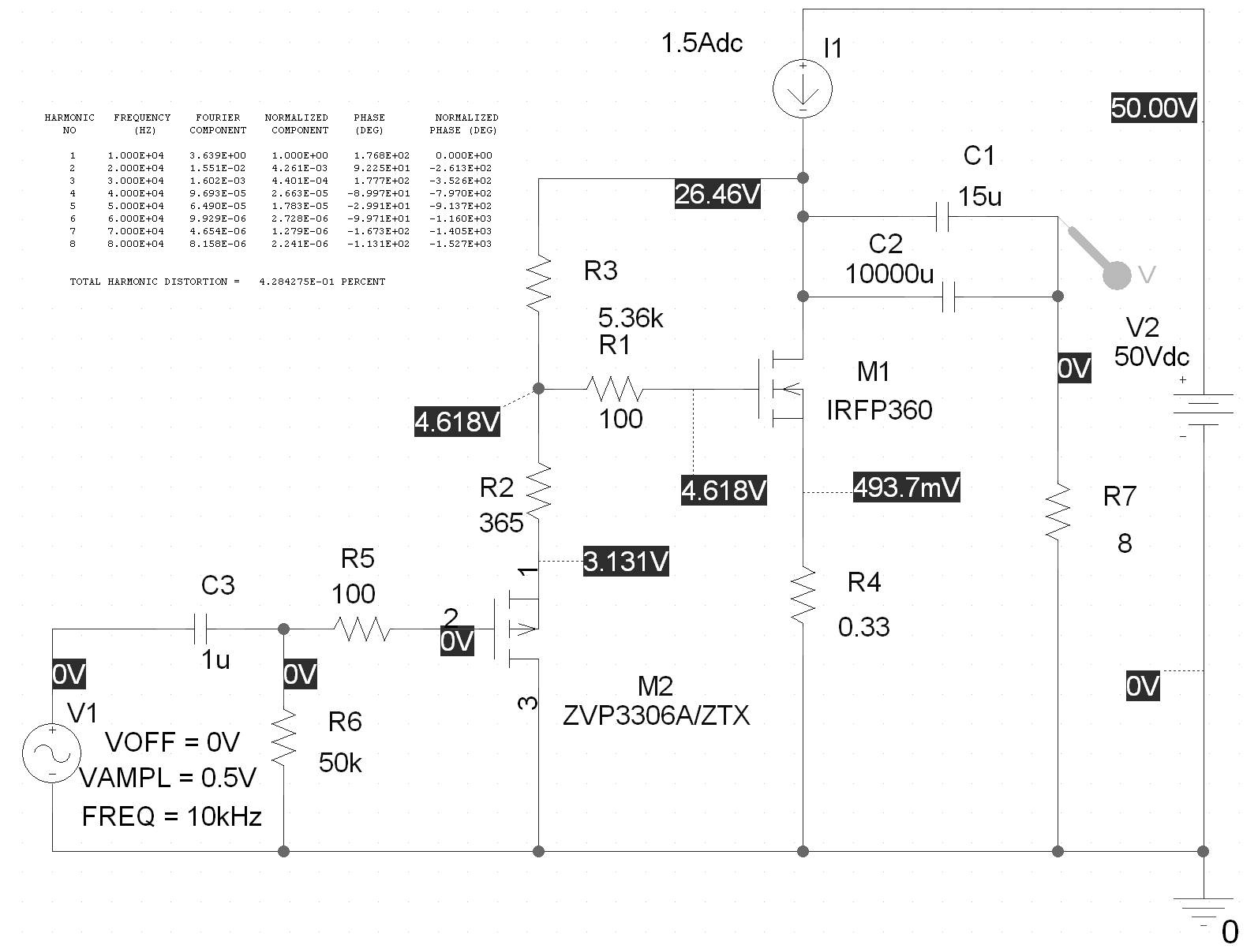

Attached is the fake SIT kernel of the previous circuit, all on its own and fitted with a static current source load. It acquits itself well, with a pretty clean-looking 0.4% THD, almost all (2nd and 3rd), for ~1W output. Remember, that first Watt is important... Gain is 7.2X, so the amp will need a preamp with gain to sing loudly.
I used an IRFP360 in the simulation, as it was the lowest voltage fet in my collection of models with a size 6 die. Any monster fet with voltage rating of >60V would likely do as well, though some tinkering would probably be needed to get the bias centered.
I would use one of the IXYS depletion mode fets for the current source load for a minimum parts implementation (three active devices - what's not to like?), but a ring-of-two current source with any respectable bipolar transistor and an IRFP140/240 would work just as well.
Food for thought, anyway.

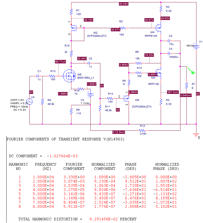

I was able to scare up a model for the BSS159, so I did some simulations. I'm moderately pleased with the results for such a simple circuit, especially as the high order distortion procts seem to be down in the mud compared to
2nd and 3rd. I need to take my bench prototype and shift the feedback point to the top of the resistor as in the schematic, instead of at the top of the IR LED - resistor stack. That may clean up the sound a bit.

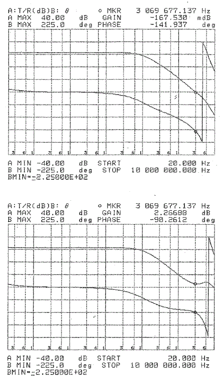

This afternoon, I ran a gain-phase plot on the most recent version of the "Fake SIT" amp. The results are appended. On both plots, gain is 8 dB/div, and phase is 45 degrees/div. Zero dB and zero degrees are both in the middle of the page (there are 10 vertical divisions, so the zero point is 5 boxes up from the bottom of the plot).
The bottom plot of the two shows gain and phase for the original amp. The gain (top trace) never reaches 0dB (it even peaks up a bit) before the phase (bottom trace) hits rock bottom, which is disturbing. This is in spite of the square wave response looking reasonably decent. This is an indication of an oscillation problem waiting to happen. Behavior like this explains why some amps might look benign on the bench, but take off and sing like a tree full of birds once they're hooked up to long cables and speakers. Another characteristic of a marginally stable amp appears to be excruciating sibilants, especially on voices.
The top plot shows the same amp with a 33nF + 10 ohm Zobel network hooked across the output terminals. The gain now passes cleanly through 0dB, and stays below it. There is only 39 degrees of phase margin, but that can be (and will be) amended with a change in compensation, now that the amp is behaving itself around the zero crossing. I intend to examine all my amps this way in the future.
This investigation also points out why an output Zobel network is a good idea.
BTW, none of this sort of squirreley behavior showed up in the simulations, which shows that you can only trust them so far...

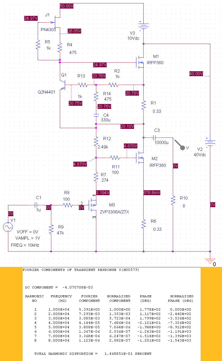

Just to stir the pot a bit, here's a zen-sh fake with a modulated current source load. Gain is about 5X, and THD appears too be a fairly linear function of output voltage, dominated by 2nd and 3rd. The results shown are a simulation with 1V input drive. A 0.2V input signal gives me 1/5 the THD, with a similar harmonic distribution. In practice, I would use the IRFP260 for the big output mosfets rather than the 360s shown in the schematic - those were the models I had available in PSpice.
