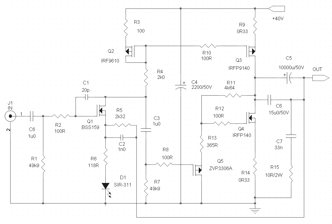

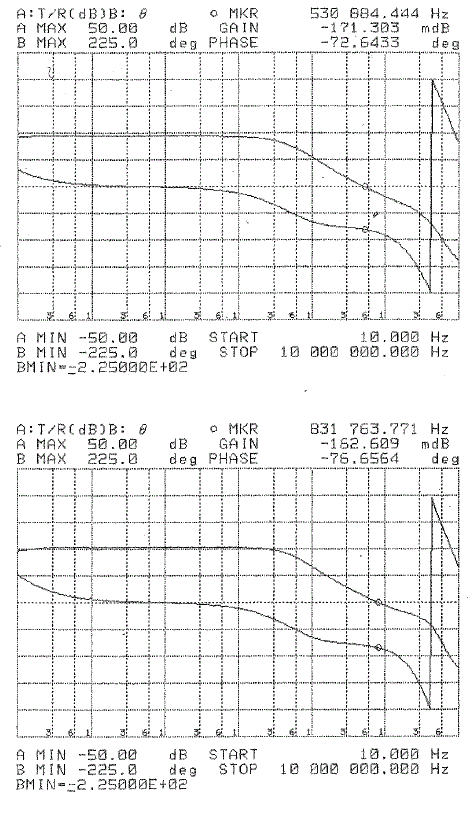

I finally got around to fixing up the gain-phase in the amplifier shown in post #131. Most of the corrections consisted of snipping out unnecessary compensation components. The two channels don't match all that well, though the gain and phase margins are quite adequate on both.
As per my findings so far, a Zobel RC network across the output terminals is absolutely essential for keeping the gain below 0dB after crossover. I'll look into the reasons for the difference between channels at some later date. For now, I'll hook the thing up to some speakers and see if I actually enjoy it. I'll post an updated schematic when I get around to it.
