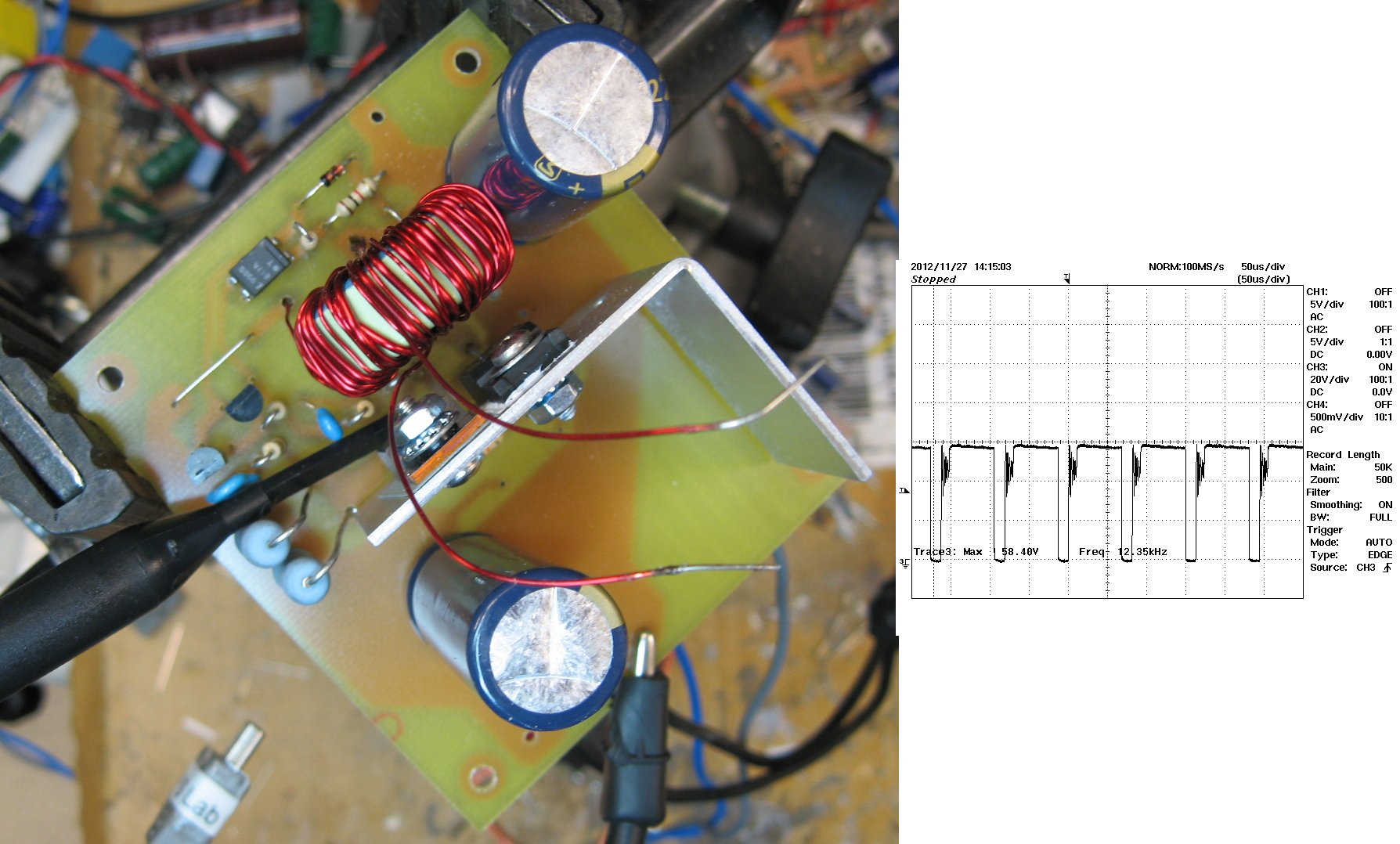

I started off with doing a discrete borderline discontinuous buck converter (shown in the previous picture) for voltage/current regulation duty for L'Fake Lite to counter the nasty inrush current from the light bulb load seen at startup (it blows mains fuses - not nice). Nelson suggested unscrewing a couple of bulbs before hitting the "on" switch, but I want a more smoothly integrated solution than that, and after all, I am supposed to be an SMPS engineer in the glaring daylight hours, no matter what I do when I climb back into the coffin...
At any rate, the self-oscillating RCC solution has issues with repeatability, as well as relatively high levels of output ripple current and peak switch current, so I devised an alternate solution utilizing a discrete hysteretic buck regulator that has lower peak currents and ripple. I will post when ready, but my proto in its initial stages show 89% efficiency and lower ripple current. When I achieve more consistent operation, I'll let the cat out of the bag...

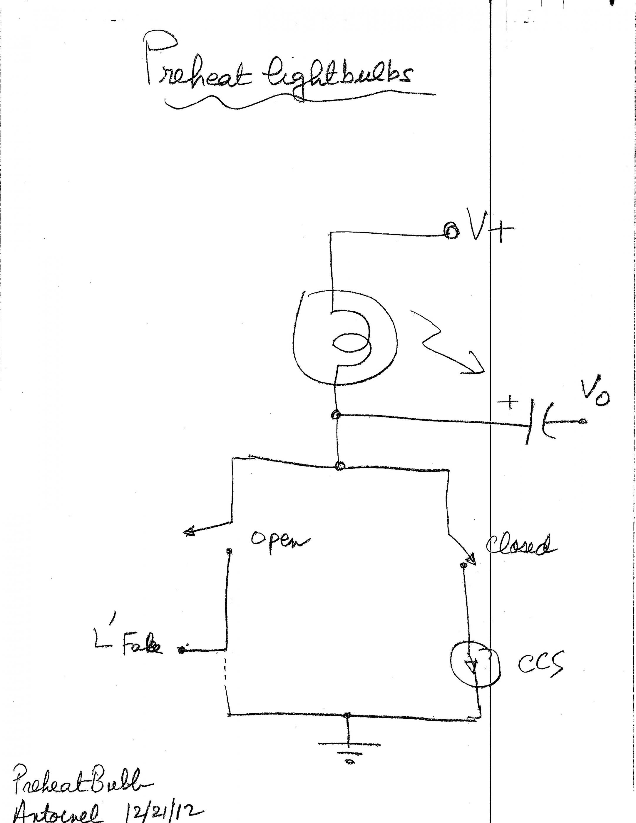

Hello wrenchone. A possible solution maybe to preheat the lightbulbs by lighting them at low intensity in a standby mode as shown in the attached diagram. The mechanical switches are ganged such that L'Fake is [Off] in the [On] Standby mode, and reverse. The CCS is intrinsically a hi Z load to L'Fake, and can be enabled continuously by deleting its switch.
Kind regards
Kind regards

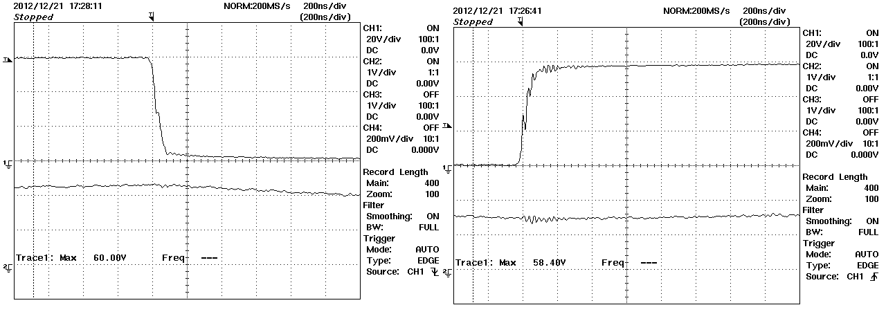

The voltage/current regulator is still a work in progress, but results are getting encouraging. Attached are the rise/fall times of the buck converter output voltage waveform. I may place a little bit of resistance (just a few ohms) in series with the gate of the switching fet to clean up the rising edge of the switching waveform.

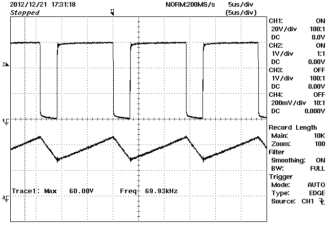

Attached is a picture of some of the operating waveforms for the regulator. The operating frequency is a little high - I want it to be around 60kHz at max load~4A. Shown here is the waveform at 2A load. The top waveform is the switching waveform at the input of the output inductor, and the bottom waveform is the output inductor, these two waveforms give one insight into operating frequency, duty cycle, programmed current hysteresis and the overall health of the converter. The circuit is designed around an LM393 dual comparator, a cheap readily available single-supply device that has the ability to sense near ground. A faster comparator with more output drive would be a good thing, and the LM311 is a possible candidate. I may need to add a negative rail to its supply voltage to make it behave. Efficiency is around 89%, including the losses in the toroidal transformer driving this regulator.

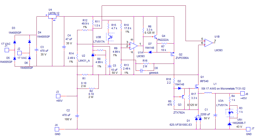

Attached is a prelim schematic for the hysteretic buck converter I'll be using to power L'Fake Lite. It's based around a commonly available comparator (LM393). The converter sits on top of a ~60-65V rail and is biased with a floating winding that happens to be on the same toroid I'm using for the main power. A separate small transformer could also be used.
Floating the regualtor on the DC rail makes current sensing relatively easy, but makes drive a little problematic. The regulator could also sit at ground with the current sense in series with the return leg, but there are stilll issues. I also like to keep the return uncluttered. Let's just say that there are several ways of accomplishing this, none without issues. Drive transformers are out, as I want to operate pretty much up to 100% duty cycle.
Transistors Q3 and Q4 are used to speed up the drive. Q1 is the main switch, and was what I happened to have hanging around. There are some Infineon parts with much lower on resistance I might try when I get around to ordering some. Diode D1 is a 30A 100V Schottky. There are large bulk caps stationed before and after the regualtor.
Resistor R16 provides the comparator hysteresis that make this thing work. Gimmick C6 provides overdrive at the edges of the switching waveform. This goes a long way toward cleaning up the switching waveform. I suspect a ~2pF NPO disc would work as well, but a gimmick can be twisted together from some hookup wire in a jiffy (I used some wire wrap wire), and works just fine.
As this is still a work in process, expect a few changes. I'll probably do the ultimate start-up test tomorrow to test this circuit's ability as a current regulator, but right now, it functions just fine as a high power voltage regulator.
