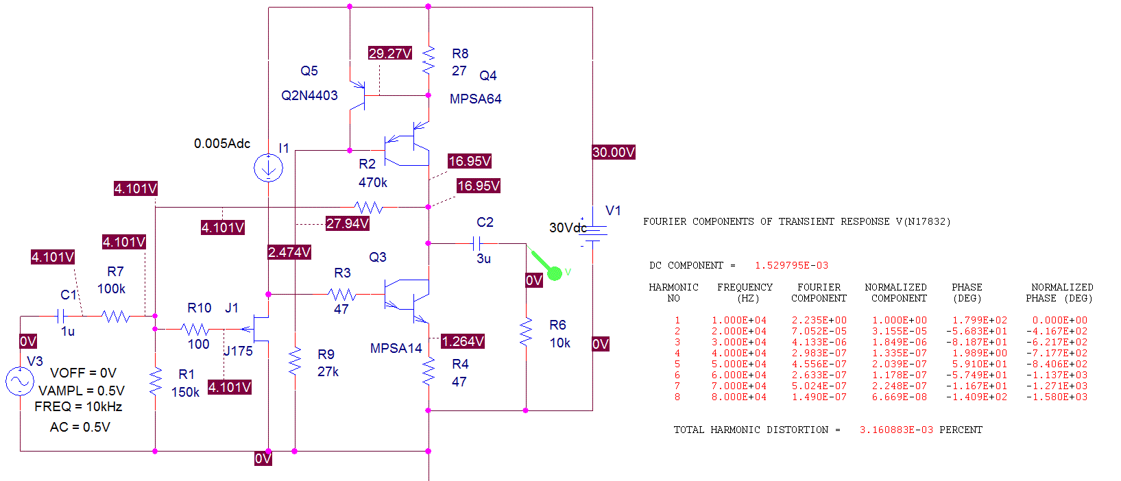

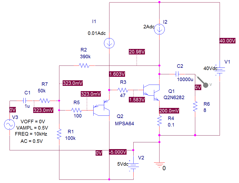

Because... A Darlington would be interesting to try - it's been in the back of my mind. I'd want to try a simulation first.
Thank you wrenchone. Please do a simulation; it'll be mighty interesting. I'll send a hypothetical schematic; my humble contribution. best regards.Because... A Darlington would be interesting to try - it's been in the back of my mind. I'd want to try a simulation first.
Please ignore schemo. It is flawed. I'll clean up.Thank you wrenchone. Please do a simulation; it'll be mighty interesting. I'll send a hypothetical schematic; my humble contribution. best regards.
Thank you Zen Mod. I'll clean up first the schematic above. It is not right.at least one important resistor is missing

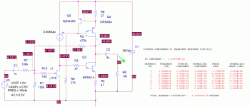

Attached is a sim - food for thought. At the excitation level shown, THD is about 0.08%, mostly 2nd and 3rd Order. Gain is ~8X. You need a small negative supply to properly bias things, but so did the original SIT circuit.
Thank you wrenchone. You are way ahead of me. Will it demonstrate the classical triode characteristic curves? Your schemo is worthy of prototyping. Will it sound like a triode amp?
My "too late" schematic is attached for completeness. My apology for naming each bjt and simultaneously showing its emitter arrow. Best regards.
The Darlington should have a pentode-like characteristic (current-driven rather than voltage driven), but with more tilt than the mosfet solution. The Schade-connected implemenntation with buffer will still have triode-like characteristics.
wrenchone: You have expanded the range of Schade Feedback in the preceeding posts to inclute the forgotten bjts. I hope that this approach continues to be new, unprecedented and practical. Triode-like sound which is mediated by bjts may become a common occurence in our diy world.The Darlington should have a pentode-like characteristic (current-driven rather than voltage driven), but with more tilt than the mosfet solution. The Schade-connected implemenntation with buffer will still have triode-like characteristics.

I did a little messing around in PSpice this afternoon, starting out with a current source loaded Schade cell using Darlingtons. If there is no buffer, the distortion into a 10k load is about 0.3% overwhelmingly 2nd & 3rd harmonic . For grins, I tried tacking on my usual p-chanel jfet buffer in front, with the results shown here. I was surpised by the drastic reduction in distortion with the buffer in place.
Edit - in practice, I would use parts in the TO-92L package for a little extra dissipation, as I'm running about 25-26ma of current in the output Darlingtons. The ones I have hanging around are the MPSW45 and a Fairchild TO-92L version of the MPSA63. This might make a nifty little lineamp if you don't mind the signal inversion.
