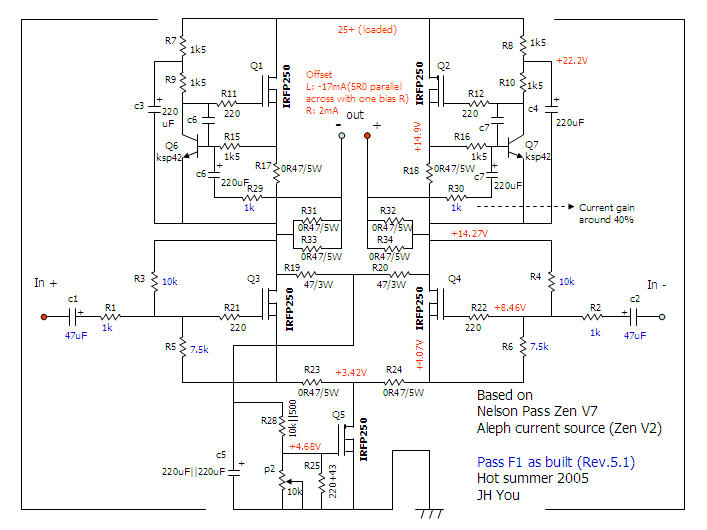

Removed P1 and placed 1k5 . . .
Offset L: -61mV R: 2mV . . .
Then, attached 5R0 across one bias R . . .
Offset L: -18mV R: 2mV . . .

Here is my final version of Pass F1 . . .

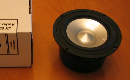

Drivers arrived . . .
Small and cute . . .
Hm . . .
Reading J-Low article once, twice . . .
I feel that the low frequency gain from the horns is probably too much . . .
There could be a possibility to reduce down the gain somewhat with a smaller horn . . .
But, awkward estimation might results in a disappointment . . .
Hm . . .
I go with the original . . .
When I have flooding of bass, I could control it without re-building the horn . . .
But, if . . . if I meet drought of bass . . . No, I don’t want to think about it . . .

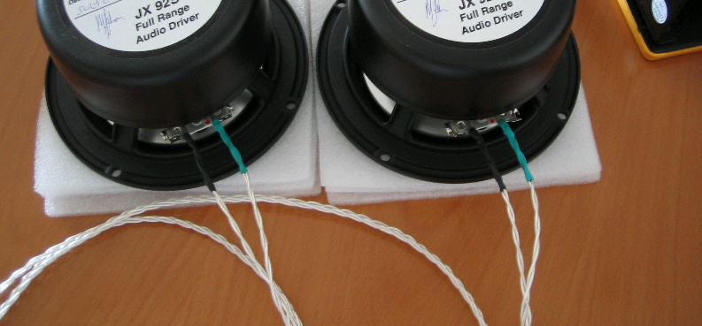

In general, I do not like to use silver-plated wire in my audio system . . .
It often causes negative effect in top frequency sound . . .
If the top frequencies are the small irregular waves on the lake, the silver-plated wire would be a sharp sun shine on them . . .
My eyes easily become tired . . .
However, for my new system incl. F1, the sun shine boosts positive effect and does not make my eyes tired . . .
Just more beauty on the scene . . .
I replaced all wires with the silver-plated . . .
And, I go with the same wire for JX92S . . .
