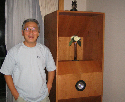

I'm so pleased.
I played with the J-Lows for nearly a year, but I always have
to make room. The El Pipe-O's and Kleinhorns were donated to
an artists colony in Oakland, where I hope they will all be happy.
In point of fact I am always on the lookout for worthy recipients
of old projects (read: speakers, amplifiers and parts), but it is
difficult to find victims. I inveigled Wayne into taking the J-Lows.

JH,
Your J-Lows looks great... Congratulation!
Love that funky name plate design.

To me he looks happy.
Great job, JH
Say, how many diy amps and speakers do you own at the moment? Must be a lot.
/Hugo
Great job, JH
/Hugo
jh6you said:and shy
Your posts read all but shy, JH6You.
Looks lovely, jh6you can do my furniture any day.
Very interested in hearing the end-verdict, JH.

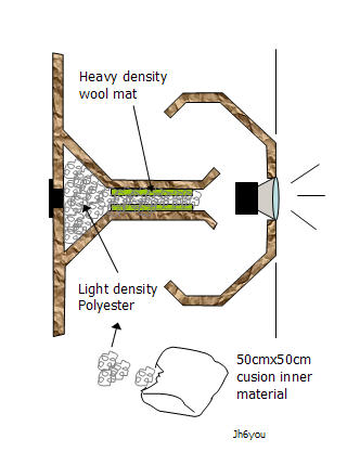

Kept smile on my face all day. . .
Looking at the small belly buttons on big J-Low bodies . . . smiling . . .
And, I visited the 6 moons F2 review . . .
Reading there about the 2nd and 3rd harmonics commented by the critics, and reading the same things commented by the master . . . smiling . . .
At first, the big J-low horns had monotonic look.
But, with few flowers on the shelf in the upper mouth,
the big bodies started to change into nice figures . . .
End-verdict? Still I have way to go further.

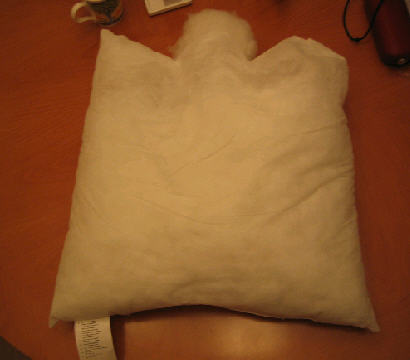

I’m experimenting subtle changes of the acoustical low pass filter (stuffing the chambers) and the elec. single pole high pass filter, expecting these subtle changes would soon converge under a better destination.
Now, I’m staying at the single pole high pass filter of 0.1uF+20k R at 80Hz. And, for the acoustical low pass filter, I replaced most part of the sheep wool stuff with the polyester equivalent. How much? I bought two 50cmx50cm inner-cushion polyesters from Ikea. I used 75% of them each (additionally to the remaining wool stuff).
Listening to Best *audiophile* Voices, which I bought by chance, Mmmmmmm . . .
Very good recording . . . and nice 15 songs . . . all 15 songs . . .
Regards
jH
jh6you said:And, for the acoustical low pass filter, I replaced most part of the sheep wool stuff with the polyester equivalent. How much? I bought two 50cmx50cm inner-cushion polyesters from Ikea. I used 75% of them each (additionally to the remaining wool stuff).
was meaning this.
Regards
jH
jh6you said:I bought two 50cmx50cm inner-cushion polyesters from Ikea. I used 75% of them each (additionally to the remaining wool stuff).
Leftover.
Regards
jH
