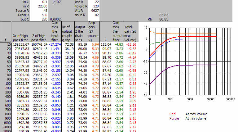

What I should do . . .
Since the environment doesn’t allow me for room tuning, I should focus myself on stuffing and, if necessary, installing high pass filters or others . . .
In case I need high pass filters,
I sketched a method of high pass filters during last weekend . . .
It’s integrated into BOSOZ . . .
Would like to show it here . . . expecting any question or opinion about any improvement. . .
Regards
jH
O . . .
I exercised some math too, as shown on the next post . . .
The red curve on the chart is a gain curve along the frequencies at maximum output volume . . . Meanwhile, the purple curve is at minimum output volume . . .

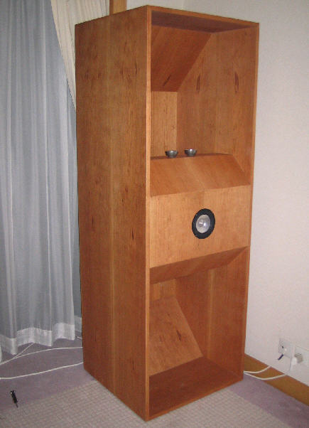

Sorry, J-Lows are no longer in my possesion, but I guess you
could call it a folded-folded horn.

Hi Variac
Sh . . . . . . pls . . . my wife is a wild cat . . . sleeping . . .
I should take stealthy movements . . . 😉
Soon, I’ll see what happens, first, with no door . . .
Regards
jH

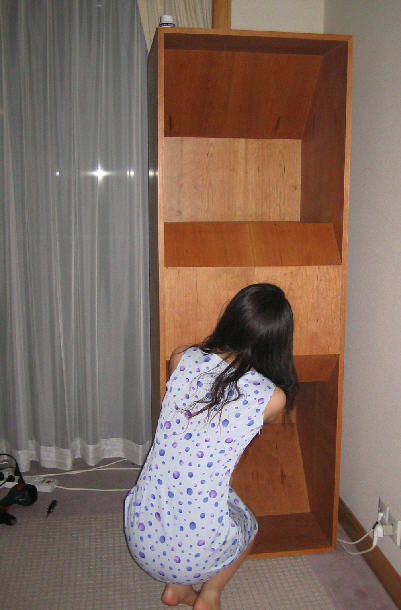

How to begin the stuffing inside the chamber . . . ?
How much . . . mmm . . .
"Hey, come here."
"One . . . two . . . three!"
"A~hhhhhhhhh h h h h h h . . . "
"Again . . . here we go . . . Yi . . . er . . . san!"
"A~hhhhhhhhhhhhh h h h h h h . . ."
Regards
jH
Looks ok . . . ?
Looks terrific, you are one of many talents, JH6You.
Nice bottom end on the J-low too.
I have filled in the chamber behind the driver with wool lightly.
And, I insatalled 0.1uF+24k single pole high pass filter at the input of BOSOZ. These are all I have done.
O my . . . the sound kills me softly.
Smooth. Sweet. Warm. Nice dynamics.
I know the sound of tube+Altec A7 and tube+Lowther horn. The sound from the BOSOZ&F1&J-Low combi is different from them. It is really wonderful! I wonder why Nelson has given up his ownership of J-Low . . .

Hi, jacco
Thanks for encouraging me. I’m thinking to print the name on a gold plate. I hope I could manage the plan materialized.
Hi, Variac
The lovely girl is the same one who I mentioned about at post#1.
Sound wonderful . . . really . . . killing me softly . . . particularly at the first watt.
I feel CD sounds like LP sounds that I have missed long years. I want to bring all CDs collecting dust at home. I want to make them shine.
Low pressure bass coming out thru the four mouths has enuf volume, and well matches with my rather small room size. The original plan I had was to convert my F1 to the original Pass F1. I will, however, reserve the plan until I meet another good motivation for me to do it.
