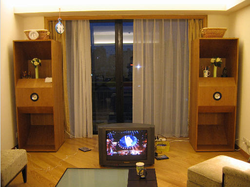

The single pole high pass filter has developed to 0.1uF+15k at 106Hz. And, I have finally soldered them firmly to the input of the BOSOZ. In addition, I have prepared two resistors of 22K and 47K rated at 20W for the R0 in parallel with the driver of J-Low. The R0 has been to get certain effect in Qes and to even out the driver’s impedance peaks. I have preferred 47K to 22K. I have found that the sound has been getting somewhat drier and thinner with 22K.
I have tried these mainly to tune the bass level, considering my W3.7mxH2.7mxD8m room.
At my normal listening level, this BOSOZ/F1/J-Low system does not offer the body-massaging bass. But, they offer deep, wide and clean bass fully filled in my room so that I can imagine the deep and wide space of the music stage. I don’t need any room tuning. Yeah . . . this is a good merit I can be rewarded by this system. Whenever I want, I can tune the bass level, and with no consideration of any additional head-ache room tuning for different room sizes.
Easy, smooth, sweet and warm . . . among other undesirable things if any.

One more trial . . . 33R for R0, and finally soldered it into the firm fixation.
Hmm . . . now it seems that the bass tuning is done to my taste.
My taste? I do not pursuit the body-massaging bass. Occasionally, I might want to have body-massage, and I could have. It is, however, good only for short time--no more than 20 minutes. Longer? I just start to get a pain.
I love deep, wide and clean bass notes in good amount.
Playing the BOSOZ/F1/J-Low system, I have got the deep, wide and clean bass notes in good amount, surprisingly not by more digging in the lowest frequency, but by finding a proper roll-off in the low frequencies. It might sound strange to you.
Regards
jH

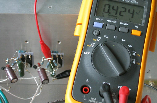

Here is what I'm trying at the same time:
1. Variation of high pass single pole filter at the input of BOSOZ
2. Variation of bias current of F1
3. Variation of active current gain of F1
4. Variation of stuffing J-Low
5. Variation of resistor values in parallel with JX92S
Wao . . . already five items. And if each item has five variations, total . . . wao . . . It's a long and winding road. It might take minimum one year . . .
Anyhow . . . it's fun.
Hi Nelson,
I have one question. While I understand that mosfets like higher Drain voltages, I can not understand why they like higher bias current too. Simply for low distortion . . .? It depends . . .? Could you give me a brief explanation?
For your info. at present I set the bias current of F1 down to 1.093617A (active current gain is about 45%) and kept it few days. The sound is still very good for me. Anyhow, I look forward to hearing from you about your view. Sorry for making you repeat the same(?) answers.
Best Regards
jH

Again, here is what I'm all doing:
1. Variation of gain of BOSOZ
2. Variation of high pass single pole filter at the input of BOSOZ
3. Variation of bias current of F1
4. Variation of active current gain of F1
5. Variation of stuffing J-Low
6. Variation of resistor values in parallel with JX92S
And, here is where I am now:
1.
The gain is slightly more than unity at maximum. This is to get low but enough signal input voltages to the input of the F1 for my home listening. Probably, I could consider a passive pre instead. According to my experience, however, the passive pre in general gives me the sound of clean dry flower. Therefore, I always prefer active pre which could give me the sound of healthy real rose. Another merit from the active pre is that I could switch it to various gains other than unity whenever I want.
2.
I fixed it at 105Hz.
3.
Thanks to Nelson's explanation, now I understand the major role of bias current, and I have got self-confidence in playing with it. I ended up with the bias of 1.093617A as measured across the 0r47 bias resistor. I reached to this point, by adding 75K R between the base of the current source transistor and the plus side of the 220uF bootstrapping cap. The sound is wonderful.
4.
I estimate that I get the current gain at about 45%, which is similar as Aleph 3. I didn't try any other value this time. Based on my experiments earned from the old projects, I see the 45% is within the most optimistic range.
5.
I filled in each chamber with one and a half of the 50cm x 50cm sofa cushion stuffing polyester. To find the suitable stuffing, I tuned it, listening mainly to voices of female singers and voices of movie sound track. This job is most difficult part among others for me. I'm really sweating lot. I might try more variations until I'm sure of the safe arrival near to the desirable quality.
6.
I tried 47R again to compare with 33R. I got a final conclusion with 47R. I brought it inside and soldered it directly to JX92S.
Hm hmmm . . . I hope this info will be useful for you, diyers.
Regards
jH

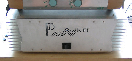

Here is new face plate of F1.
For heat sinks to contact with room air more.
I can touch the sinks with my bare hand more than 5 seconds.
Making the face square is a common rule . . .?
I hope I didn't violate it . . .
F1/J-Low, not picky . . .
Wonderful for different types of music . . .
And for old and new CDs . . .
Good involvement in human sensitivity . . .
Regards
jH

Did it actually change the temperature of the amp? I find that hard to believe, but then again it never occoured to me to make such a test.
Magura 🙂
Magura 🙂
Hi Magura,
I don't believe either.
As you might know better, there are many factors, and all factors heavily or lightly affect the heat. Unfortunately, my poor English impressed you as if the low heat were all simply due to the new face. But, it's not true. 🙂
Regards
jH

For short, I came back home where I have X-Zen V2 and 3way 97dB horn speakers.
While my co-pilot went out shopping to prepare nice diy welcome-home dinner, I momentarily did a simple tweak of the X-Zen V2 to X-Zen, removing the Aleph current source and reducing the bias current down to about 1A. This was to get my own experiment of the first watt sound through the combo of the 3way high efficiency speakers and the X-Zen. (Main difference between X-Zen and F1: X-Zen has resistor tail and is a voltage amp, while F1 has ccs tail and is a current amp.)
I eagerly wanted to see how the sound would change with the X-Zen of no Aleph current source and the reduced bias. Surprisingly, the sound was still loud and wonderful. 😀
It was an exciting experiment . . . and nice diy meal . . .
Wondering how the X-Zen will go with J-Low . . .
Regards
Regards
jH

Likely, the final tuning of the system
J-Low
47R has been finally chosen and soldered in parallel with the driver to smoothen the impedance curve of the driver. Each chamber has been filled with two 50cmx80cmx10cm (pillow inner stuff) polyester.
Pass F1 (voltage amp version)
The bias current has been set to 0.9A (see the picture showing the bias voltage across Source resistor of 0R47). With this low bias current, I get two advantages. First, I get low heat sink temperature rising about 18 deg C above room temperature. Second, I get the input capacitance reduced due to the reduced open loop gain (reduced transconductance) so that I get better quality of top frequencies. But, I get one disadvantage. It is, as Nelson has earlier indicated, that the transconductuce has been reduced. This must imply that the amp gain has been reduced too. To compensate this, I have increased the closed loop gain (and at the same time got the effect of reduced negative feedback).
This kind of low bias current might be not acceptable to the advocators of high bias. 😀

J-Low
