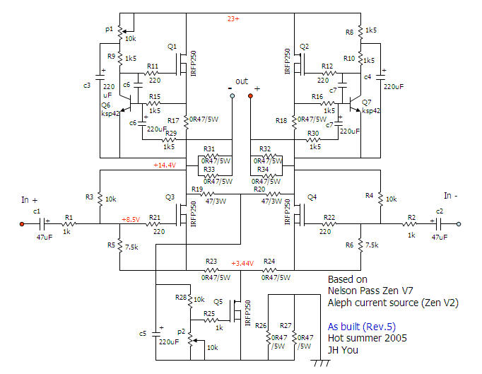

Doesn't matter . . .
Whenever necessary . . .
Can change Aleph current source to ccs easily . . .
There is good flexibility . . .
I will start with R3/R4 with 10K.
R1/c1 and R2/c2 will switch their positions.
R1/R2 will be 2K for about 14dB gain.
c1/c2 will be 47uF.
Input impedance would be low.
It's not my concern.
Output impedance . . .?
I don't know.
The Aleph curent sources would reduce it.
Because they provide negative impedance, acc. to Nelson.
I will try to drive ordinary speakers.
And will see.
Any of your comment?
Appreciate it.
Regards
jH

LED on . . . its location is not final tho . . .
Measured . . .
Rail : 23V
Drain voltage, gain mosfet: 14.4V
Gate voltage, gain mosfet: 8.5V
CCS drain voltage: 3.44V
All other paths similar values . . .
(R5 and R6, not 8.3k, but 7.5k)
Offset: 5mV/34mV
No turn-on turn-off pop noise . . .
Dead quiet with no signal . . .
Sound . . . ? 🙂 🙂 🙂
Do I really need the efficient single drive speakers . . . ? ? ?
I'd like to wait until the new smell is washed off . . .
I will come back . . .
Only concern is the gain is somewhat low . . .
I might reduce R1 and R2 from 2k down to 1k.
Or, I might increase the gain (unity at maximum) of my BOSOZ . . .
Nelson, which way do you recommend?
Regards
jH

Changed R1 and R2 down to 1k . . .
Now the gain is enough . . .
I find that the circuit is the same as Zen V7 . . .
Except that the 8 ohm loads are replaced with Aleph current sources . . .
and that the subtle tweaking in btm ccs . . .
I wonder mine is still a current source amp . . .
Or a voltage source amp . . .
Or in the middle . . .

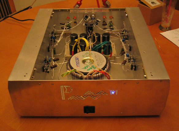

Regret . . .
I should have built two . . .
One for Pass original and another for mine . . .
Mmm . . . I can hardly give up mine . . .
I think that Nelson has built his F1 for demending owners.
He has considered even the LED completely turning off.
Bleeder . . .
And, safety . . .
I could say only this: "Nelson is Nelson."
Now I feel free to post mine as built.
I think it must be a voltage amp.
BOSOZ (of abnormal form) drives this amp.
And, the amp drives nominal 4ohm 90dB speakers (paper corns).
I feel noise level is very low.
All different music frequencies are clean and well forcused.
And, pleasently tight . . .
Bass starts from many steps behind and runs to the front.
I feel the damping factor must be low.
It seems, however, working positive way.
I will test more with different types of music and try to post about my feeling . . .
[jH
Looking at the schematic it appears to be.
But good if you like your variation. Happy hearing😎
jh6you said:Now I feel free to post mine as built.
I would suggest that you try lower values for P2, R25, R26.
You will note that I used low values in order to compensate for
the capacitance of the bottom current source. We note that
Mosfet's capacitance becomes greater and more non-linear
as the Drain-Source voltage gets low, and a lower impedance
in these resistors (so that the gate sees 100-221 ohms) will
improve the high frequency performance, particularly with single
ended input. As you are using a balanced input with BOSOZ
(perfect match, I think) this is less of an issue.

Removed R25, R26 and R27.
Lowered R28 and P2.

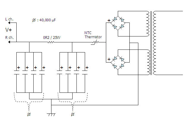

Removed the thermistors located between the bridge diode and psu caps because I found a problem there . . .

Suspected the npn transitors (ksp42) . . .
Replaced one of them . . .
Now okay . . .
Remeasured all nodal voltages . . .
Exactly to my expectation . . .
