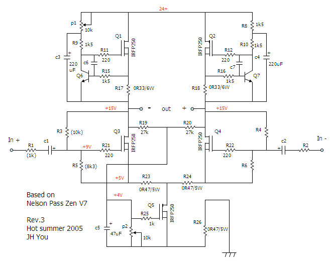

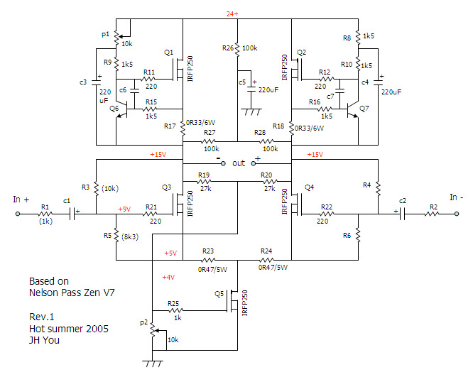

That would be rms. You guys are getting closer, but there
are some subtleties you've missed, and the circuit will not
work properly as shown.

D1 won't last very long connected directly to a +17V node. The Gate of Q7 will be biased into full-on conduction. Unfortunate consequences will ensue.

When the Q-point voltage goes up,
how I could turn the bottom ccs off . . . ?
Damn it . . .
There's no such thing as too much enjoyment of subtlety.
When the common mode DC value at the output goes positive,
you want to increase the current on the bottom ccs.
Grey
D1 is at less than 5V.
See, JH?? You were wrong, yelling at me😉 You really sounds like my ex-wife😀 😀Thanks, Nelson.
Steen😎
jh6you said:I hope this will work.
I hate to disappoint you, but it will be unstable. Go ahead
and build it, and by the time you discover this, I will have
published the circuit and it will be a quick fix.

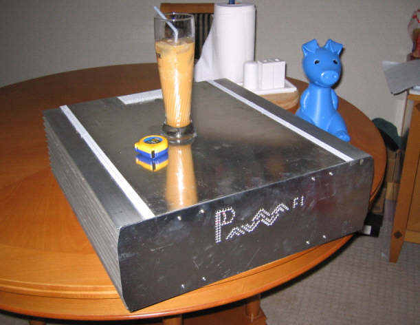

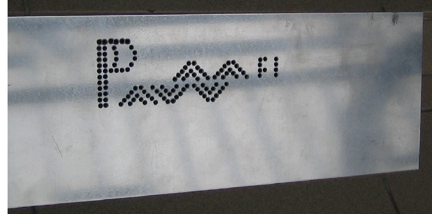

Drilling holes . . .
All at the same time . . .
And, made too many mis-holes . . .
It's ok . . . I will use them as air holes connecting inner space to outer world . . .

Great work jH! Myself, I try to hide my mis-placed holes by making decorative patterns that incorporate them. I then pretend they were intentional. Delusion can be a wonderful tool when employed correctly.😀

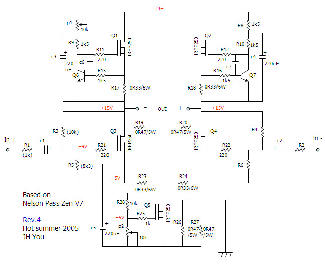

This Rev.4 will be the last post of my circuit before Nelson shows us his original F1.
R19||R20 / c5 / R26||R27 are for stability of drain voltages . . .
I estimate that 220uF is big enough to be the by-pass.
Nelson, could I apply Aleph current sources instead of the upper constant current sources?
Regards
jH

jh6you said:Nelson, could I apply Aleph current sources instead of the upper constant current sources?
Yes.
Also, I think you meant 47R0 for R19 and 20.

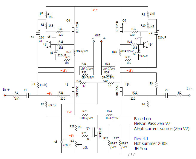

I change mind . . .
One more schematic, Rev.4.1 . . .
I will have Aleph curent sources . . .
Further discussion will refer to this Rev.4.1 or post #100 . . .
It resembles my X-Zen V2 . . .
Which I like very much . . .
Would like to give a first name to this F1 . . .
Aleph F1 . . . ?
Of course, the family name is Pass . . .
Best Regards
jH
