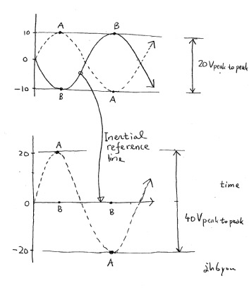

I think it's safe to say that a 10W (presumed RMS) amp would deliver something on the order of 20Vp-p.
Look at it this way. The fundamental topology is a differential. To a first approximation, each side of the differential can travel from the absolute DC offset of 13.8VDC up to the rail, and probably a similar distance down. Nelson said the rail is, what, 25V or so? It's in one of the threads, somewhere. For the moment assume 25V. Okay so that means (quick fiddle on a calculator) a little over 11V up and about that same voltage down. Given that it's a differential, both of these are occuring at the same time, just as though two kids were going up and down on a see-saw. Subtract a little for housekeeping for the CCS up top and you'll end up with a number fairly close to the 20Vp-p figure.

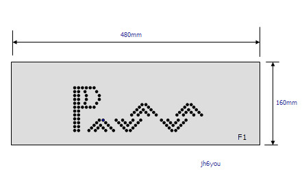

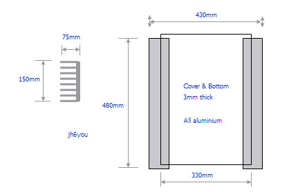

Here is the box dimension I will build soon.
I think I can get the size of heat sinks easily here.

Is it very late night there . . . ?
Or, I am smoking too much . . .
As you says, while "A" side go up to 10, "B" goes down to -10.
So total difference is +20 from "A"'s point of view.
And opposite direction -20. Mmm . . . +/-20 (=40p-p?)

We are thinking about the same.
You: It's either +10 and -10 or -10 and +10.
You: It's either +20 and 0 or 0 and -20.
