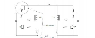

I think that F1 is a single stage circuit.
I believe that I could adjust the DC offset rather easily even if I use unmatched gain mosfets. I am considering one of two ways.
(1)
Having one adjustable resistor in the load current source system.
(2)
Or, having one adjustable Rgs.
As Nelson has said many times, I should first adjust dc offset at cold operation condition, then, adjust once again at warm condition.
I think that method (1) would assure me the stable dc offset.
Am I too optimistic . . . ?
Could you please give me wake-up call . . . ?
Regards
jH

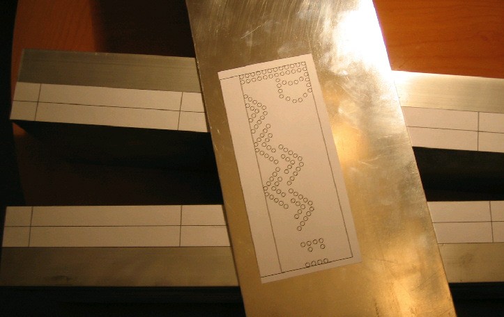

Heat sinks arrived . . .
Trafo will come soon . . .
O! I changed mind . . . It will be one 20-0 20-0 800VA, sized 152mm dia and 93mm high . . .

Hmmmm... here goes your wife again😀 I would mount the feets of your amp on the faceplate🙂 Otherwise, you could have trouble dissipating the heat😉Heat sinks arrived . . .
Steen😎
Heatsinks arrived ..........
Hallo jh6you ,
very nice kitchen(Heat)-Sinks
in Class A - Modus you can grilling very easy 2 T- Bone Steaks !

I can't understand what are the causes of the unstable dc at drains.
The Vbe varing with temperature in deck ccs could be one reason.
The gate voltage of the bottom ccs must be stable so that it could not be a concern. But, the drain voltage of it could vary, as you say, so that it could be another reason, and probably this would be the most concern.
If so, could I sense the varying darin voltage and cure it in simple way? Could you give me a tip?

Hint: Assuming that you're using a half-way decent CCS, it's not the one under the differential. The voltage is supposed to vary. It's constant current, not constant voltage.

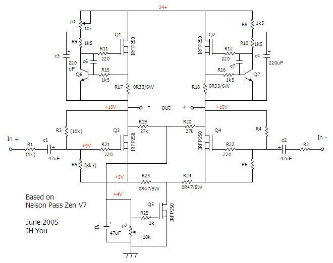

Here is my preliminary circuit.
P1 is to adjust the offset close to 0 at output.
Nelson says in the Zen V7 article: ". . . by a single ended input . . . one input is driven and the other is grounded and we see some voltage swing occur . . . and thus also on Drain of Q3 . . . variations as much as +/-3 Volts . . ."
I think that he developed F1 mainly for tube preamp users, i.e. for the single ended pre. Then, to him, the voltage of variations of +/-3V must have been 😱
For the same reason, I would like to have R23 and R24. This is to make an ac ground at the drain of Q5. If it works as I think, the dc voltage across the bottom ccs could be getting stable.
I wish to hear from you about all kind of comments.
Any give-away-! comment would be appreciated.
Phew . . . I am sweating too much . . .
I need more beer . . .
I will try this circuit until I get the efficient single unit drive . . .
Regards
jH

JH , do not forget to use smaller input capacitor remember .... you do not want the amp to work too much hard
And why that R1 R2 so big ....
