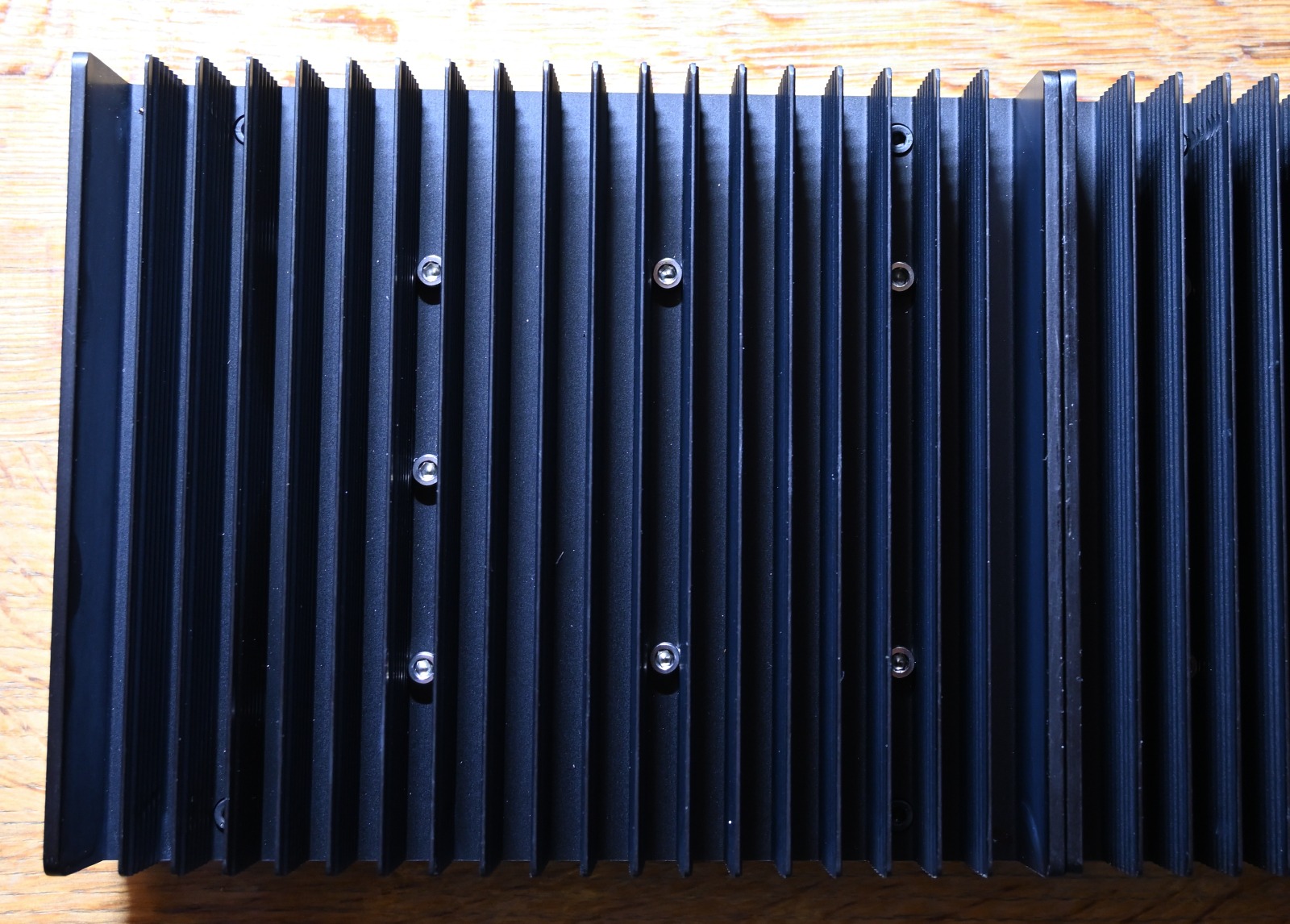

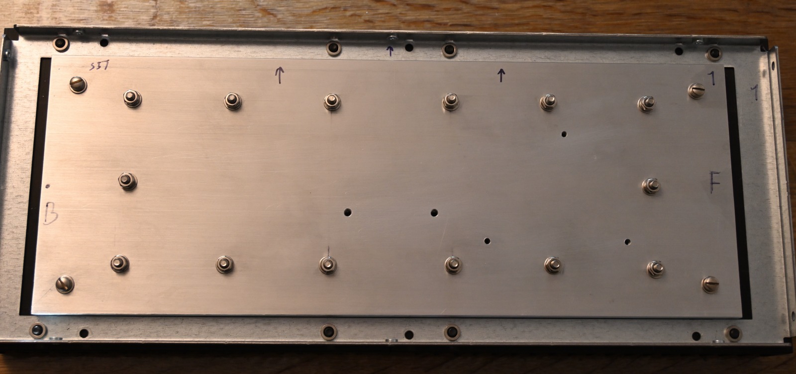

A couple of pictures after first panel has been attached to heatsinks. Surfaces were degreased and then a thin layer of heat paste was applied.

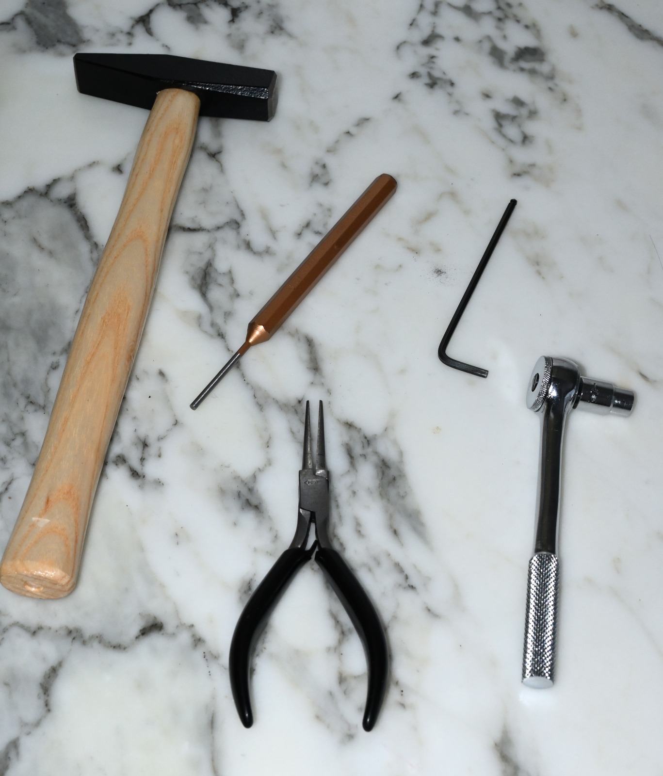

Also a picture of the tools used for this process!
The hammer and punch tool was to give the hex screws a small "punch" to get it "though" the ribs. The space between ribs decreases from top to bottom. If holes are centered perfect a very small "knock" was enough. It was not necessary to change size of hammer for holes which were not 100% centered! I used this easy method instead of file the screw heads a bit. It was a lot easier than expected. The plier used as pincet to place the screws and wrench and hex-key to fasten the screws. Think I understand why through holes are necessary.

I hope so. The other four screws in the corners are just to positioning the panel which helped a lot. M4 threads was made in heatsink for this purpose. Then I hope for good thermal contact made by the "through holes" screws so bias can be cranked up at least 0.5A more than "expected"
Now all four panels has been attached to the heatsinks. Next step is stuffing the PCB with components and solder them.

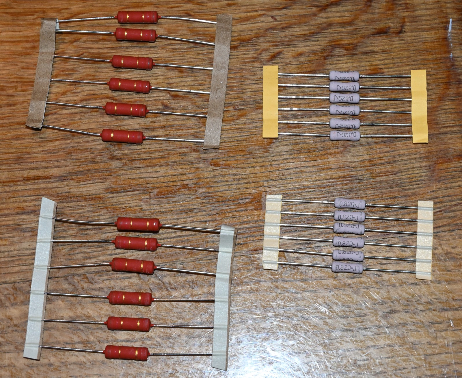

I have looked at the two schematics and also looked into the kit components. I remember that the large output cap and source resistors were not part of kit. Source resistors should be 10 x 1R 3W MOX pr. channel. I am going to order these.
I found some power resistors in the kit which "smells" a little bit like source resistors. Some 1.2R 3W and some 0.82R 2W ?
If I mix them there could be enough for two channels (20 are needed).......?

I found this:
"Following Ben Mah's findings, about 3:2 Mu resistors ratio, and counting that same applies to 2SK2087C, be it combined with puck or IRFP, that would be 3*1R2/3W MOX at Mu MOS Source side, and 3*0R82/3W MOX at SIT side
so, 400mR + 273mR
resulting in sum of 673mR, pretty close to desired sum of 666mR
clearer:
R5,7,9 being 1R2/3W MOX
R4,6,8 being 0R82/3W MOX"
