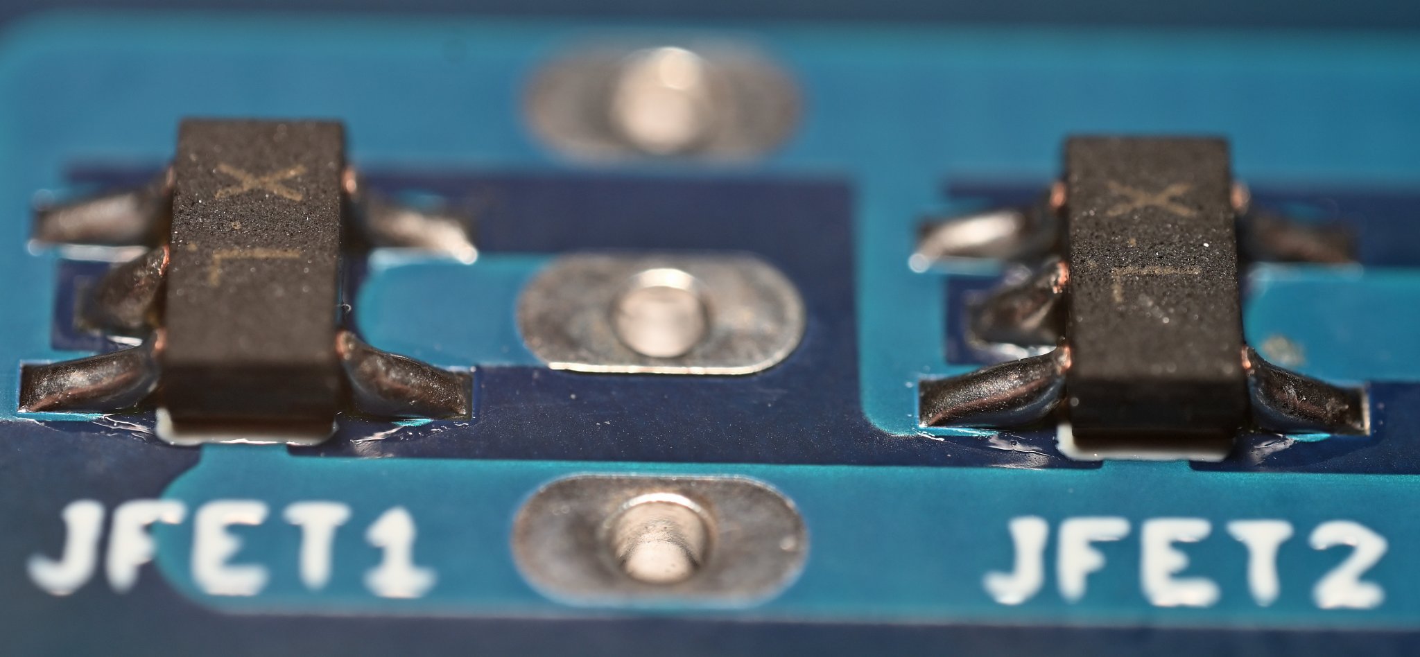

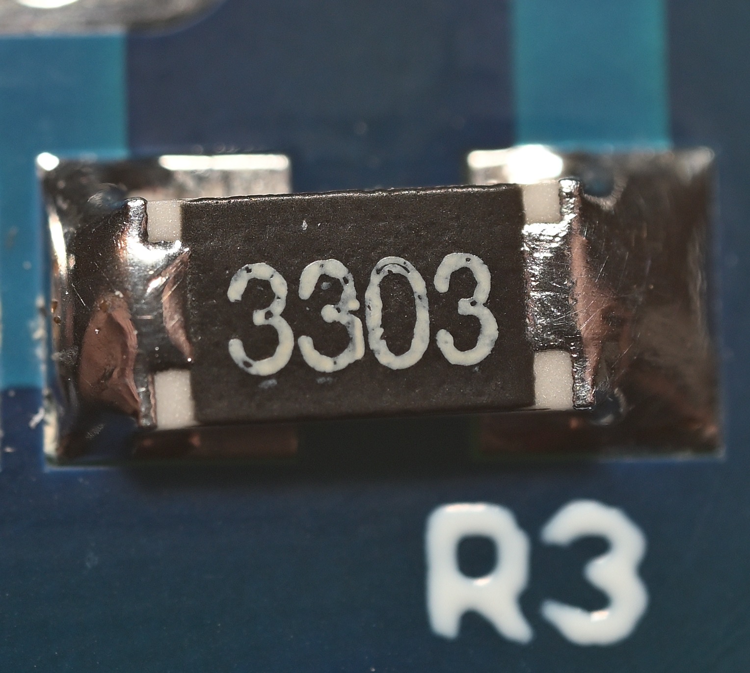

Lazy Singing Bush mono block build using THF51s
Not 100% perfect but cleaner?
The lens used has no aperture so DOF is very "slim". A "stacked setup" takes a lot of time.
Now I can read XL on top of JFETs.
Maybe sound will be "cleaner" now?

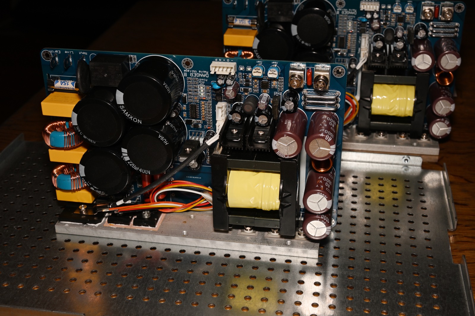

Today the two 65VDC PSUs arrived. Those where special order as 65V was not standard.
Originally the modules are 2kW but company used another transformer as I only need about 4 A. It is made for max. 10-12A. Then noise performance and efficiency will be better.
Here is what the company wrote after they asked for what the usage was for (fine service):
"I see now, if you are only gonna use around 4A (10A peak or so) we can optimize the transformer and the overall design for a lower current which will increase the efficiency, reduce temperature rise and noise.
As you might know, any SMPS optimal operating point where the efficiency peaks and noise is lowest is around 50-60% of the rated power, in this case about 1000-1200W while at extreme low and extreme high, the efficiency suffers. At low power, there are idle or quiescent losses which are proportional with the maximum power, usually 1-2% of the max power, and by reducing the max power will get the optimal operating point closer with your actual usage scenario.
The SMPS will be the same, but to optimize these parameters we can set the maximum current to approx. 12-14A focusing on efficiency increase and noise reduction and if your load is just 4A it can work with minimum cooling requirements."
What is pure luck is that the 6 x M4 mounting threads in the heatsink has spacing of 10mm multiplums so in the be mounted easy on base plate which is my plan. The heatsink is not connected to Gnd internally on PSU which would cause troubles as I need -65V so PSU Gnd will be -V. There is a resistor in serie with a very small cap to protect the devices against static charges.

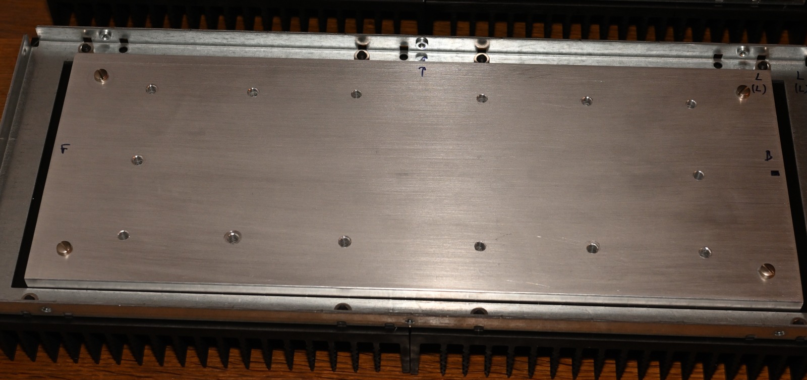

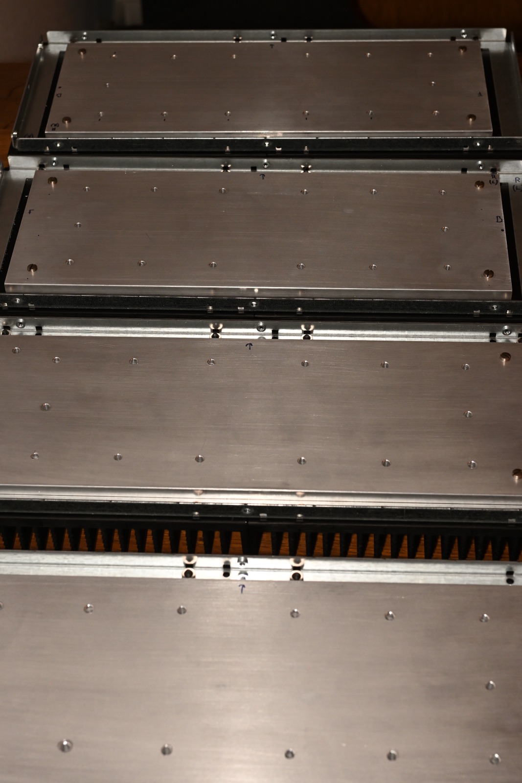

A small update for the "lazy project".
"Through holes" has been drilled in panels and heatsinks.
The four M4 screws in the corners are just to "hold" the panels in place which I think helps a lot. M4 threads are cut in heatsinks for this purpose.
Next step is to drill holes and cut threads for PCBs and THF-51s.
I will make two identical mono blocks. I will not mirror........
I have marked everything so same panel and sinks belongs to each other. When holes are drilled free hand etc. they are not placed 100% same place so panel and sinks belongs together as a set and also the frame........just in case.....
I need to read the "Lazy thread" before I mount components so I am sure I do it right. There are many yellow MKTs 🙂 ......and a few red ones 🙂
I also need to know the melting point of aluminium before I crank up the bias for the final adjustments when everything are finished........
Then we can go for melting point minus 100C or so.......better safe than sorry......
