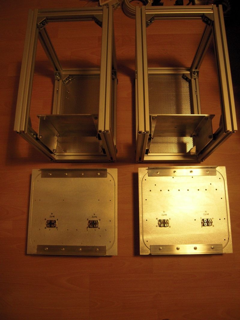

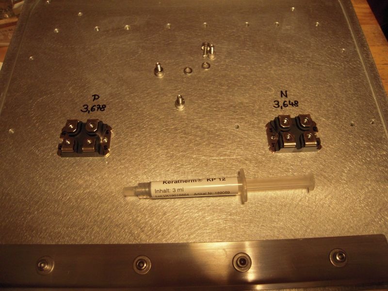

when I built my monoblocks with IXYS- Mosfets, I used the 1/3 to 2/3-rule for the height of the Mosfets on the heatsink.
Horizontally - or from left to right- I made it 1/4 - 2/4 (betweeen the 2 Mosfets) - 1/4 (to the edge of the heatsink).
But however you want to do it - as long as it stays in the expected thermal region - all is good.

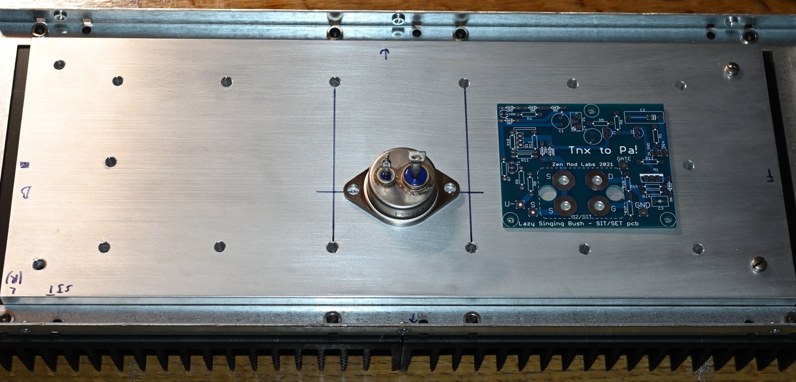

I have marked the holes for SIT and PCB on both SIT panels and I am ready to drill / cut threads........
I just have to remember not to drill 3mm / 4mm but a little smaller diameter....... for the M3 / M4 threads.
It would be a bad mistake to make.......

Yes, I have those numbers in my table.
I have had success drilling 0.1mm less....so 2.4 and 3.2 for aluminium and when it is drilled free hand then holes tend to be just a little bit larger than when done using a bench drill.
