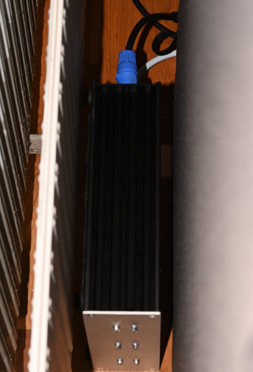

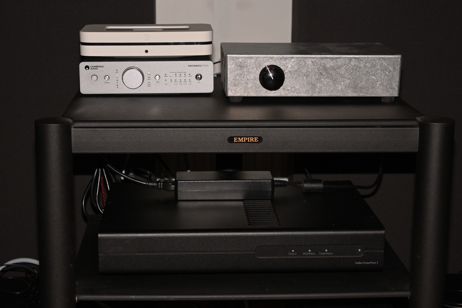

I experimented with different pre-amps (Starving Student II, BA3-pre, B1 Korg).
Funny enough B1 Korg was the best sounding combination. BA3-pre the worst (adjusted to min. distortion).
When I turn up the volumen using B1 it feels as "potent" as BA3-pre but those are very different amps. I remember from MoFo that also there the Korg was the preferred pre-amp.
The last faint buzz from SMPS cases after damping with bitumen disappeared when I also placed the cases behind the "sound panels" as picture shows (SMPS's generates very little heat so they can take to be a bit "isolated").
Now when a string fades out......it fades out in total "darkness" and not into a faint buzz. Very nice.......
No electrical noise from speakers either.
Think I have a very nice implementation of B1 Korg. It is the amp in "full alu jacket" on picture. Internal damped with bitumen. It is "non-microphonic". Also some extra SMPS filtering in the box. The final voltage for Korg is still correct.
A very nice listening experience. I played many kinds of music. Stereo imaging very good. Good depth. Also I remembered to reverse speaker phase on power amps when switching to Korg.

In the meantime I have more listening impression using B1 Korg with "Lazy Bush".
Everything that could sound just a little bit harsh before (e.g. with VFET kit amp connected directly to my DAC in preamp mode) sounds with no trace of "harshness". A good example is this harpsicord CD:

Yes, I am very happy with my setup 🙂
I am surprised how loud B1K can drive the "Lazy Bush".
My setup is very silent. I smile every time I read threads with people have various hum/buzz problems 🙂
I can't hear any trace of that even with ear very close to speaker units 😎
A very "black" background. I am sure that contributes to the excellent room definition and transparency of speakers.
